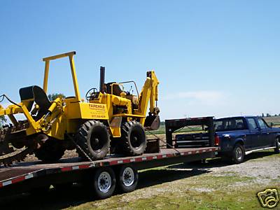

We have a trencher that wieghts about the same & we put it on a gooseneck on a truck with dual rear wheels and it is all the truck needs on it. I have scaled the truck and trailer and I am able to keep it legal, but I do have to have a CDL and I would never want to take it 60miles from home, as most of the time it is within 15 miles or less under a couple it just get drove. I prefer to put this load on the dump truck with the tag trailer and no load in the bed of the dump. This is also the reason I am looking for a bigger pickup?or medium duty. The more I learn and the older I get the less chances I am willing to take.
Most of the local tracks around here have tracked bobcats and excavator's

Also, no matter what you do, your truck will always have the factory ratings. Even with your upgrades, all the DOT would care about is the factory tratings of the truck and the fact that you are way over.
Exactly! You could spend $500,000 and mod it to haul 50,000 lbs and they still go by whats in the door jamb.....
