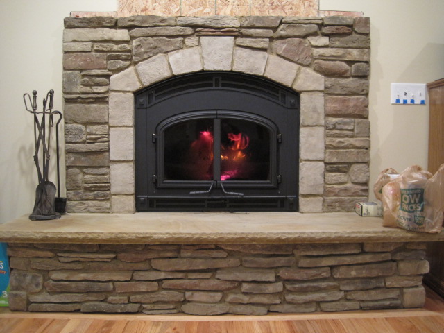

Andy,
At first when you said the stone weighed 4000 pounds, I was a little skeptical. However, I measured the size of our sandstone hearth stone that weighs 400+ lbs. Our stone is 7 1/2 feet long, 2 feet deep, and 2 1/2 inches thick. That makes the surface area of your stone 5 times larger than our hearth stone and 8 times the volume and weight (assuming our stone has a similar density as yours). So 4000 lbs sounds like a good number. We positioned our stone on the fireplace using 4 people. So all you need is 32 people and you should be all set to move your stone :laughing:.
We moved our stone on top of two pallets in the back of our truck without any issues.
Lots of people made suggestions in my thread about how to get the stone out of my pickup truck. I ended up just lifting it out of the truck bed with my FEL and a couple straps.
attachment.php
Your stone is twice as long (15' vs 7 1/2') as our stone. However your stone is also twice as thick (4" vs 2 1/2") and over twice as wide (5' vs 2') as our stone which should help yours to resist cracking. I'm going to guess that if you take reasonable precautions, you should be able to move your stone lying flat. The sturdier the vehicle you use to move the stone, the better off you will be. My biggest concern would be putting the stone in a lightweight trailer that flexes a bunch. If you put the stone on a fairly rigid vehicle, I'm guessing you would be fine if you placed the stone on four pallets with some carpet scraps between the pallets and stone. The pallets might absorb some of the vehicle flex for you. For safety, placing one or two straps snug but not extremely tight would keep the stone in place on the vehicle.
Good luck with the move and please take some pictures!
Obed
