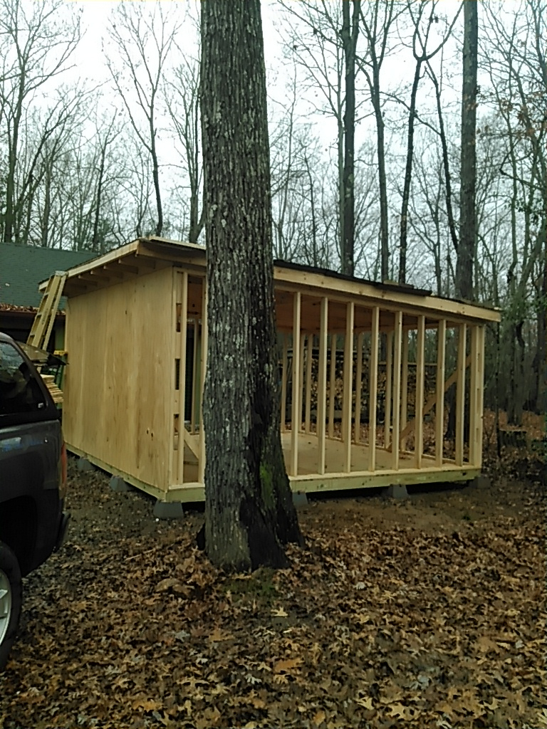

I want to move my 12x16 shed on my land. Unfortunately I did not build it with skids under it. I’m debating on ways to put skids under it so I can drag it.
I also need to remove a back lean-to shed from it first.

If it has a wooden floor, cut square holes in the floor for the jacks, lay in some pavers for footings for the jacks, install cross beams, and lift it up to slide skids under it. Repair the holes after the skids are installed and the jacks removed. Reuse the pavers in the garden.

I have moved a couple of buildings that did not have skids, the smaller ones I dragged them on my trailer anyway, but the ones that were wider than my trailer I jacked up and backed the trailer under them. I have not tried it but that might be a good time to add the skids.

Maybe I’ll remove some flooring and pull skids under it, then can fasten to the skids. The building has blocks under to level it.
