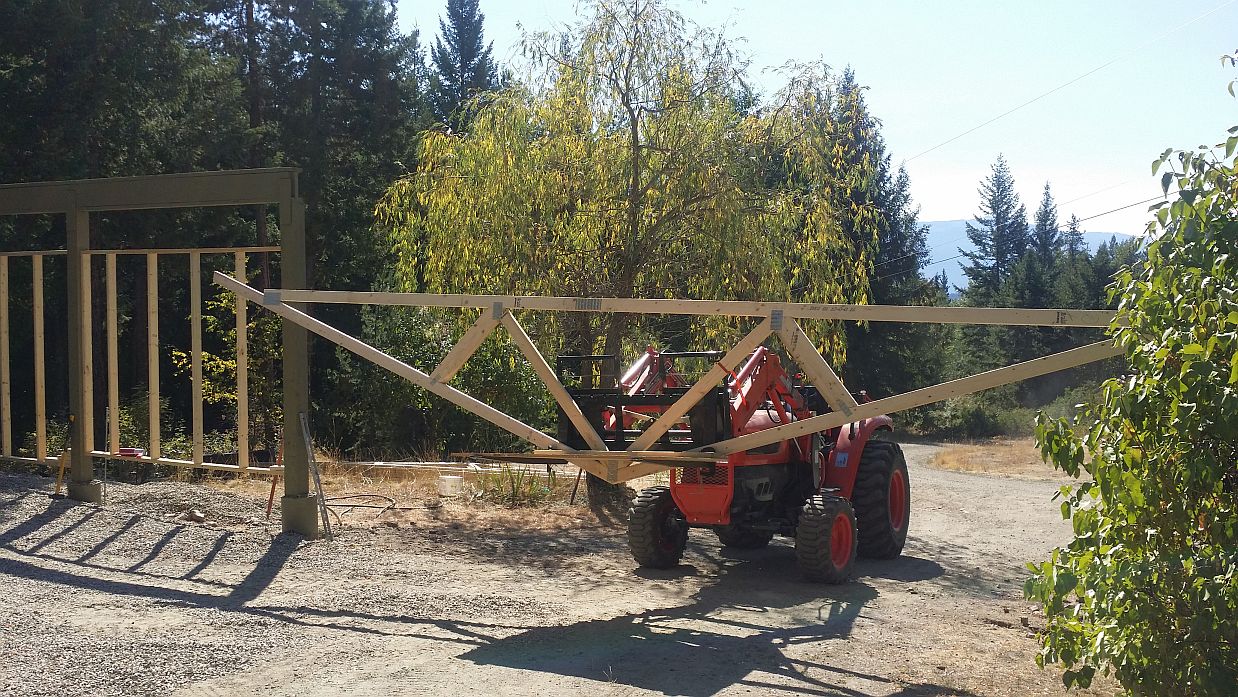

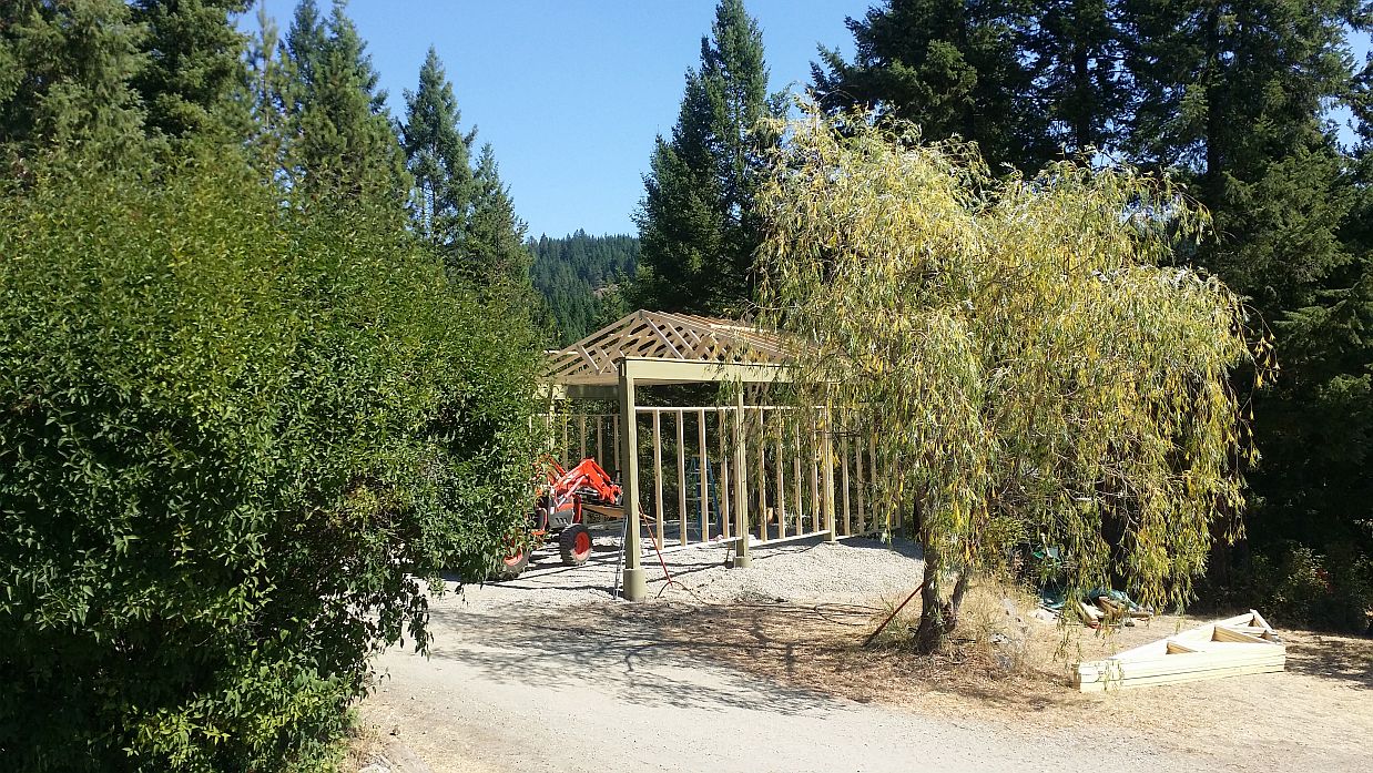

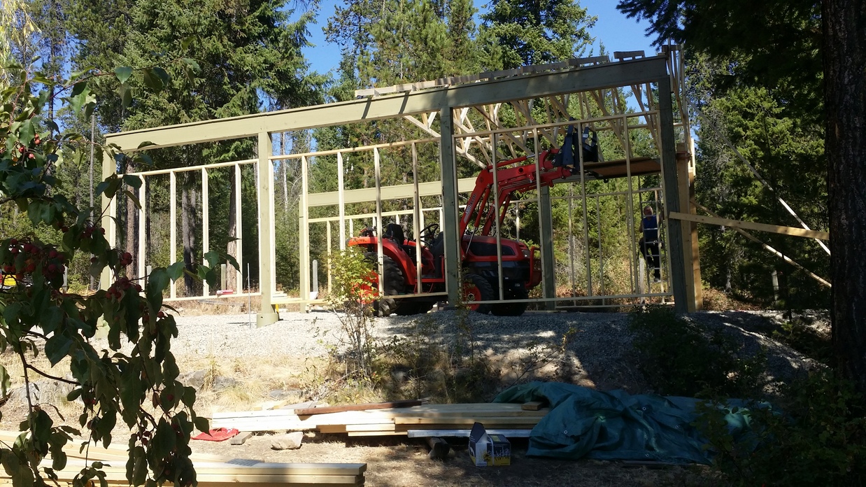

I put a sheet of 3/4" plywood on my forks as a platform. Then set each truss inverted between the forks and set it upside down on the beams. Then I could climb up to the platform and rotate the truss to the correct position while a friend nailed it in place.
