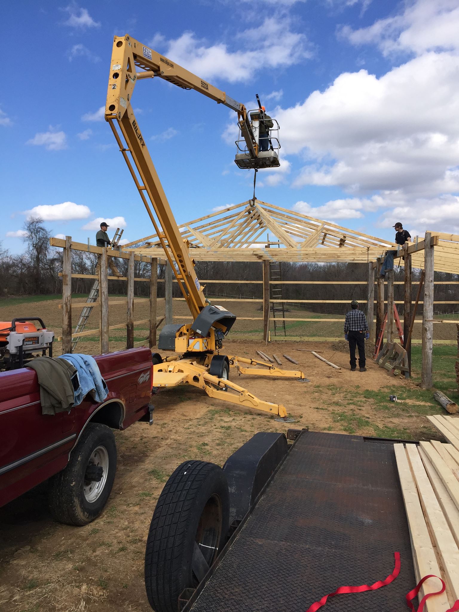

A friend of mine used a "material lift" which is a manual forklift with outriggers, it's $75 a day to rent and will lift 24' high... that's what I'm going to use, much easier than making something and will just be a weekend project to pretty cheap...

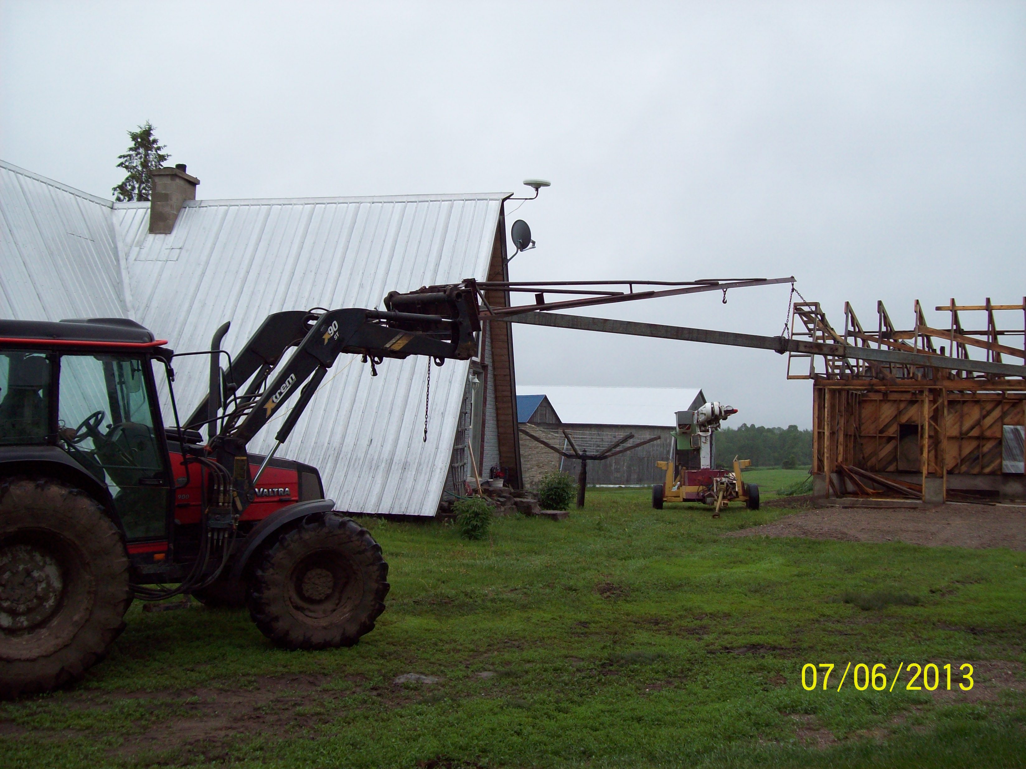

we bolted a pipe, (square tube would work fine) to the bucket of a small farm tractor and ran two cables to each upper corner of the bucket and put a bit of tension on them, the pipe had a loop welded to the end on the under side, and we put sizzer trusse up on a 40 wide building years ago, we left par of the end wall open
seem like the beam was about 16 foot long at the most, used the loader lift and the bucket cural , my friend ran the tractor I was up in the rafters nailing on spaces, and there was some one to hook the truss on the end of the boom,
nearly just like this web site shows, truss boom | N-News a little different idea but much the same, http://forestryforum.com/board/index.php?topic=67789.0

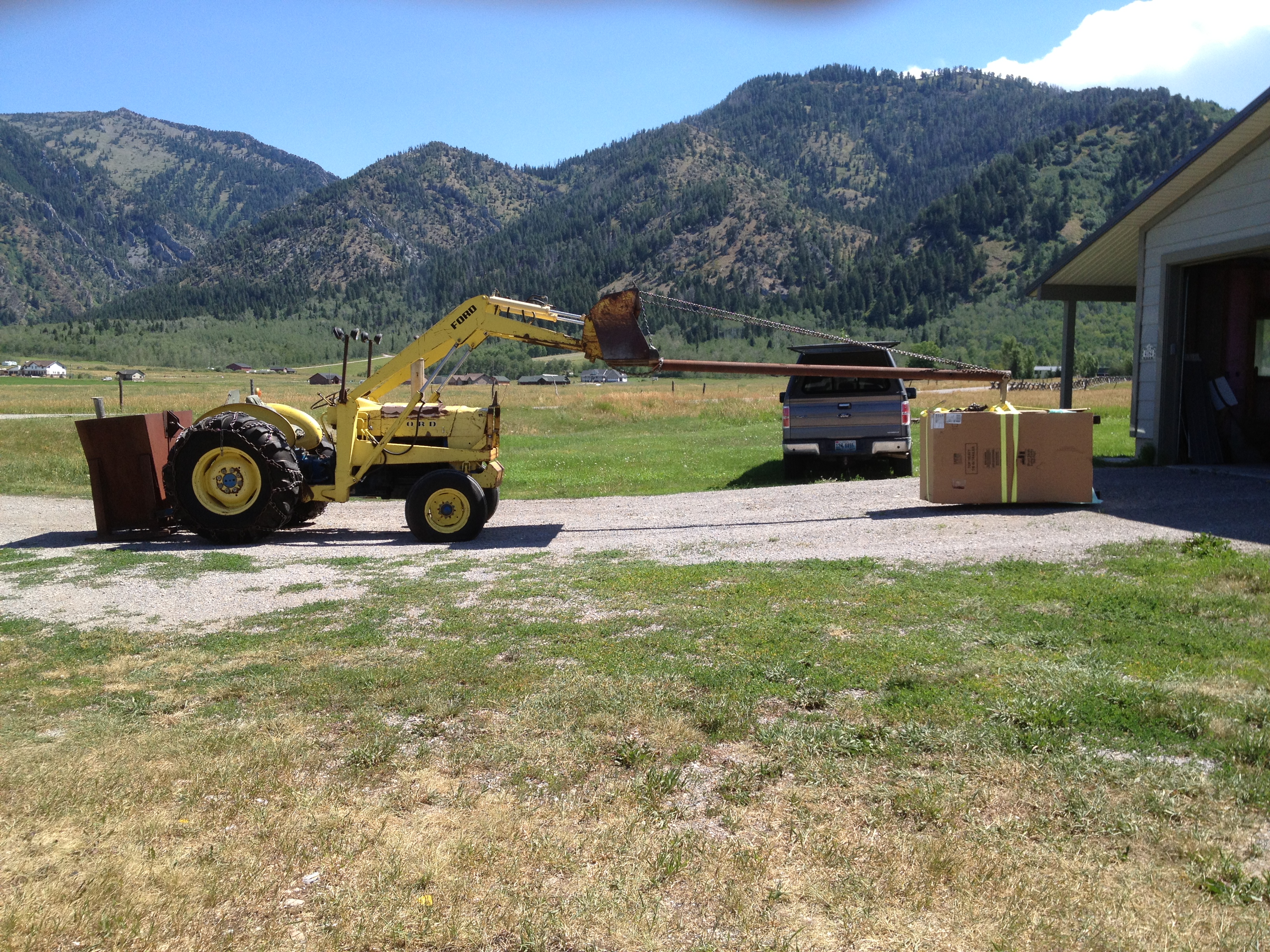

How about something like this. That is a 600lb 36ft steel beam, gives an idea of the dimensions of the boom.

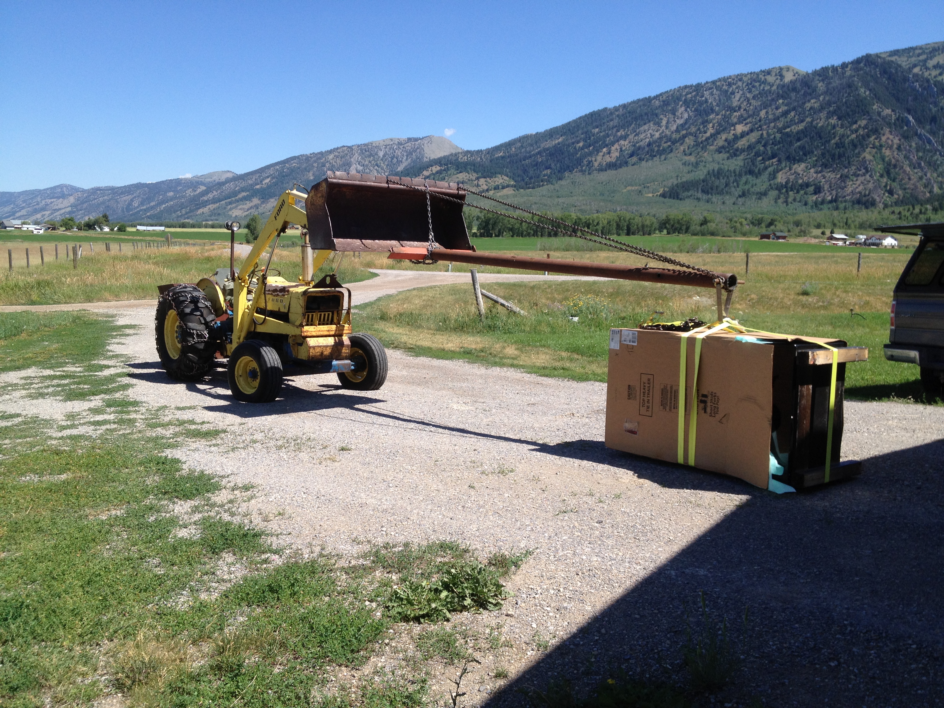

This is how I did it on my horse barn in 2016 and I raised them when I built my shop in 2010. It works well, costs maybe $200 for the day, you can set roof purlins on the end trusses real easy with it and there is always a tree limb somewhere that needs a lift to be able to cut it.
