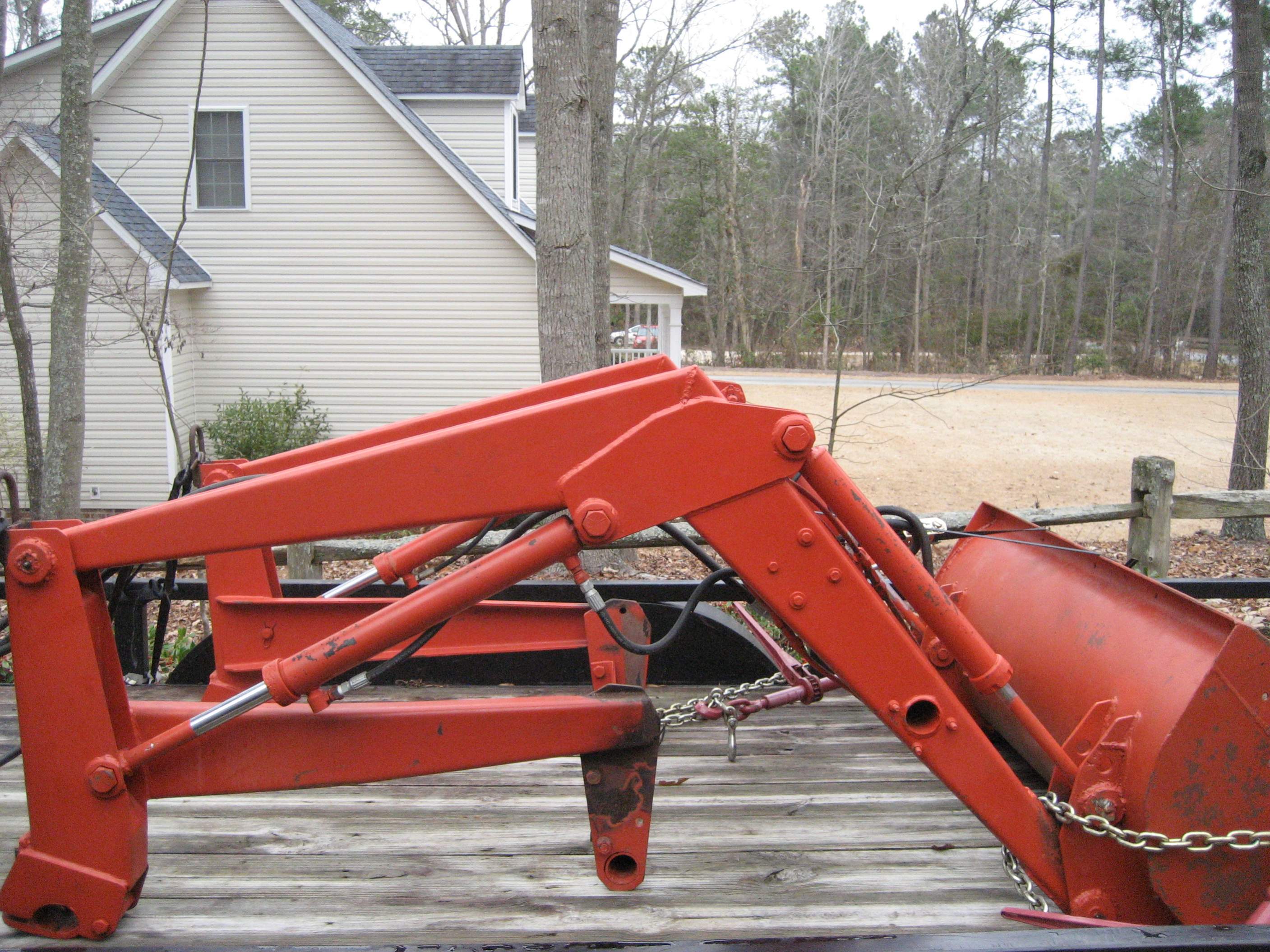

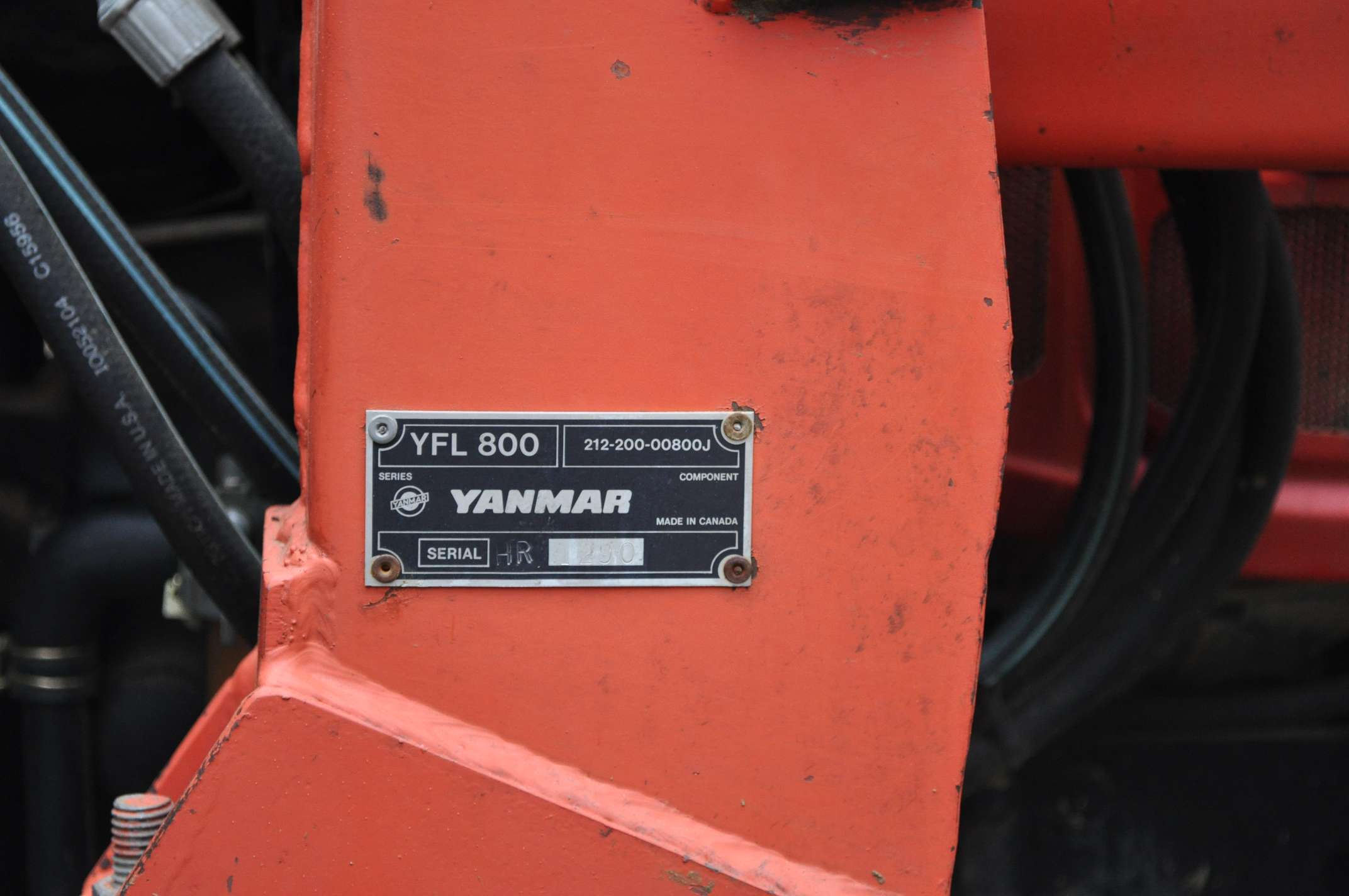

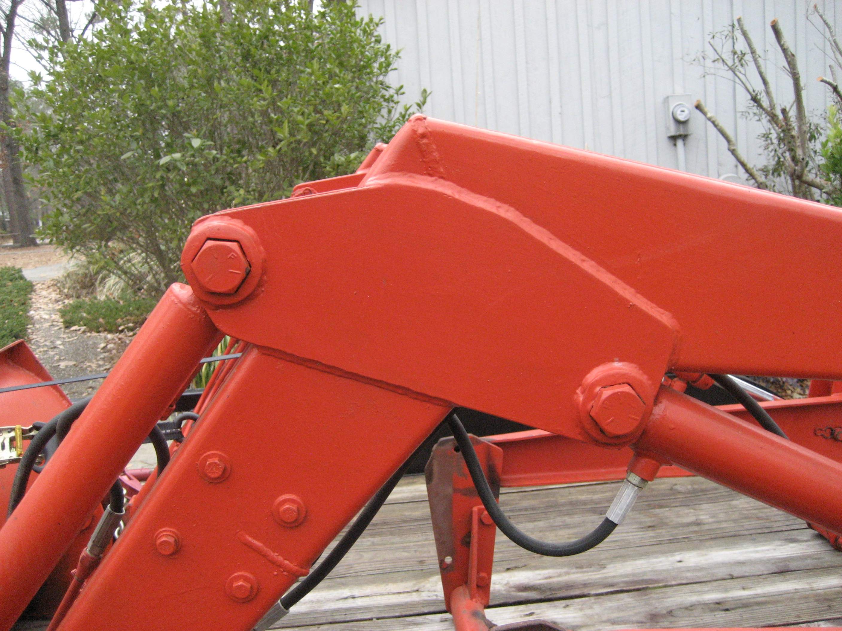

Hey guys, I bought a fel this weekend and now trying to put together all the info I can on it. Looking at a picture this morning, I now believe they were put on a 180D (and sure others)....I am looking for model number, manufacturer, specs (length of some parts- the front part of the frame has been cut/changed and want to know what it was orginally), etc...
From all I can gather....we thought this was for a 25-30 hp tractor...but after seeing it on the 180D this morning....I am thinking it could have been on a smaller tractor.......
I have posted pics...I thought the bucket (measures 53 inches) was put on later ...but the picture I saw this morning looked to have the same bucket ....anybody that has the set up and is willing to send pics and measure a few things for me would be appreciated.
Thanks!
Scott

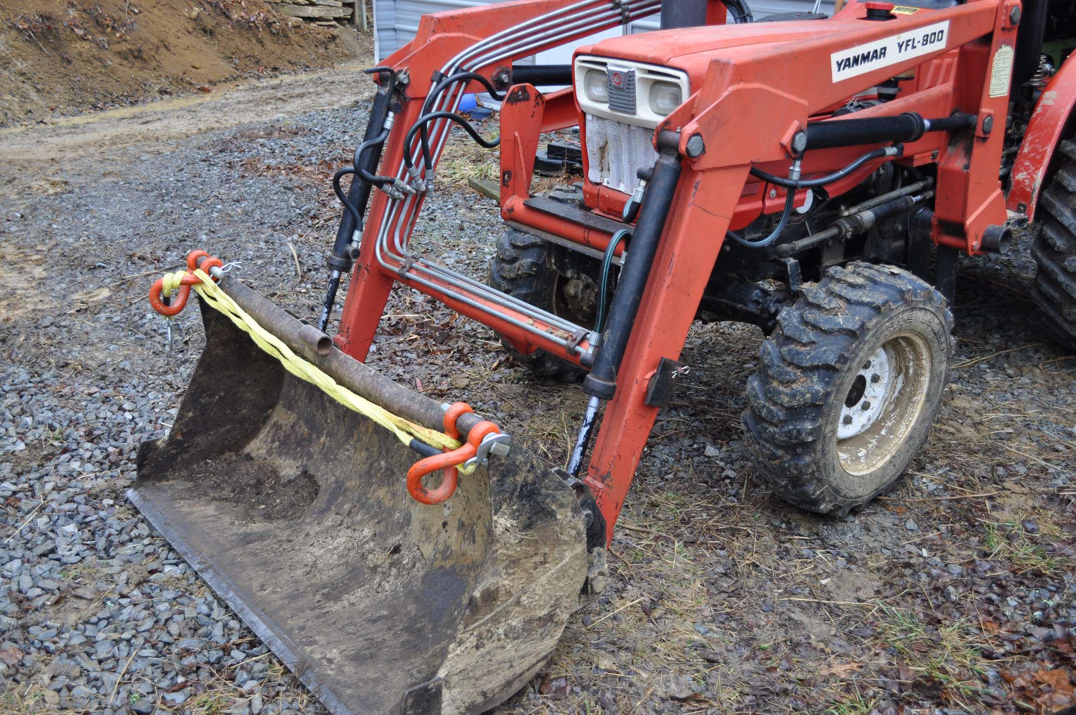

With the exception of the upper crossmember that has the two steel plates welded below it (2nd picture), it looks just like the Yanmar YFL 800 on my 226d. Mine has neither the steel plates nor the upper crossmember on it. The lower crossmember has 4 steel hydraulic lines on it that run up the left loader arm (looking at it from the front). I have a 48" bucket on mine. The curl cylinders are 40" on center. I'd suspect it is a more heavy duty version of the YFL 800.
FWIW,
Keith

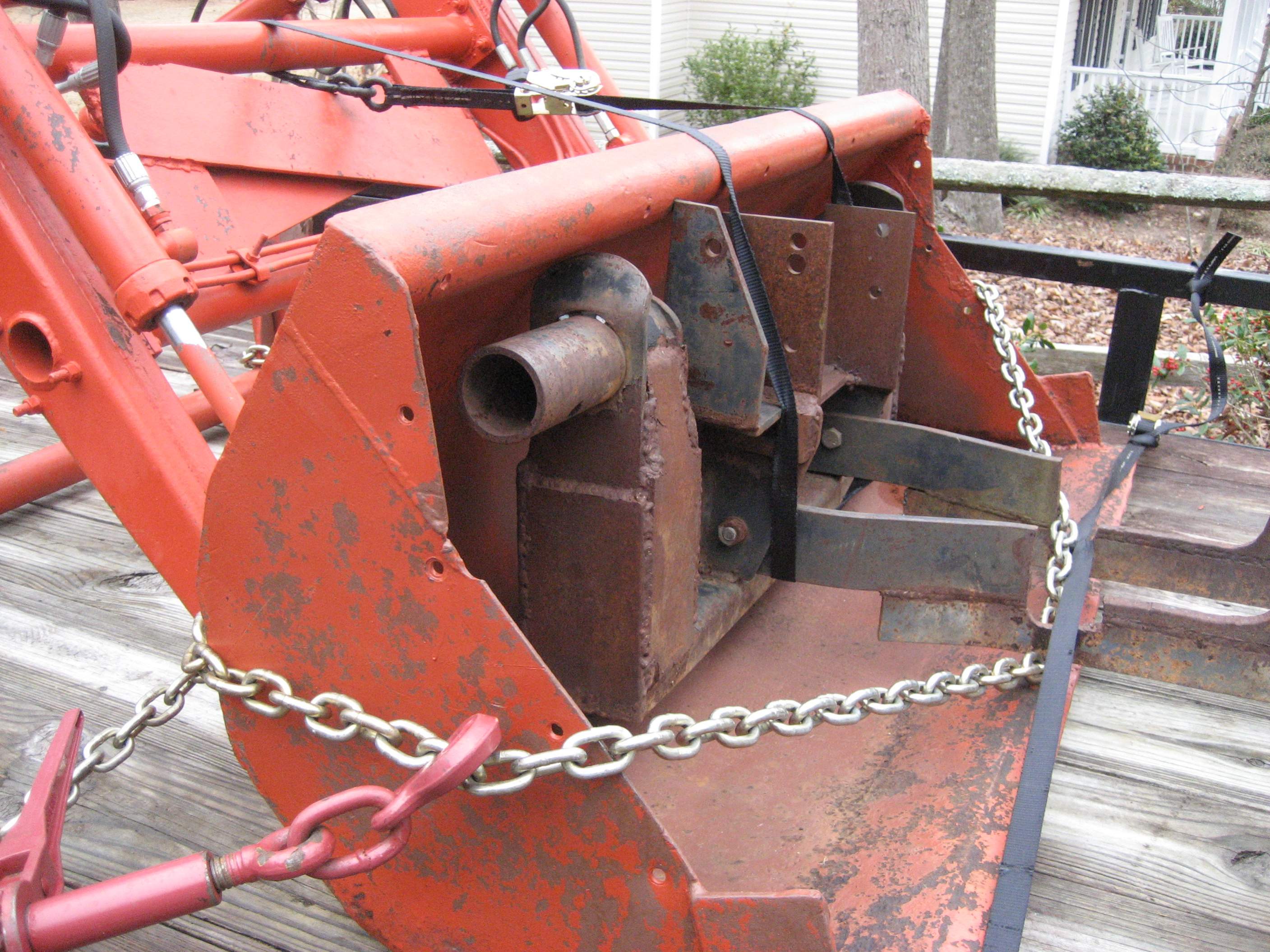

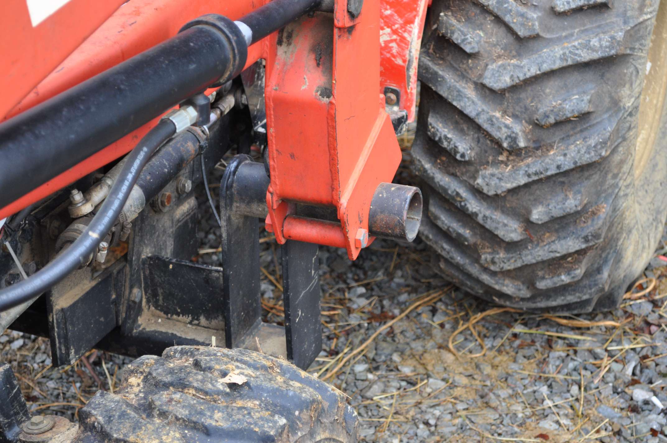

Kevin any chance you could give me a few measurements......
1) my spacing between the two main frames on top is 37"....actullay 37 " in front and about 36" in back......
2) the lower brackets on mine have been changed....moved...I am wondering what it should look like...and trying to figure if the length of the arms were cut....I will attach a picture of what I am talking about....tip to tip (front to back) how long are these lower arms??
Does your bucket look like this one?? top is curved back with a "lip"......
I am thinking this could go on several size yanmars....just trying to figure out which ones those are.
Also anyone who has a picture of who it attached to the frame (front and back) would be appreciative.
Thanks for any help you can give.
Scott

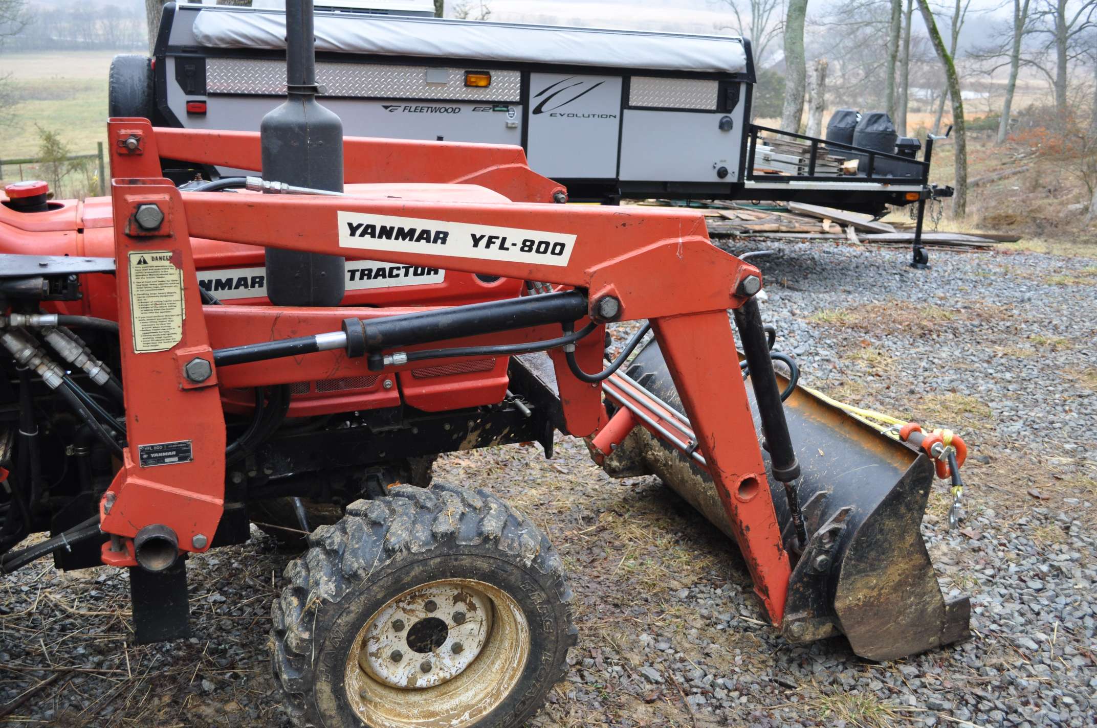

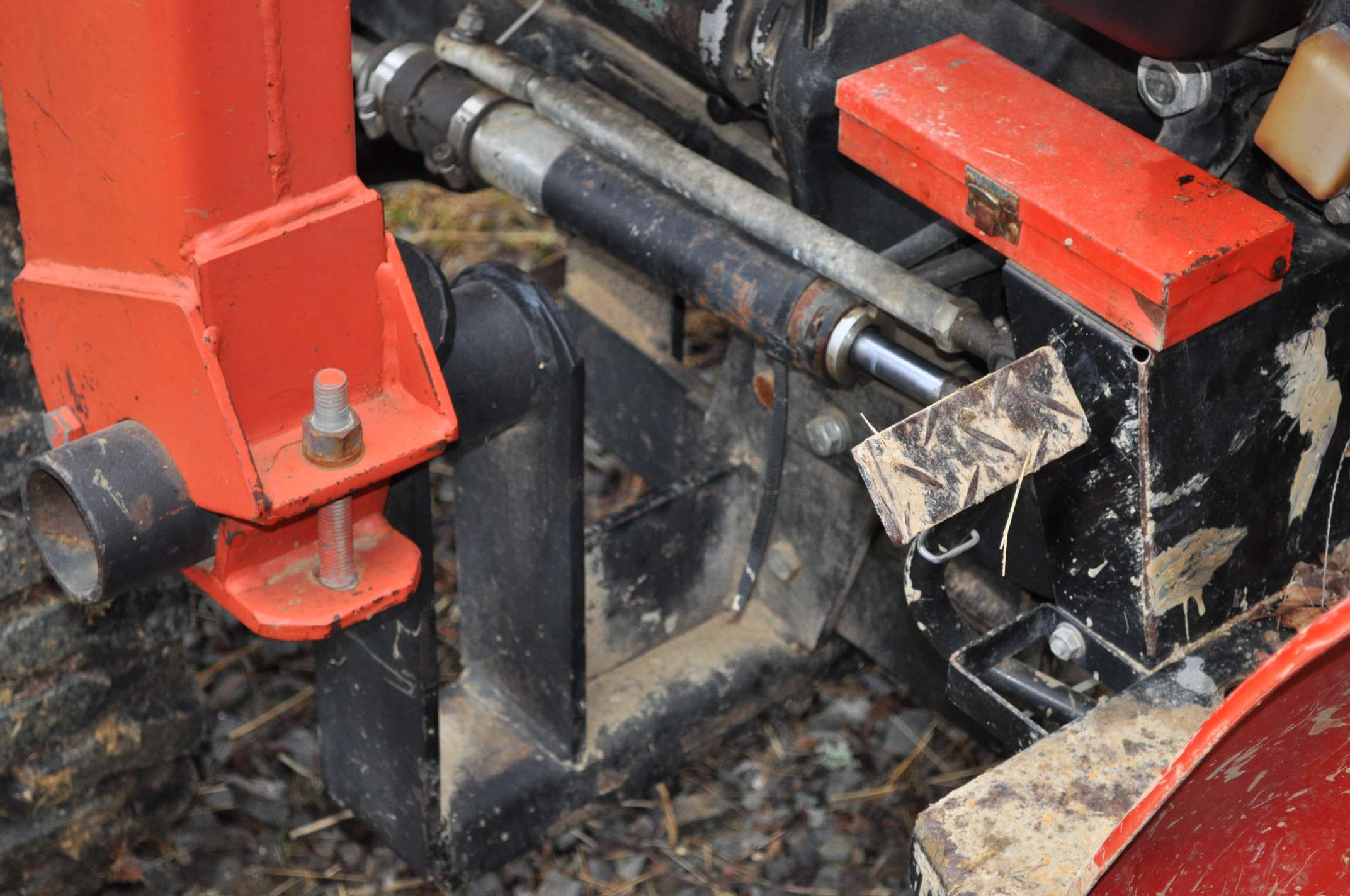

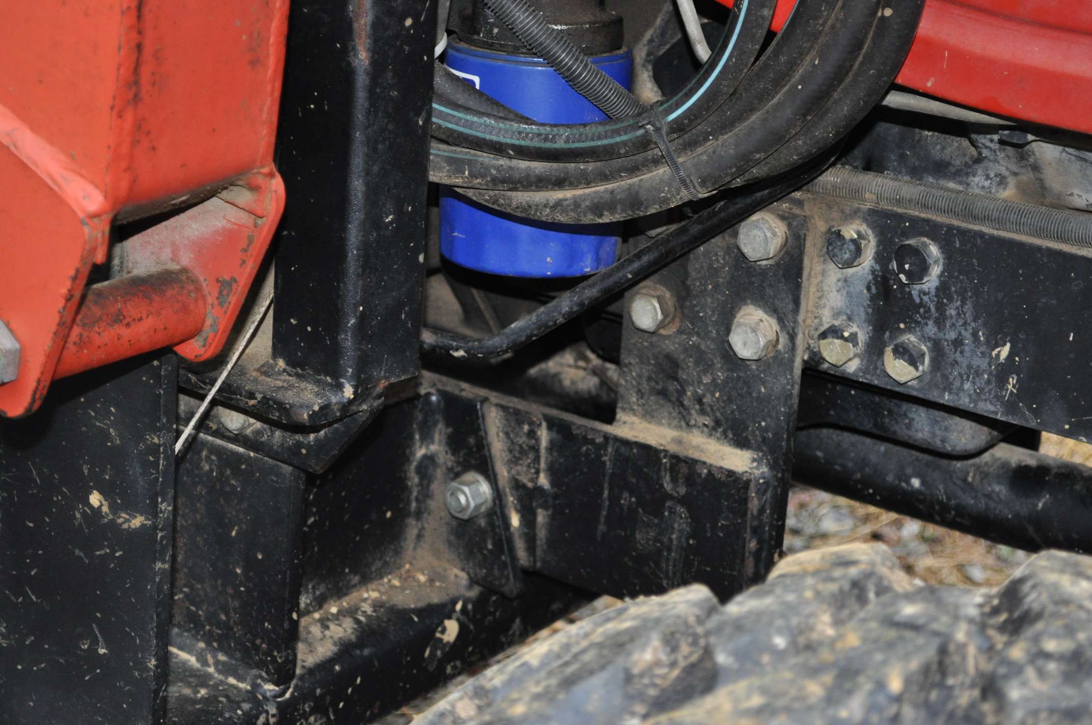

/ Need some FEL info please #6

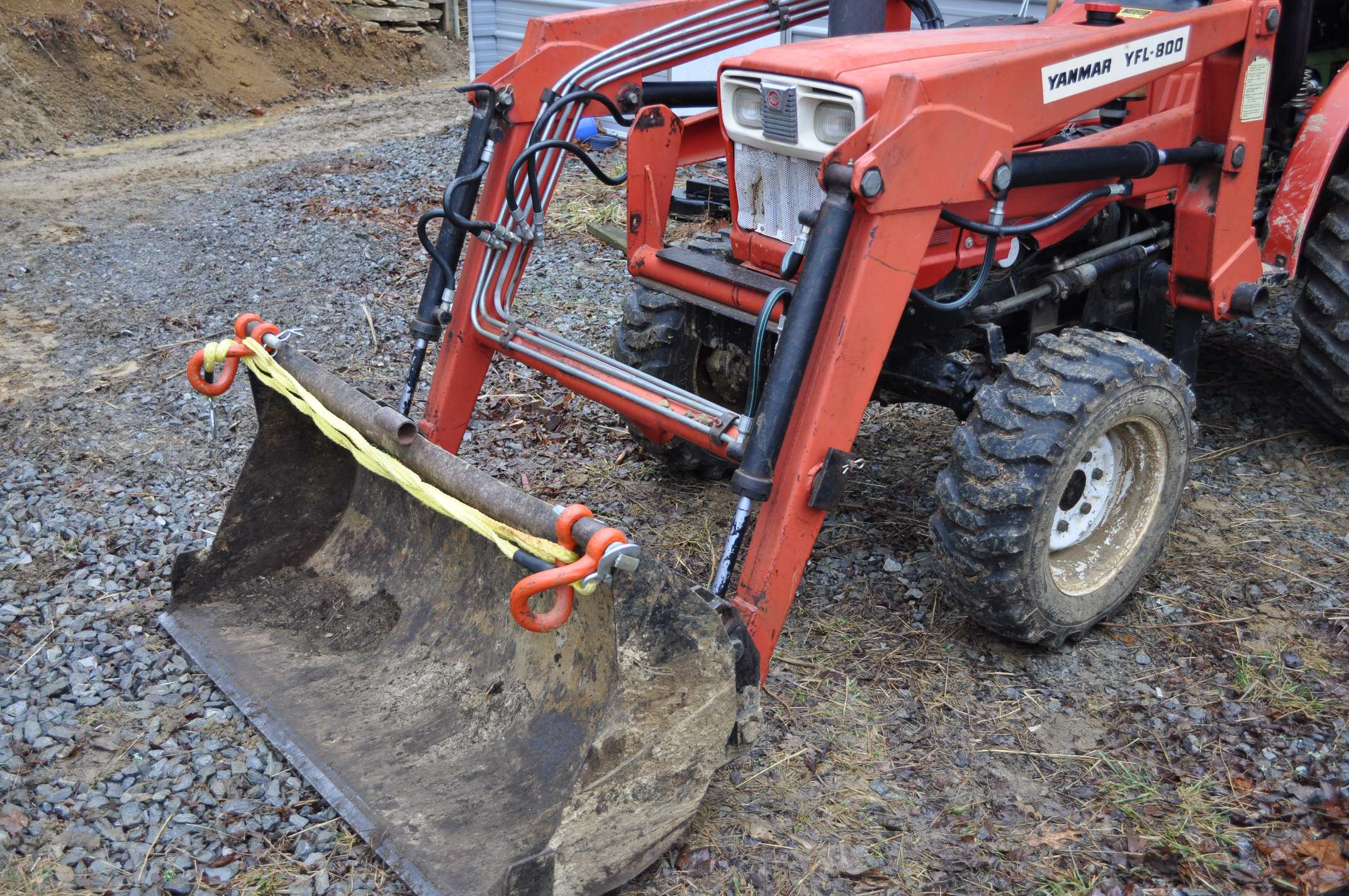

Scott,
Mine is also 37 in the front. 36 1/4 in the back. There is some wiggle room there. Mine is as wide as it can get in the back.
The lower arms...well, couldn't figure out a good way to measure it. So, from the center of the bucket pivot bolt to the center of the upper cylinder bolt is 35 1/2 inches. If the lower arms were cut/changed, yours should not be the same.
OK, I see that I measured the wrong thing. That U shaped arm is 38 1/2 inches back to front. 39 1/4 if you add in the front bracket that it is welded to.
My bucket looks pretty much the same except I have some pipes that were welded on there at some point in time (for a grapple maybe).
Hope this helps,
Keith
Keith,
Thanks!!!! This is exactly what I needed....now just need to compare the measurements.....good news from the picture is that most of everything seems to be there to work with.
Yea....I think I noticed you have the bolt holes on the side(ends) of the bucket like mine.....wonder what that was for??
Now what models does this loader fit on is the next question....
Again thanks for taking the time...hopefully I can repay the favor down the way.....
Scott
/ Need some FEL info please #8
Scott,
Glad to help.
I think you mistook dirt for bolt holes on the bucket. Mine doesn't have any.
As far as what it fits, isn't that dependent on the lower mount (that's in your bucket)? I can't guarantee that the bottom mounts are the same. I do know that this one is on a US model YM226D.
Keith

Nice original 226 with the "factory" bucket you have there! I am a purist...I like things to be original...goes back to my buying and selling small motorcyles....I use to collect early 70's minicyles...always tried to find original pieces ....carries over to these tractors....that being said my yanmar has a bushog fel.....not a deal breaker....just like original equipment when I can find it.
Thanks for the compliment. That 226 does everything I ask it to...but it isn't completely original. When I got it, the PTO was not working. Danny, from Parker Equipment, bent over backwards trying to find a 53 tooth gear to go in it but when there isn't one to be had, you just can't get one. Anyway, I replace the entire PTO with one from a JD750. It bolted right in but the input shaft was 1/4" too long. My angle grinder took care of that.
Noticed your FEL was made in Canada......
That supports what others have said about Yanmar not actually making the loaders.
Again thanks for your effort!
I'm glad to be able to help for once. I don't know a lot about tractors so it's rare that I can contribute.
Keith

Took it by a fabricator today to have him look it over...I was aware of some items that had been welded improperly where the bucket attaches....and I wanted to get it done right..the news was not good....wanted a good bit of money for what needed to be done..he found some things I had not seen.....not unfair...just alot of money.....I am going to take it to a buddy who I wheel and deal with....hoping we can work a deal that does not have as much $$$ changing hands involved.....bottom line this is not going to be a good deal for me.......I knew I was going to get educated on what to look for, what to walk away from, etc.....just did not need it to be this expensive :( It can be fixed....just will cost more than I care to spend...may have a front end loader for sale sooner than I planned......if so Smoody gets first dibs.....
Scott
You might be able to tell which loader it is by the cylinder measurements....that is, if the ID tag on the left hand side is missing or painted over. I can see one in one of the pictures posted.
Yanmar contracted to have about 3 different series of loaders made from what I heard at the time. Yours looks like the last series and it went like this according to their advertising sheet.
YM140/47 =YFL575 loader w/ 1.75"x15" lift cylinders
YM186 =YFL650 loader w/ 1.75"x13" lift cylinders
YM180 =YFL675 loader w/ 1.75"x15" lift cylinders
220/226 =YFL875 loader w/ 2.00"x16.5" lift cylinders
YM276 =YFL1075 loader w/ 2.00"x24.0" lift cylinders
YM336 =YFL1575 loader w/ 2.25"x24.0" lift cylinders
All of that series of loaders looked similar and used a single lever control. Bucket cylinders on the three smaller ones were all 1.5"x14". Larger ones used the 1.75" cylinder. The 226 bucket cylinders were 14" long, the 287 and 336 used 1.75"x20" bucket cylinders.
These were very nice loaders and stout. The cylinder packings can be tightened with a ring spanner to stop leaks. That's actually a good thing. But like any of this style they will seep some. I can scan the adv. doc. if you need.
Enjoy! rScotty
