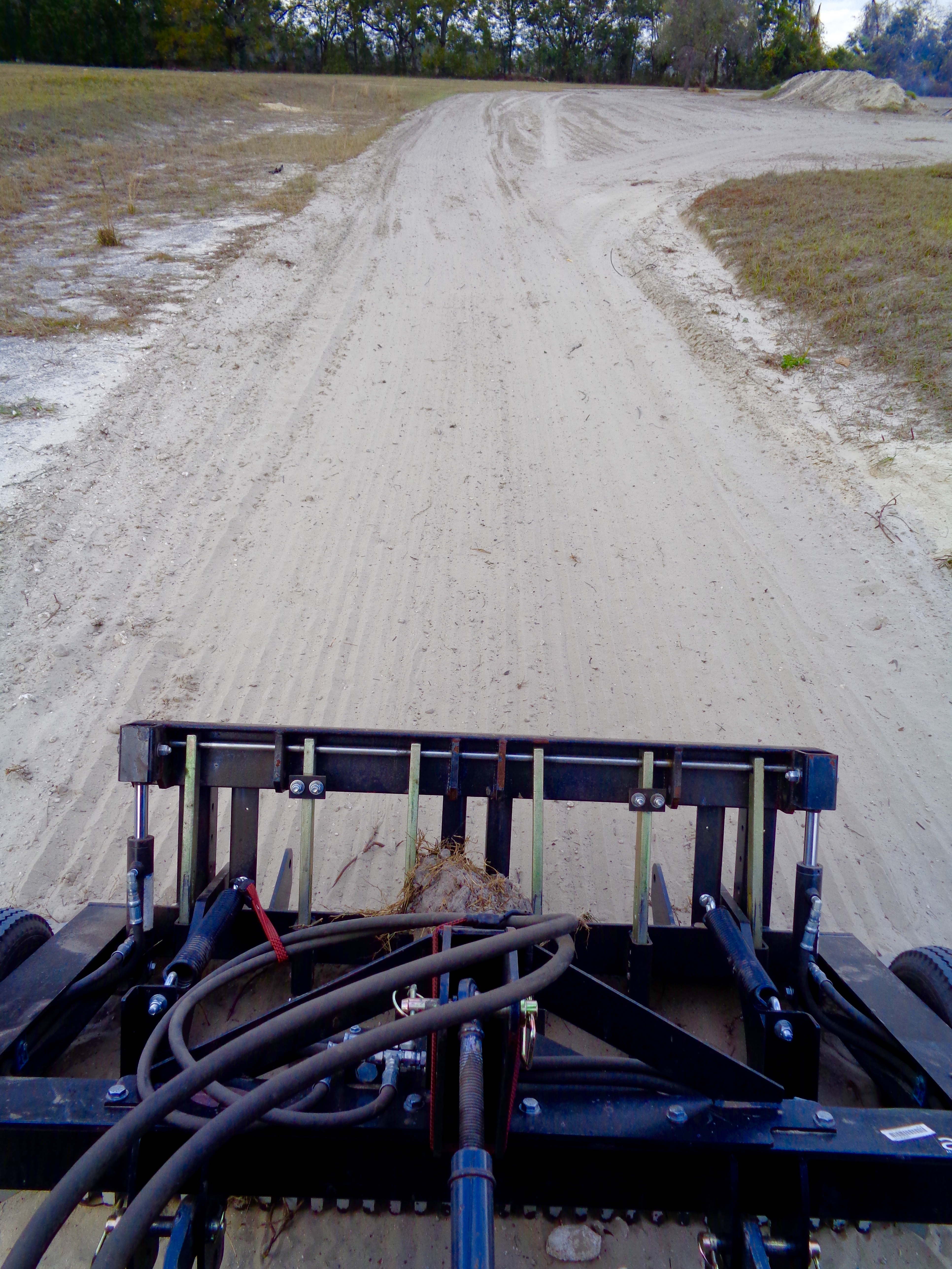

There is an existing driveway that runs through the property to where we will eventually build. The drive is approximately 2,500 feet and is in good enough shape for the pickup truck and the Jeep, but not quite ready for the trailer or a regular car.
Dirt, gravel or grass?
The premier all-in-one driveway maintenance implement is an ABI TR3 Rake. Photo #1
VIDEO: TR3 Rake - Gravel Maintenance Intro - YouTube

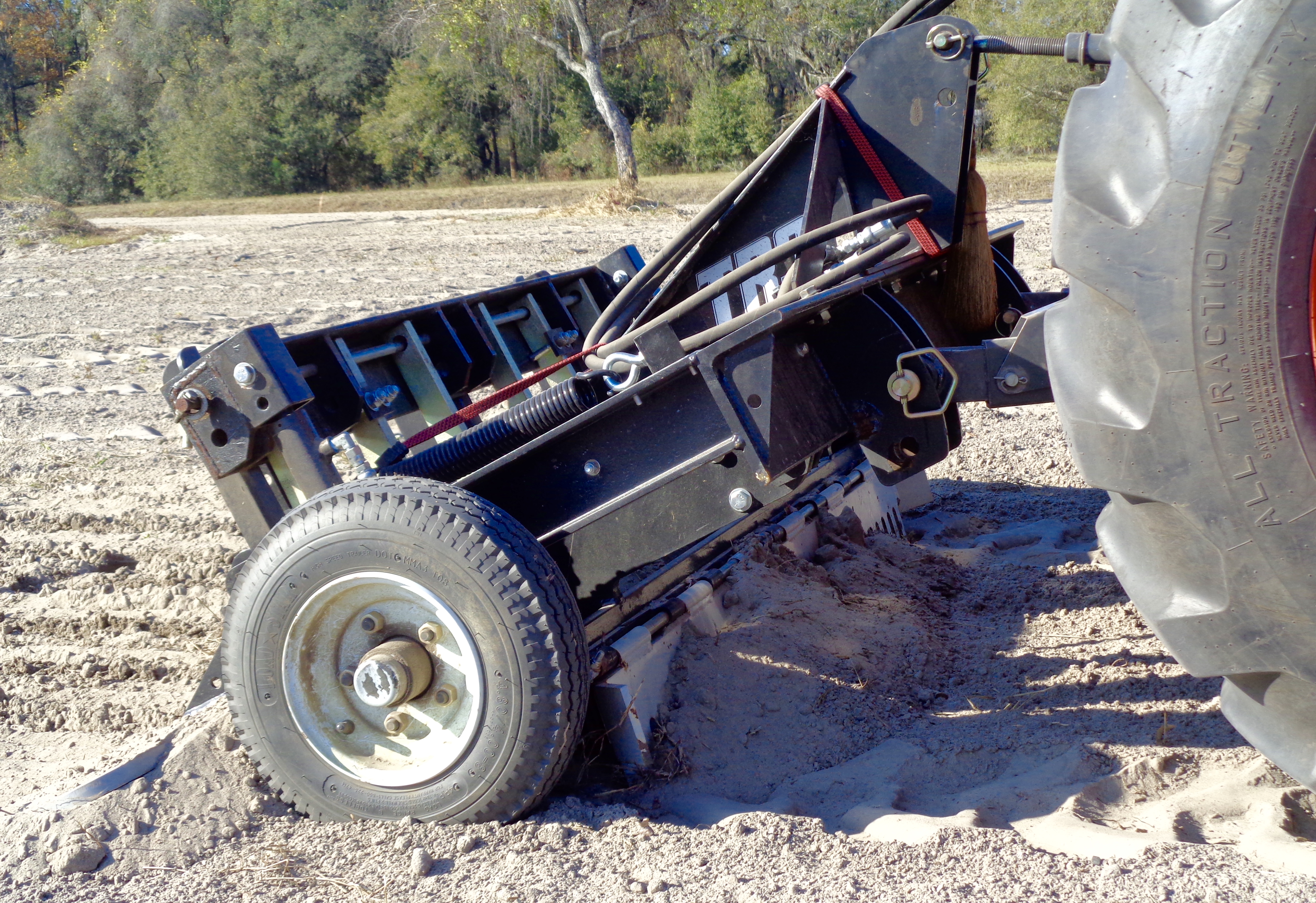

The drive is about 60% gravel, 30% dirt and 10% grass. The gravel needs a refresh but does not have many potholes or washout. The dirt portion is the area with the most slope and runoff issues and is where i'm looking to improve drainage as well as smooth out the drive. I haven't calculated the slope/grade yet, but i've driven it in 2wd without issue so not too terribly steep.
I own a Box Blade. A good road implement for eliminating potholes, but it buries gravel so you need additional gravel trucked in occasionally. Fairly long learning curve.
Both LPGS and TR3 Rake recover gravel from dirt, so gravel replenishment is a infrequent expense.
Short learning curves.

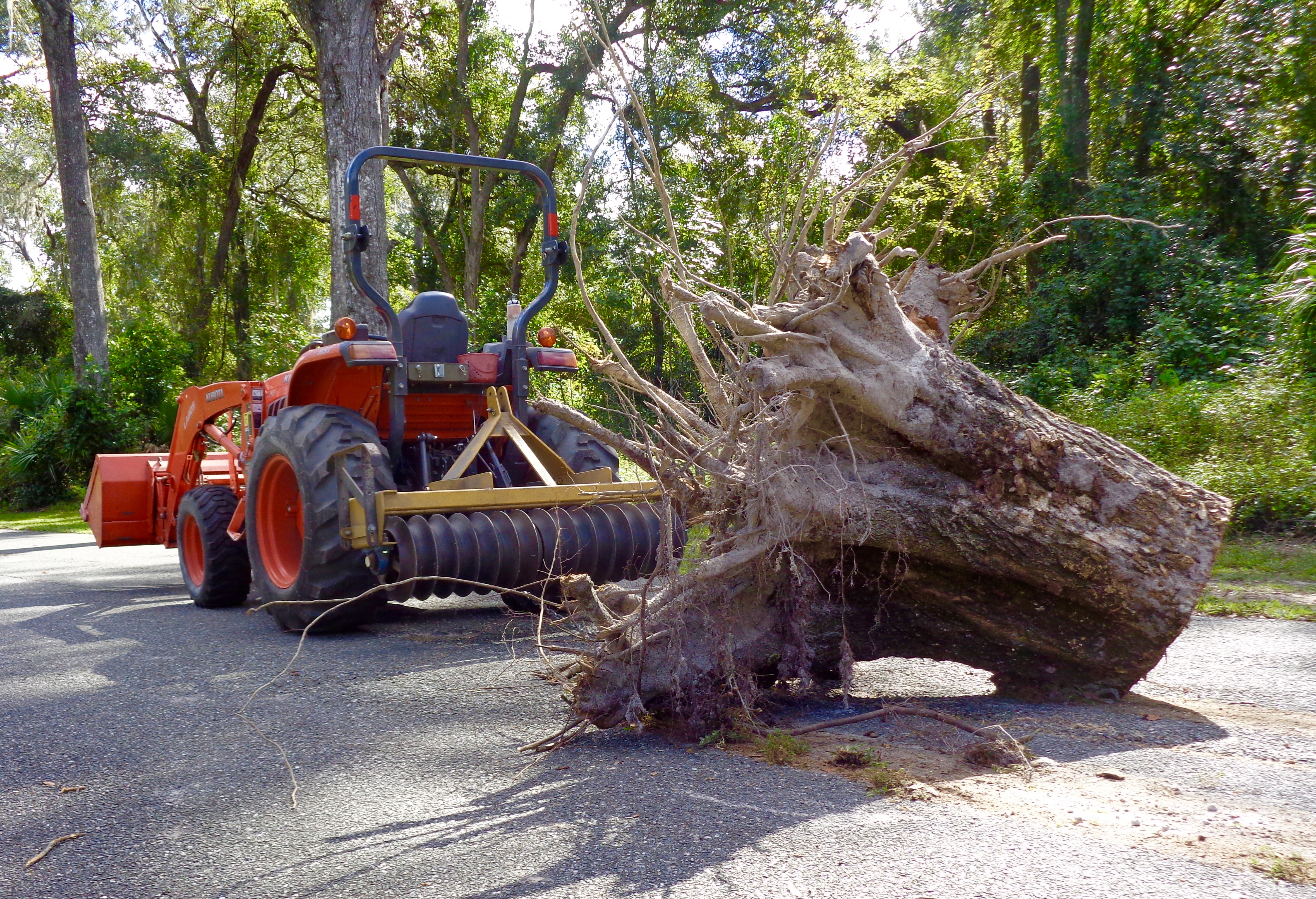

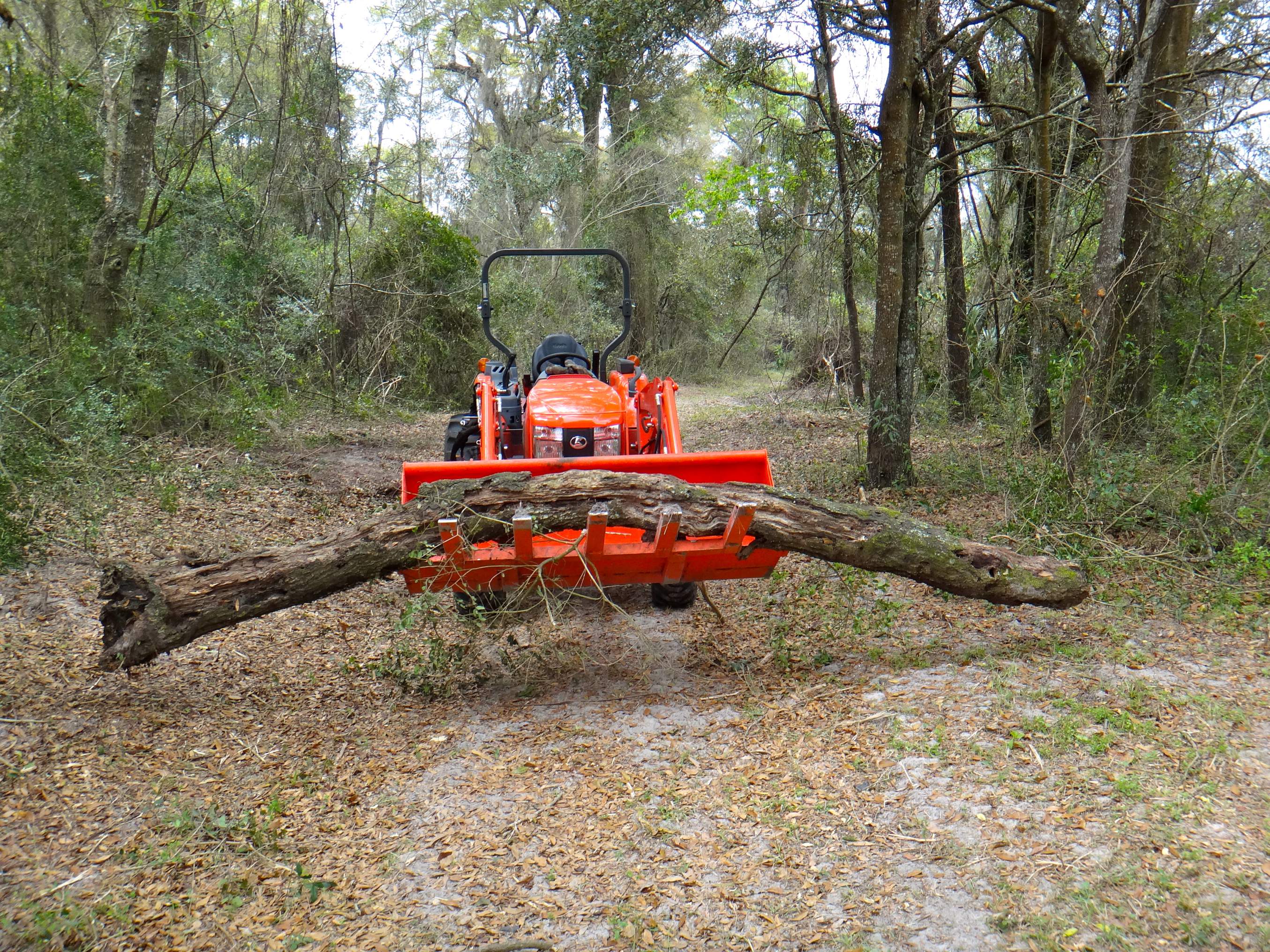

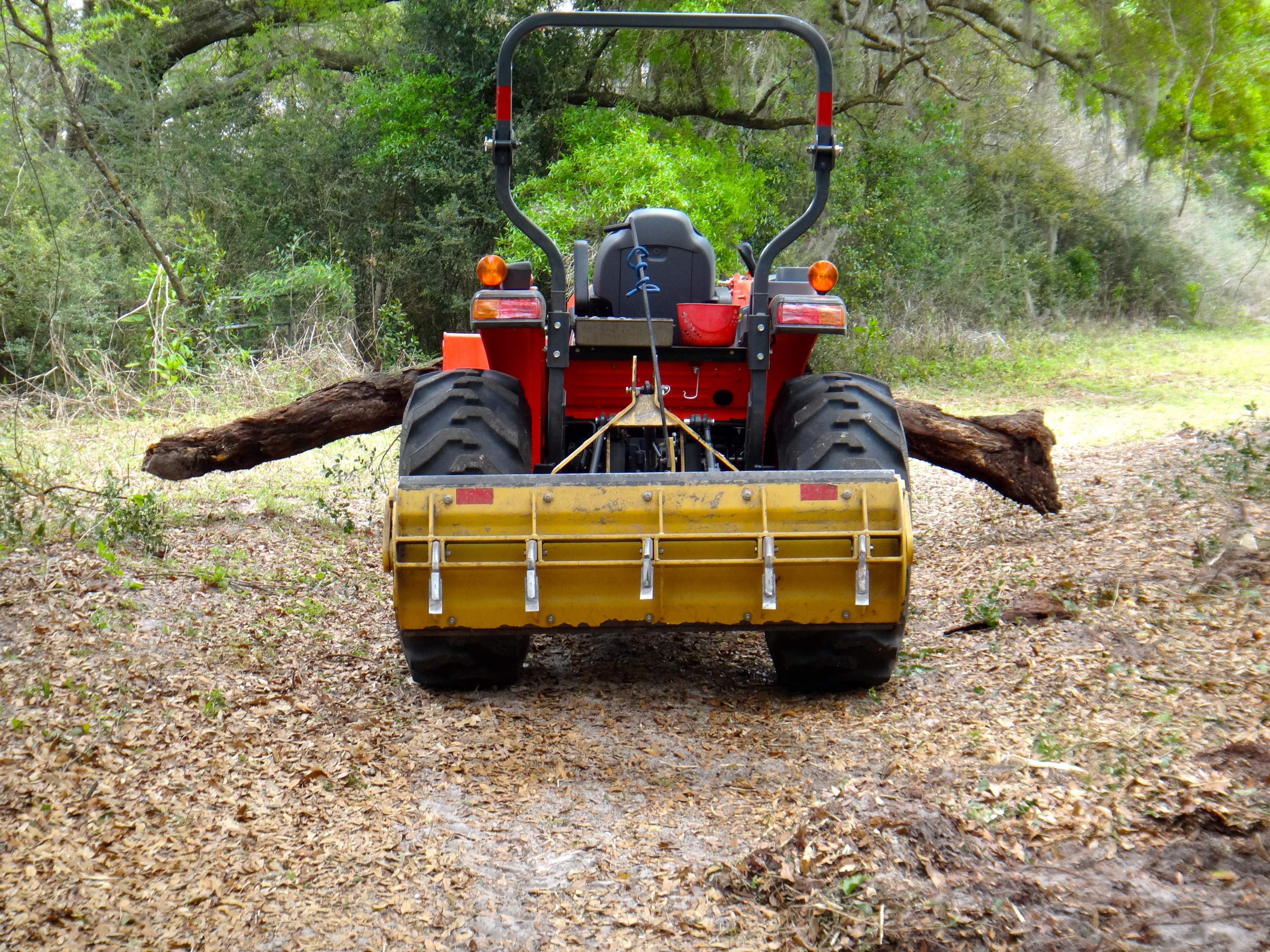

I noticed I have more downed trees (18-20" variety) so will be looking toward implements that can help with that as just dragging with a chain doesn't look as good in light of how many there are.
Dragging you can move whole tree trunks, even bundles of tree trunks, to a burn pile/pit. Saves chainsaw time/effort/hazard and immediately dulling saw chains on dirty wood.
Other options are with the Loader. Either a grapple or clamp on bucket debris forks of some description. I recommend optional SSQA bucket attachment, which is required for a grapple. Grapple and forks require substantial Three Point Hitch mounted counterbalance.
A grapple makes chainsawing trunks into sections relatively easy. When tree is elevated slightly the chainsaw will not be pinched.
Caution when transporting heavy loads with the FEL is advised. Heavy FEL loads decrease tractor stability ~~~~ then a wheel drops into a hole and the tractor may rollover. You can tow heavier loads with the rear/center drawbar than you can transport safely using the Loader.
Most of us you both the Loader and the rear/center drawbar.
The most important tool for 18" - 22" trees is a high quality chainsaw. I use a commercial grade Stihl MS 261.
