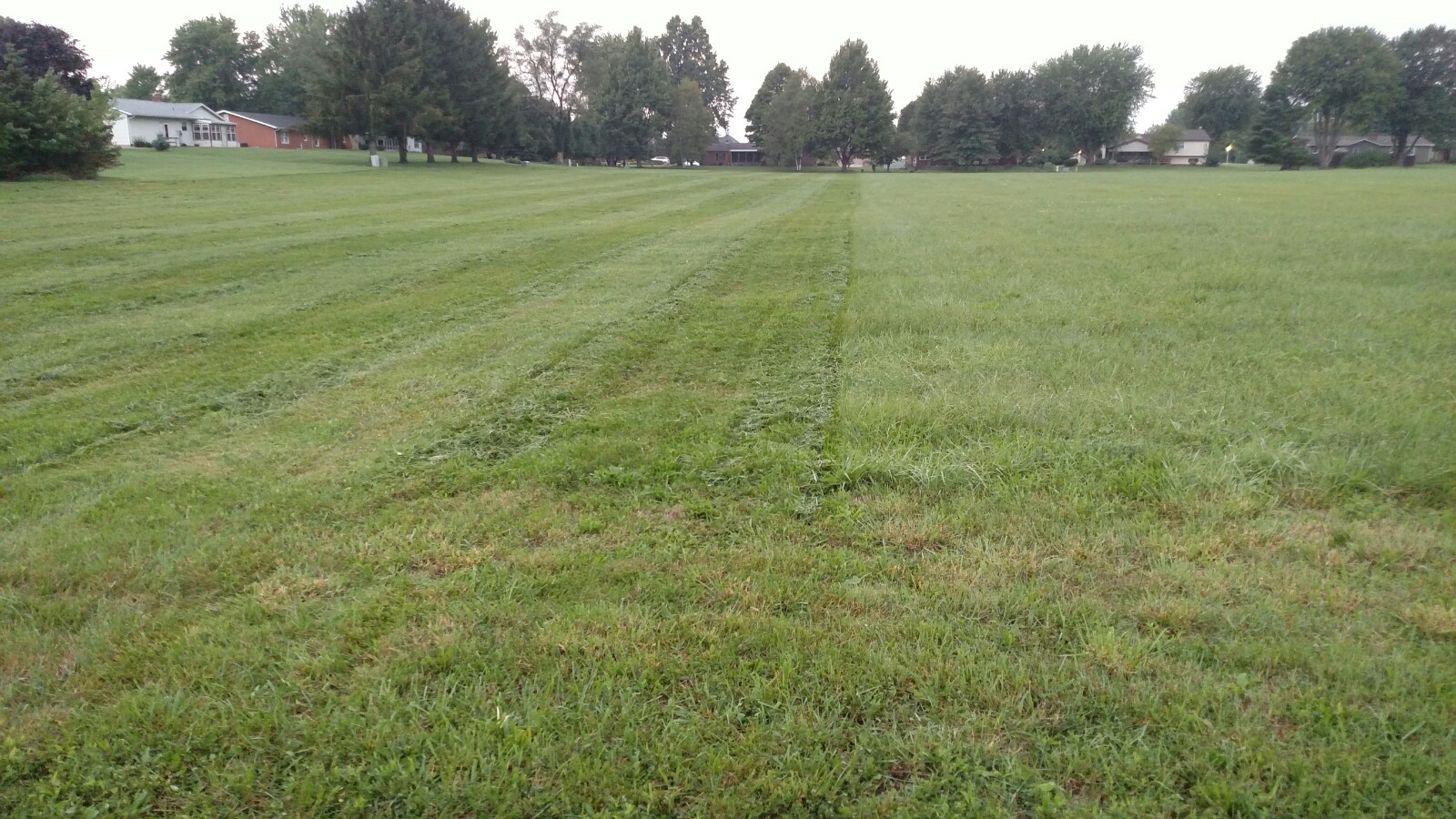

I live north west of you about 20 miles nw of Millersburg, the epicenter of tractors with Kubota, John Deere and Yanmar all within a quarter mile of each other. I mow 7 acres of finished turf (I'm a retired golf course superintendent so I have different issues then most here) and am looking to replace a JD 445 with a 1025R, FEL, 60"MMM and a 54" Front Blade (with extensions) for Snow on a 350' driveway, concrete.
Obviously you are in a larger venue than I. I'd be looking at a JD 2 or 3 series unit as an example with implements to suit your requirements. Your site is much larger than mine with more varied needs and much more varied topography, I love that area. Best wishes on picking the right tractor for your needs as it will be with you for many years. I chose my unit for auto connect as my back/neck is very bad and I find it quite difficult/painful to try to hook up the under the tractor MMM PTO every spring and fall when changing from MMM to front blade. I'm looking forward to the FEL for lifting, pushing, back dragging, etc. areas that I could not perform before.
Enjoy your fine turf. I love a park like setting and it should increase your land value from a visual standpoint plus it is a pleasure to see every morning. At least it is for me. Looking our our back door and sun room the park like setting makes it all look as if we live in the middle of a park, which we do in actuality, a private park! Enjoy.

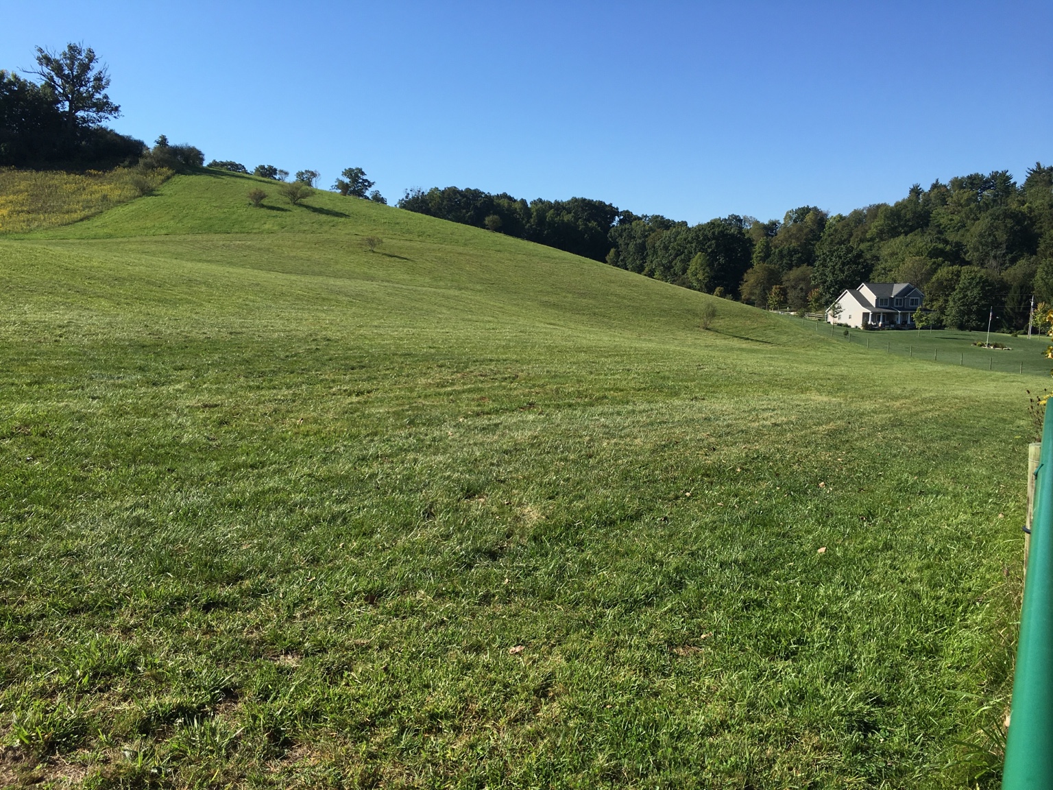

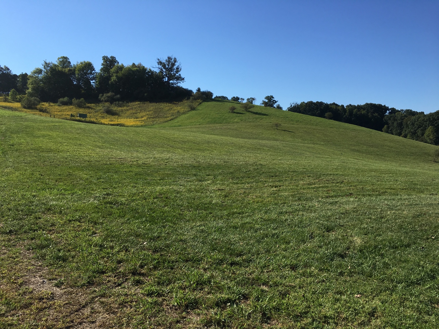

Welcome to TBN, RLWATSO1, from another Ohioan who grew up not too far from you, in Wayne County. Beautiful place you've got there! You've gotten some pretty good advice from others here so far. Choose the brand of tractor you like best... there's some fine equipment on the market to choose from. Here would be my thoughts about your mowing situation.
First, a rotary cutter would be my weapon of choice, except for maybe some kind of finish mower around your house. That hill you've got will be the principal challenge. It's steep enough that you'll need to get the right tractor setup to handle it well. R1 Ag tires instead of R4 Industrials, for example, to give you maximum traction. I'd be looking for a tractor with a good power-to-weight ratio, since you'd be climbing a significant slope while mowing. Also because of the slope, I'd be looking at a hydrostatic drive, to minimize the need for any downshifting halfway up the hill (That's not a good place to be taking the transmission out of gear). The rotary cutter would give you more flexibility in how often you mow, and that could be important in letting you mow the hill when the ground is fairly dry. With a finish mower, you'd have to be on it more often.
Best wishes with your new place.
