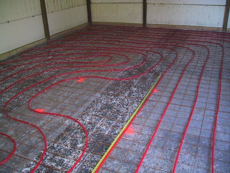

Looking to get this floor finished before winter... and lately it's been getting below freezing at night here, with daytime highs in the 40s. Getting different opinions if calcium ad is needed, and I wondered what the pluses / minuses of using the add might be? The guy I would like to use is recommending it strongly, and claims that with only a "2%" mixture it won't affect the strengh, but I have little experience in this area. I'm thinking that with the base still warm and air temps in the 40's...maybe I would be OK without it? As you can see from the pic, no rebar, only using a light mesh, the floor is 21 by 32 (averages about 4.5 inches think, upto 5 in a few places)
Alternative is to wait till spring... but I sure would like to get this done..:)
All opinions appreciated.
-Toolnut

I see you are putting radiant tube in there, that is good thinking, one thing make sure you take some accurate measurements near all walls and posts so that if you ever want to anchor anything along a wall/post that you can refer back to the measurements (on a photo works great I found using my digital camera marking locations and laying the tape out and taking a pic you can easily count the major foot marks and also then the 1" ticks just in case! I see you had a tape in you're pic above so maybe you are already doing that ? anyhow just wanted to say that so that later you could keep that info around store them on the web (photo bucket lets you store stuff for ever free as does many other pic sites! I had a bunch of my place and still do only they are in a hard drive that can't be accessed anymore due to a bad virus that wiped out the FATs :( so back up those important pics on-line and disk & 2nd storage media if possible..

Roger on taking the pics, I really should take a few more. Someday I'm hoping to put in a two post car lift, that's why the funny loop pattern in the center. Also will be using for to store my welding stuff, tractor goes in the unfinished section next door....:)
I asked the contractor today again about the downside of adding calcium, he seemed pretty confident that it wouldn't affect the future durability much, said he was using it he pours his own garage floor next week. I think it is partly to speed things up for him, but it has been getting down to 25 degrees or so here at night so I think I'm just going to let him use it.
Thanks for the all the comments, I'll have to ask him about bringing some tarps.
BTW, you'll notice no insulation under the slab... I decided that I just use re-claimed styroform (4" worth) all around the outside parimeter and skip the expense of new denser insulation directly under the slab. This will give a lot more thermal mass, (so it probobly days to heat up...) but should also carry through longer when not getting new heat. Hoping to warm it using solar collectors.. but that's another thread..:) for next year.
-toolnut

In my opinion, You need some type of insulation on bottom of slab. I would think the "ground" will absorb all the heat and cause you a high energy bill.
