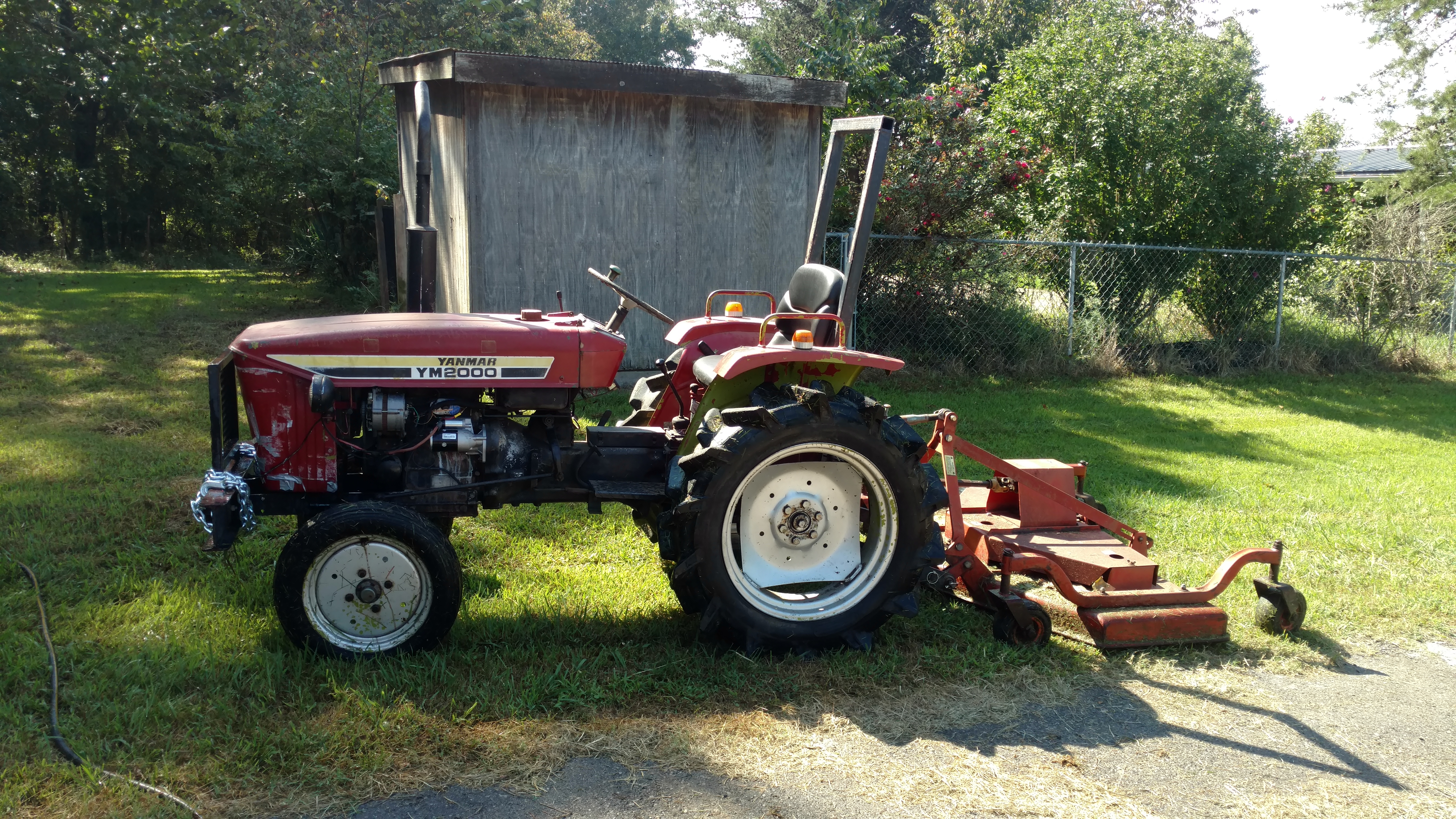

So I finally got the finish mower hooked up and started mowing. 1 in pto, 2nd gear high in trans @ 2000rpm. Plenty of power but didn't take but 5 mins for it to start puking water. Pulled over to hose and sprayed through radiator and cooled it down a bit. Popped cap and added some water. After filling it again it looks like there is barely any flow. On a car you can really see the water moving after thermostat opens.

I don't think you have a thermostat. Never owned a 2000 but I know my old 2002D had a strong flow. I would think the 2000 should.

"There are very few water cooled engines that don't use a t-stat." Yanmar made quite a few and even quite a few without water pumps.

No tstat and not a bad waterpump, unless the fan is into the radiator. Make sure the radiator fins are clear and back-flush the system.

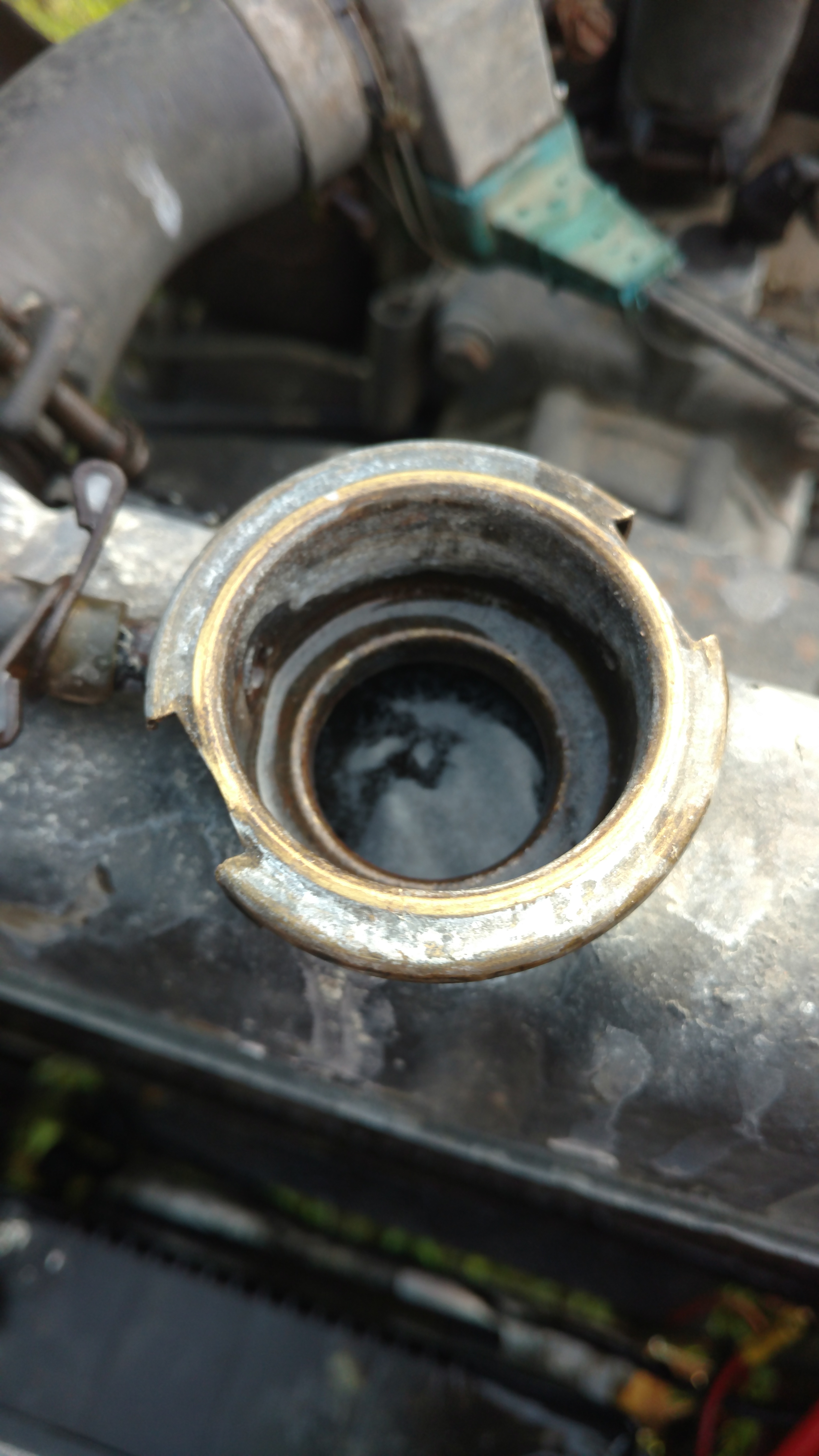

Tried back flushing and it seems like it takes all the water hose pressure. Oil is clean so no blown head gasket.
Just doesn't seem to be enough flow. Water isn't moving much at 800 rpm. 1503874233904.jpg

Just doesn't seem to be enough flow. Water isn't moving much at 800 rpm. View attachment 520024
1) These don't have a thermostat.
2) Compression pressure getting into the coolant will show as bubbles when you look in the filler. So if that doesn't appear and the oil is ok, then a head gasket moves down the list as a likely cause. I think a bad pump impeller is at the top of the list.
3) What is that blue gadget (with wires?) in the upper center of the photo?

"3) What is that blue gadget (with wires?) in the upper center of the photo?"
Good catch California, that may be the trouble area. That is some kind of add on. May just be for an added temperature gauge sender.

It's a plug in heater for the water. It also has a block heater. Gets pretty cold here in the winter and without it they won't start in winter when I need to blade the snow off the driveway.

Would it be possible for the heaters to block flow?? Just asking. :confused3:
