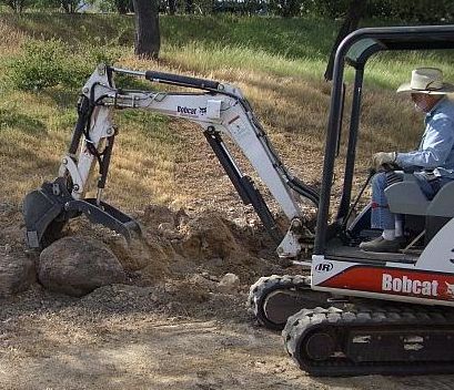

I pulled down moved and rebuilt a rock retaining wall. If the grapple doesn't work you might consider renting an Excavator with a "thumb." I've attached a picture where I'm picking a rock straight up. Some of the rocks I moved were 300 to 400 pounds. The excavator is very stable when moving rocks in the backhoe bucket, my tractor backhoe wasn't. The grapple on the front of a tractor should be a lot more stable than using the tractor backhoe for transport.
