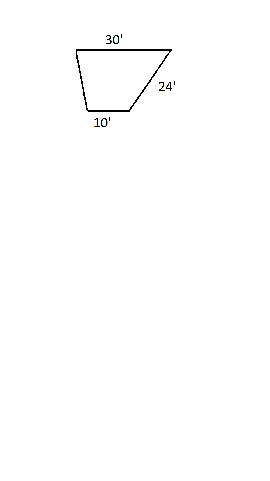

It's been so long since I got out of school, I can't remember how to solve this problem.
I can't even remember if its geometry, trigonometry or whatever. Maybe its early Alzheimer's?
Please help me find out how many square feet this is.
436.348 Sq Ft.

Now somebody posted something above that jogged my memory. Put a triangle on both sides to form a rectangle. A) Calculate the area of that rectangle (even I remember that part). B)Then calculate the area of the triangles (a little fuzzy there but it is available quickly on-line). Subtract B) from A).
   / Need help with my geometry #47
Due to the dimensions given, the length of the center rectangle was unknown. Sides A and C were known, so C Squared minus A squared equals B squared, in this case about 21.8 feet. Then it's easy...
   / Need help with my geometry #48
The main dimension that needs to be calculated is the width between the 10ft and the 30ft sides. One has to assume that the figure is symmetrical, else one needs at least 1 more dimension.. It is also assumed that the 10ft and 30ft sides are parallel.
Using Pythagoras, the distance is (24^2-10^2)^.5 = 21.817ft
Now you can slice off the triangle on the right and add it to the diagram on the left to make a rectangle. The rectangle is now 20ft x 21.817ft. That yields a surface area of 436.348 sq ft.
   / Need help with my geometry #49
Assuming the figure is symmetrical and the top and bottom lines are parallel. The height of the figure is calculated as (24^2 -10^2)^0.5 = (576-100)^0.5=21.81742'.
Then the area is 30*21.81742'=436.3485 as determined in several previous entries.
   / Need help with my geometry #50
Yet another way to solve it. Now it is all Pathagorean.View attachment 465621
That is how I solved it. And get the 436.xxx as well.
But that is making the ASSUMPTION that the other diagonal leg is ALSO 24'. That wasnt a given as per the first drawing. As it stands, how the drawing is sketched up with current dimensions, and not knowing that it is symmetrical.....it is technically impossible to figure without some other numbers. Either angles, or length of the other diagonal.
Gathering more facts and knowing it is for a driveway apron.....I hope we can assume it will be symmetrical. Thus the conclusion of 436.xxx sq ft.
But its usually not good to automatically assume things in problems like this.
