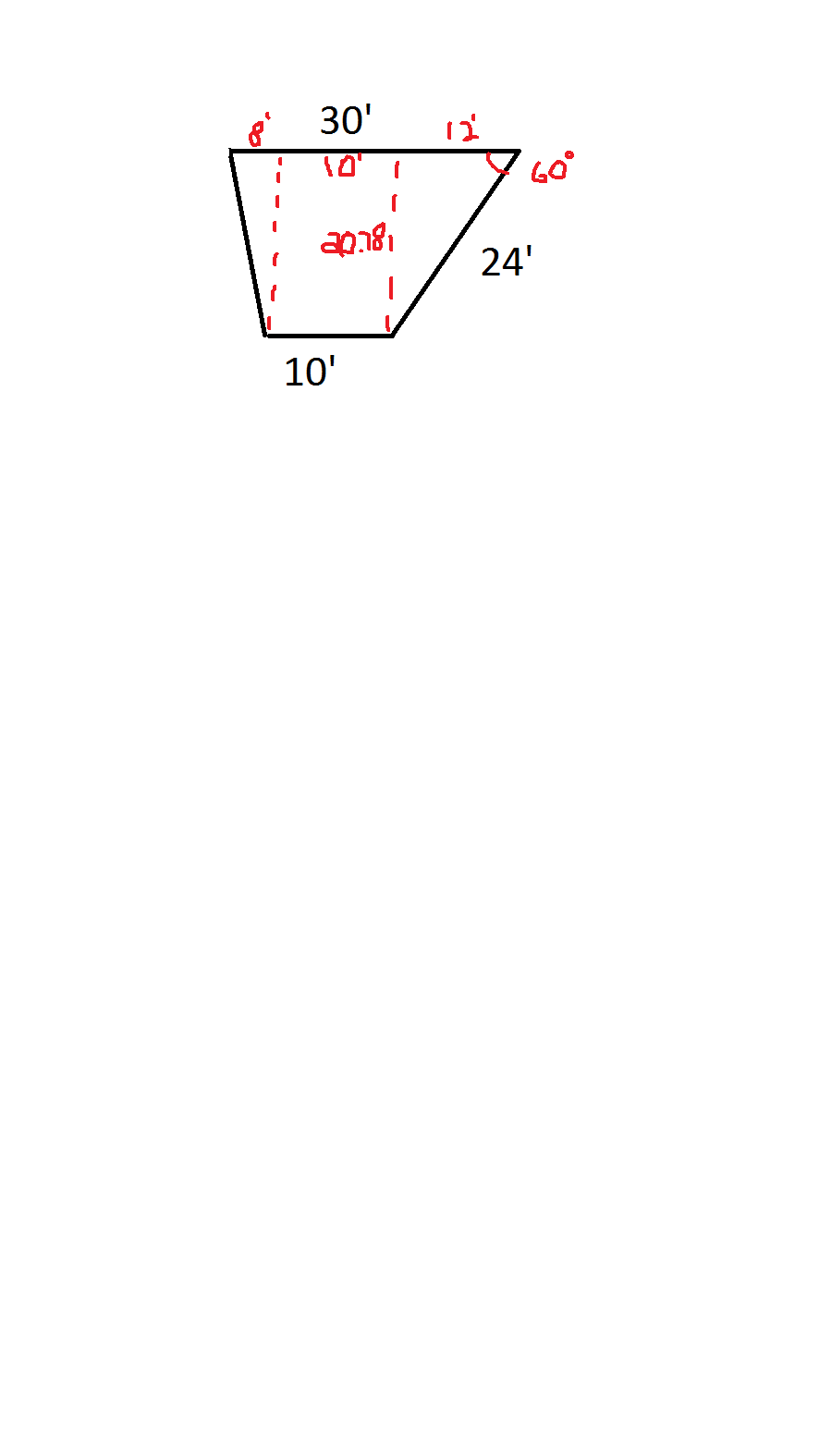

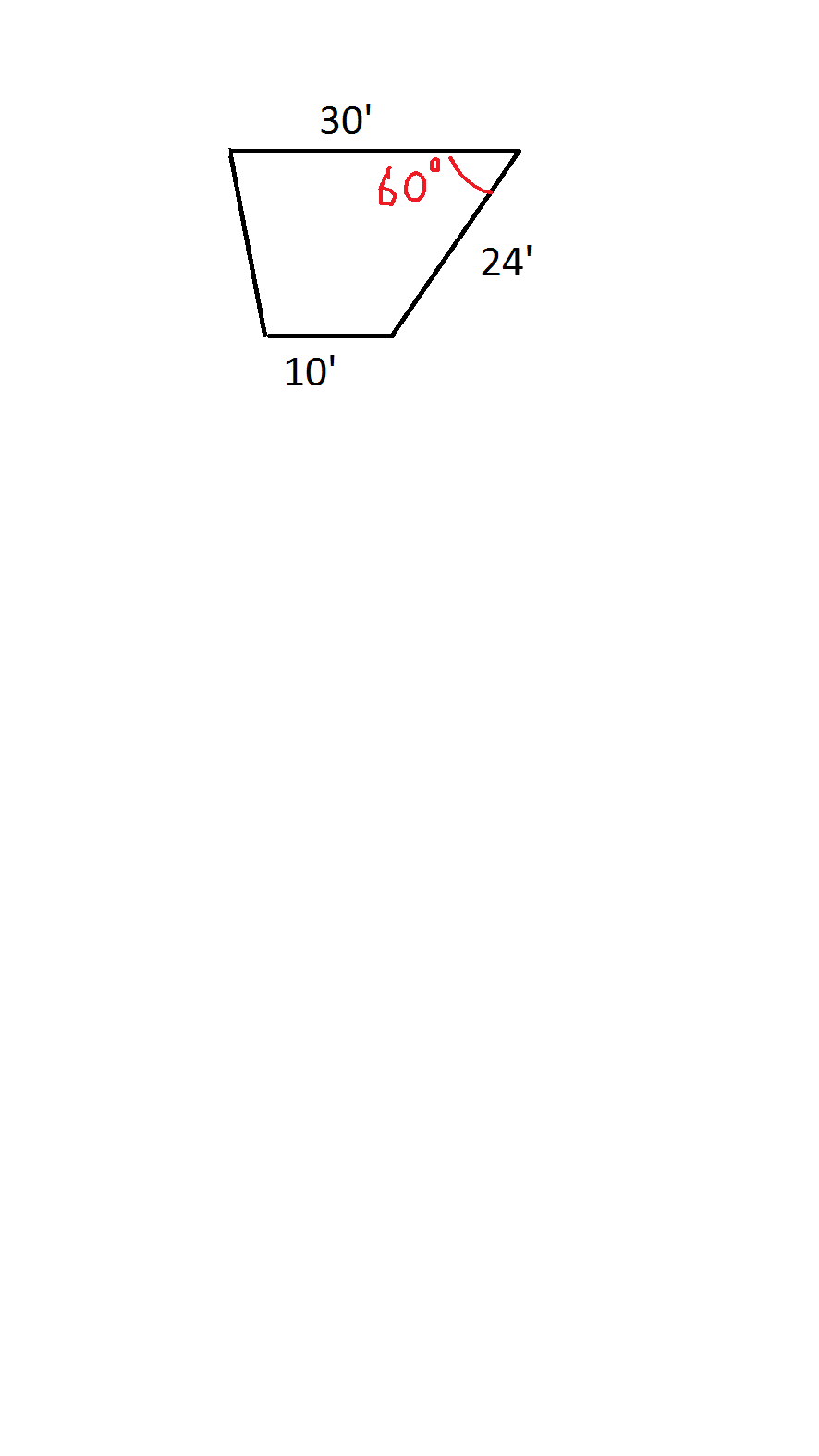

Cannot be solved. Need another piece of info. Either the overall height of the trapezoid, Distance between parallels.....that is assuming they are parallel (another assumption), One of the angles, etc.
Assuming they are parallel, simply adding an angle makes it solvable:
Sin60=h/24 will give us the height of the trapezoid. which would be 20.78.
then you can either use the trapezoid formula [(base + top) / 2 ] x height.......(10+30)/2 = 20.......20*20.78 = 415.xx
Or you can break it into right triangles. cos60=x/24 would give the third leg to the triangle on the right. Which would be 12.
So knowing the height, you now know everything needed.

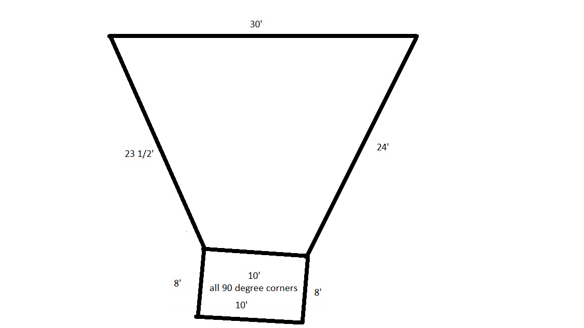

LD1, I just posted a fairly easy question (that I didn't know the answer to) without complete details of angles, exact lengths, etc. because I just needed to know how much concrete to order and I always order at least 1/2 a yard extra so I didn't need an exact answer and I did not supply exact details because I did not think it would really matter. Most people would assume that the top and bottom lines were parallel from my original drawing and give me a close enough answer for my question, which they did.
Now you say you did not answer earlier because you did not want to assume that the lines were parallel until I revealed that it was for a driveway apron and then you "assumed" that they were parallel.
Well, so much for assuming. :D They actually are not parallel and the 2 sides are different lengths though I did not disclose this earlier because I did not want to over-complicate the matter and I had another part also that was a rectangle of 8' X 10' that I was easily able to figure was 80 sq. ft. that I added on to your correct answers without disclosing.
Now if any of you wish to tell me the exact measurement of my apron from the enclosed drawing, with more details, and the amount of concrete I should order, adding 1/2 yard extra, to be safe, please do so. I will see how much it varies from the 10 1/2 yards I am planning to order. ;)
PS: The concrete is 6" thick.
Are those angles at the top = ... and what value ?
