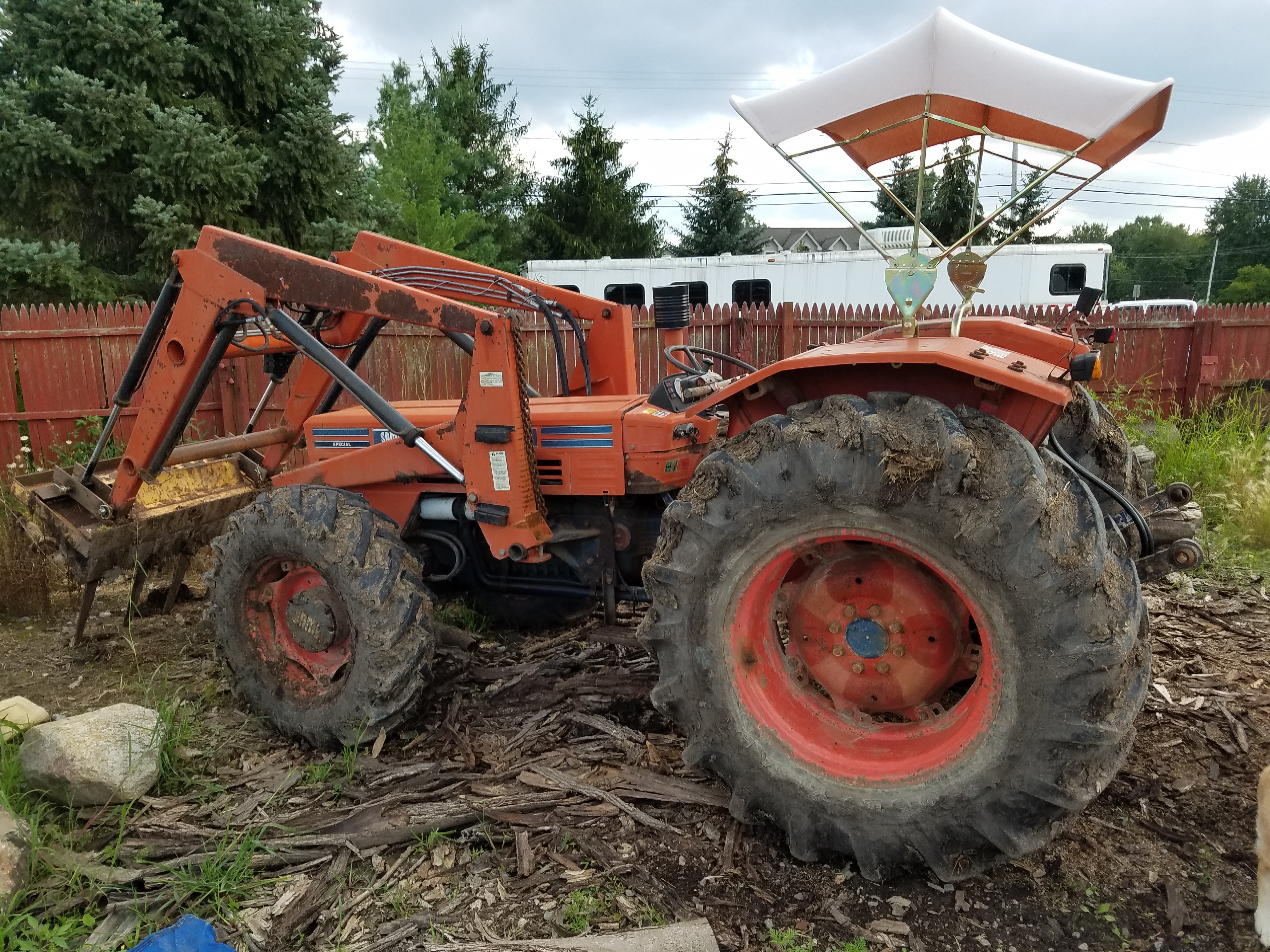

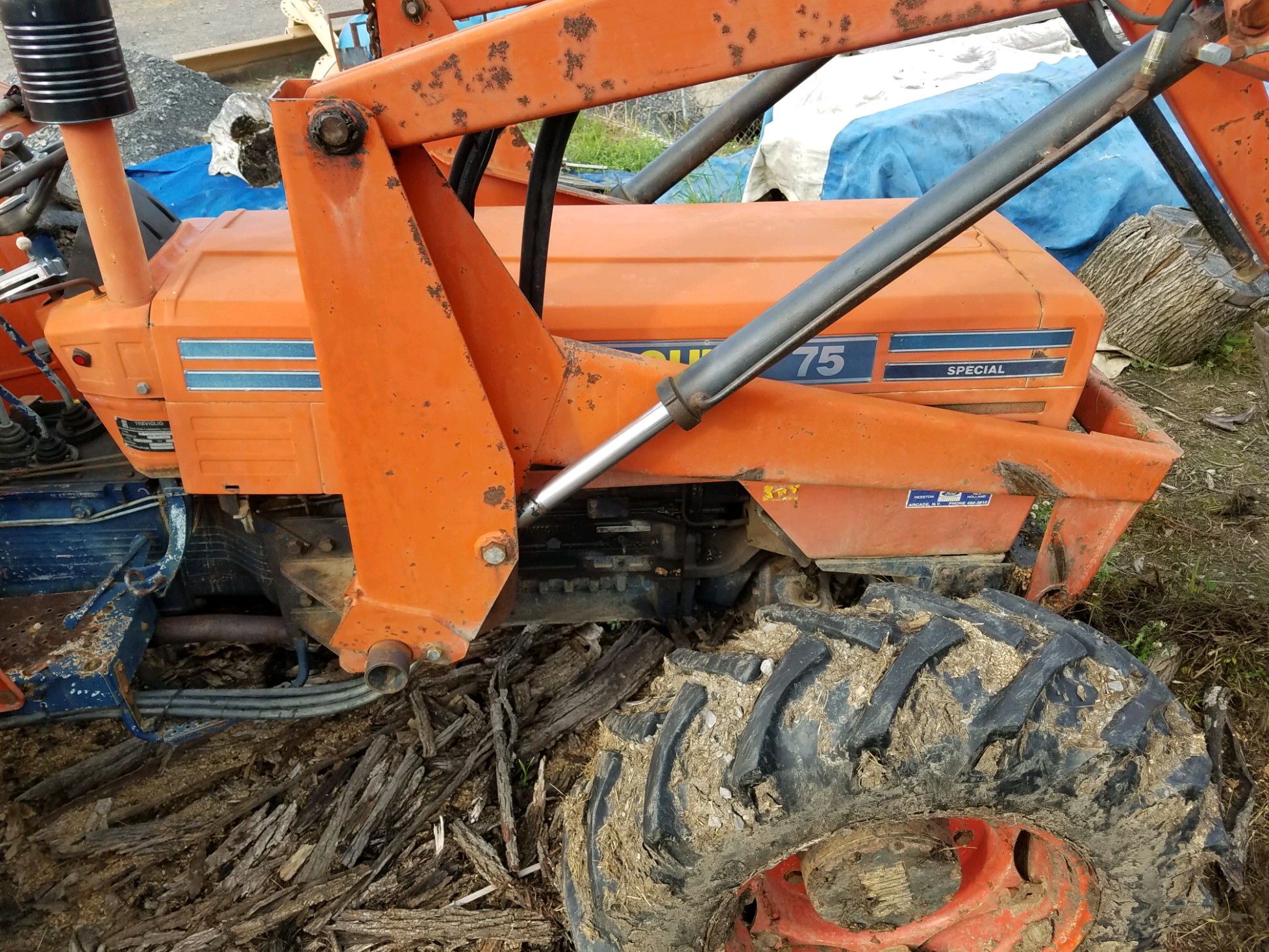

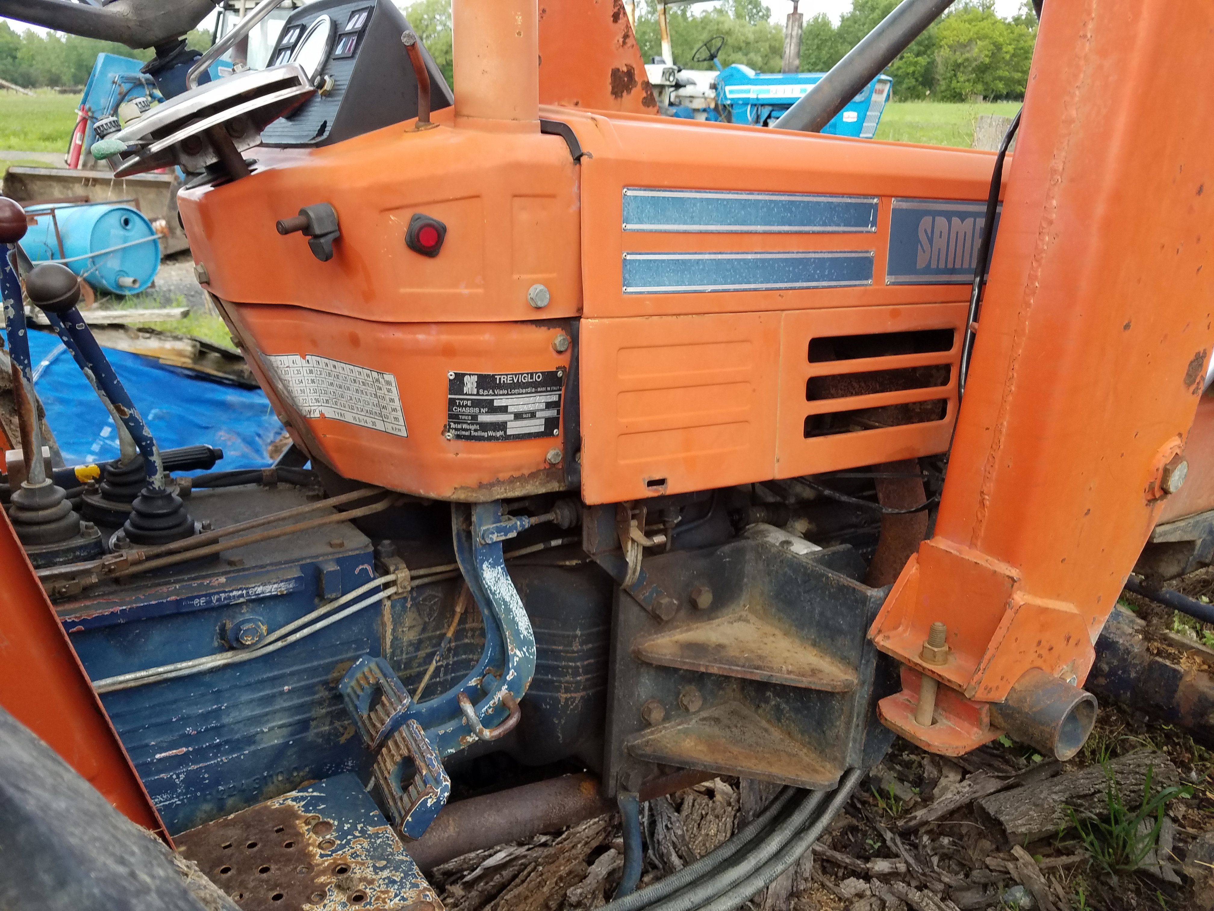

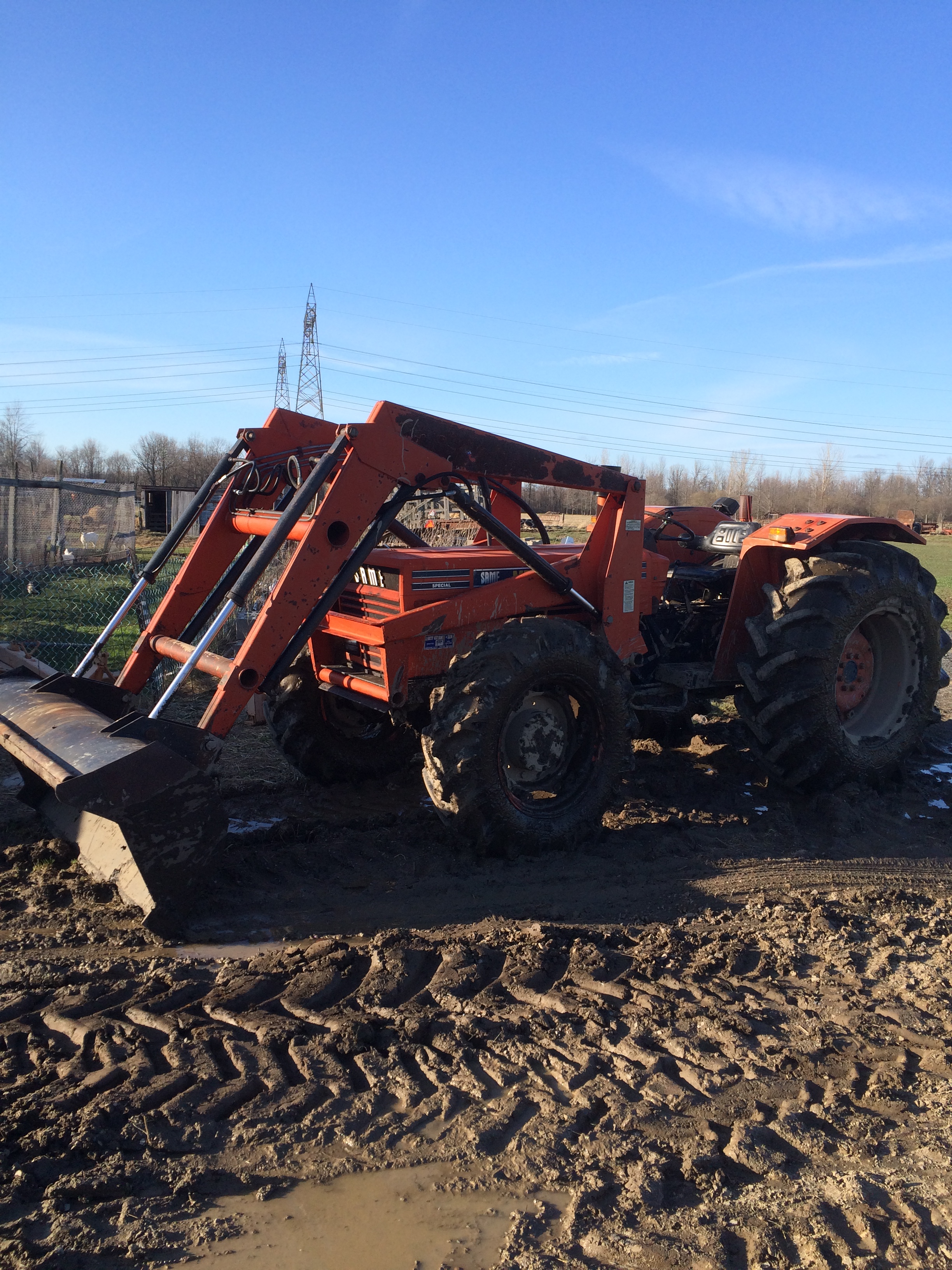

I am trying to figure out which model my loader is and was wonder if there was any help out there. I have pictures attached (not the best) and the tags in the 1 photo are just warning labels. I haven't found any other markers on it. From just a quick search I believe it to be a Deutz-Allis brand loader but not sure the model. All the pictures I have seen have one stand leg (not sure correct term) centered on the cross bar just behind the bucket whereas I have 2 stand legs just below the cylinders that raise and lower the loader.

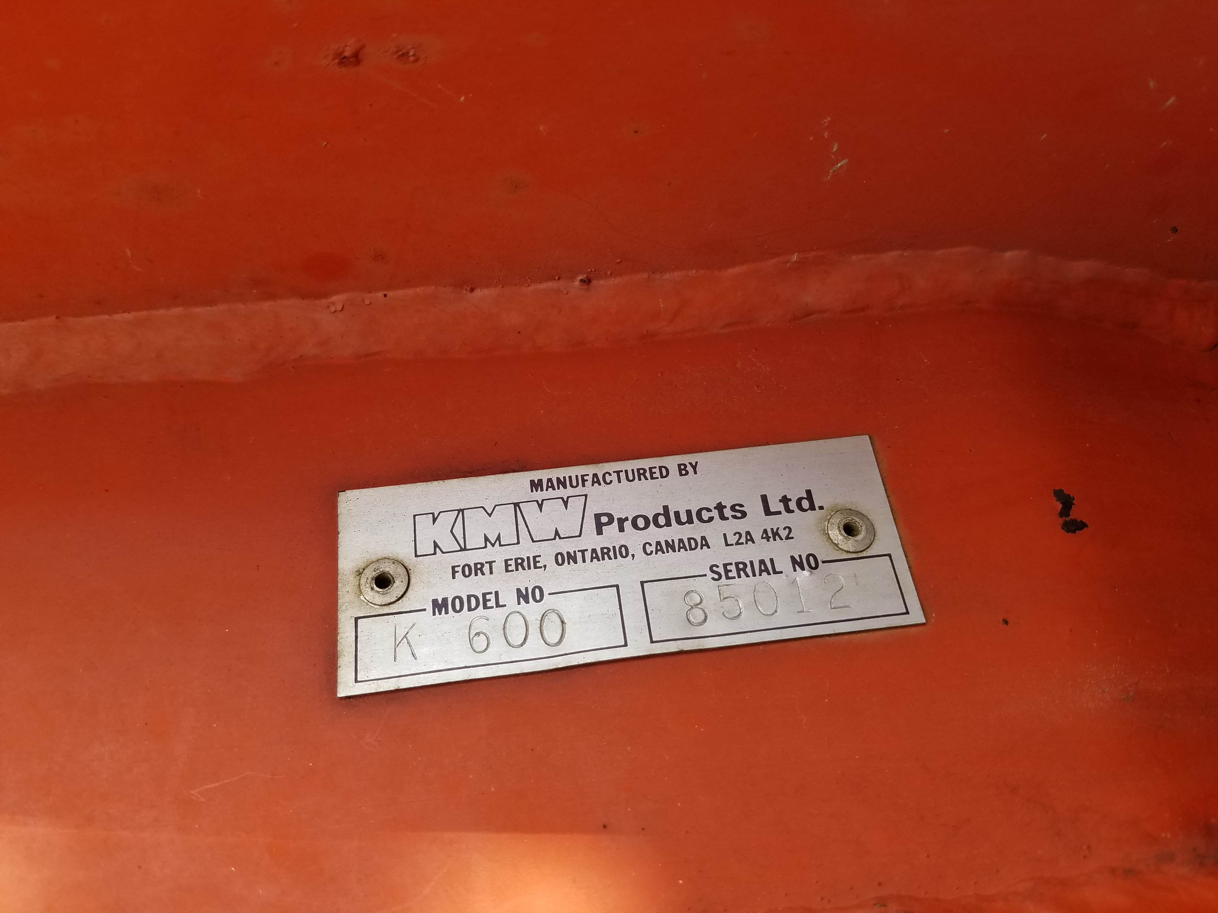

Yeah. It's a KMW K600. I found the tag. I shouldve looked better before posting...now I just need to find a quick attach for it.
