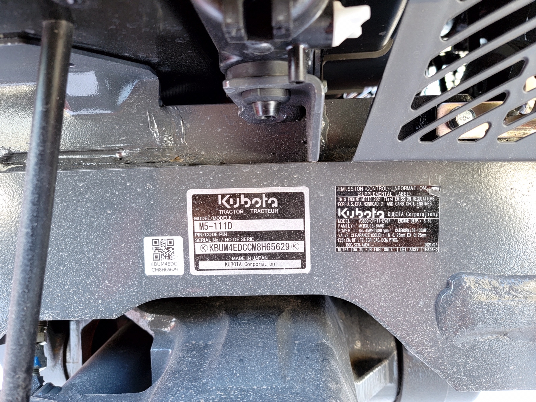

The tractor will need an engine certification label like this found on my Kubota M5. M5 is built in Japan. My M7 has a different style certification as the engine was built in Japan, installed in a tractor built in France, and imported into North America. It only states EU certified. I’ve been retired for several years and there may have been updates, but for we manufacturers, controls were rigid. We used that to restrict customers purchasing identical machines in a low transaction price country and moving it to a high transaction price country. Yes, a factory in a country may build identical units in one country for sale worldwide, and then limit where an individual unit is sold by emissions certification label.
   / Need help with importing a JD 5075E from India to USA. #22
So really all you need to do is find someone who is willing and capable of making a label.
