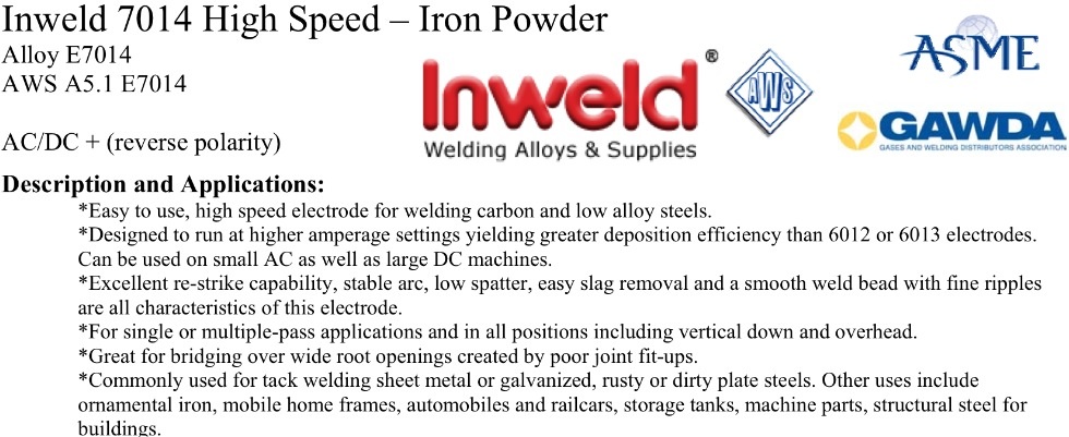

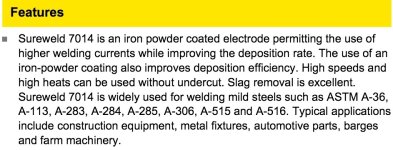

/ Need help welding hooks #39
ArcWeld - I'm not going to say 7018 isn't a great rod - it clearly is. May even be the best choice for the hooks as well.
I'm going to respectfully disagree that 7014 won't work for dynamic loading though and have attached two manufacturers intended uses for the rod - it would appear that some of those uses are dynamic.
