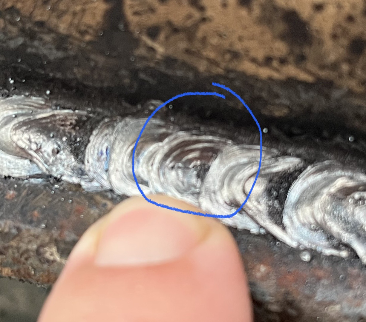

Welding mild steel to rail road track. Asked a friend and he told me just turn up the amps some and weld it. I know the rail track is a high carbon but he said I shouldn’t have a problem without a pre heat. I was using 5/32 6011 to hopefully run just single passes and unless it’s structural I honestly just choose to keep my 7018 sealed. Metal was cleaned at weld joints good. Long story short you already probably know but one weld line about 20” long has a few hair line cracks center of the weld. All the rest seems fine.
Should I just grind it out and fill it back with 7018? Or heat it this time before?

what is the application? pre heat would be my suggestion, do a higher amp root pass with 6011 once or twice & grind, then follow with a few multiple 7018 passes grinding if necessary. what is the intended use?
i might even suggest preheating rail w/rosebud prior to weld. regards

It’s a gate post a metal gate hangs off of. Nothing that will have a lot of stress. Will it be fine with just the single pass of 6011 or does it need the 7018 cover pass?
Weld joints were Fillet and Lap joints. The one and first lap joint was the only one I had an issue with.

Rail was already cut. And I welded on both top (where a car rail wheel rides) and the bottom flat that sits on the cross ties. The weld that showed hairline cracks in the weld was one of the welds on the bottom flat where the track would sit on the cross ties. All the others seem fine

This a a pic of one of the cracks in the weld. Circled in blue. Probably about 5-6 like it down the 20” weld seam.
