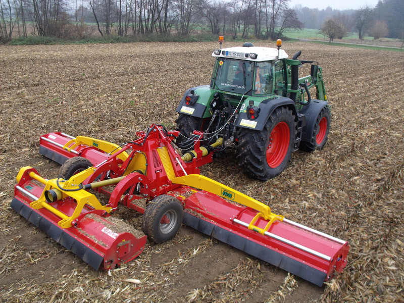

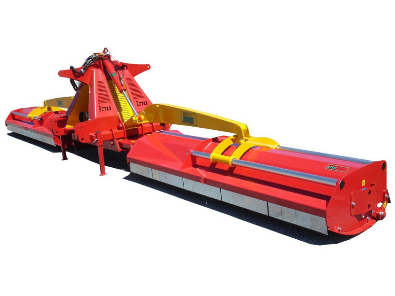

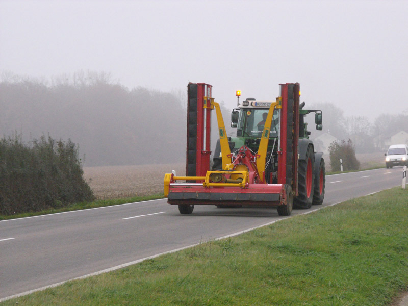

INO offers a two or three section flail shredder and they can flex up to 15 degrees from horizontal.
Here are two well done videos showing how tall growth is shredded by the INO flail mower down to 2 inch height and how corn stubble is shredded using the triplex flail shredder with the spiral mounted cast and machined cup flail knives.
I have also uploaded an image of a triplex 800 fully retracted and traveling on the highway in Europe.
If I had a you tube video for the Mathews flail crop shredders I would post that too.
The Fendt tractor towing the triplex mower in the sunflower crop was not stopped by the sunflower crops high population stand.
Since my browser is old I get an error message but all you have to do to link to it is type in you tube then type in the rest of the URL address for both videos as I have typed them.
Triplex 800 mulching sunflower crop
/watch?timecontinue=40&v=9pc8v01zwDm
