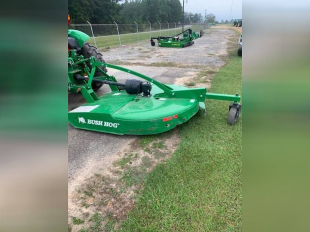

I see a BH 216 a size up from what you have for sale at a dealer fairly close by. Its only a few years old. A few dings in the back deck but the paint is very fresh. They are asking $1,500. Is that in line with what I should expect? would the gear box warranty extend on a used piece of equipment?
/ What rotary cutter fits my needs? #5
I see a BH 215 like you have for sale at a dealer fairly close by. Its only a few years old. A few dings in the back deck but the paint is very fresh. They are asking $1,500. Is that in line with what I should expect? would the gear box warranty extend on a used piece of equipment?
If the paint is in good shape it's probably worth that. You may want/need a 6' or 7' model though for your tractor depending on how many acres you have to cut. Not sure on the warranty, you'd need to contact Bush Hog. I do know the website states 10 years on models purchased after 1/1/2020 so I don't know what the gearbox warranty was before then, maybe just 5 or 6??
Hopefully this picture works. Can't seem to figure out some things on this forum.
The one in the picture is a 2019 model. It looks like they have new models for $2,300
/ What rotary cutter fits my needs? #9
Well it's green, so that's worth less to me :)
No rear chains and they are about $250.00. Front Chains?, Slip clutch? you're starting to get close to what I paid new here in North TX for slip clutch and chains front and rear.
Its actually a BH 216 NOT 215...sorry I made a typo on that. I am going to correct it
/ What rotary cutter fits my needs? #11
That does make it worth more, I forget exactly how much but the price from 5' to 6' seemed steep when I was shopping, maybe about 400-500 more so that would make that one a better price at 1500 if it has the slip clutch and at least front chains. I'd offer the $1500 if they add the rear chains. it doesn't even appear to have the standard rear skirt even.
actually, looking closer, it has the chains on the right side, the left side set is what's missing. Offer the 1500 but they have to install the missing chains!

Here is another picture. Does this show you anything? Im wondering if the dented up frame has anything to do with it missing the rear skirting on that side. Maybe the guy ran over a cinder block!
