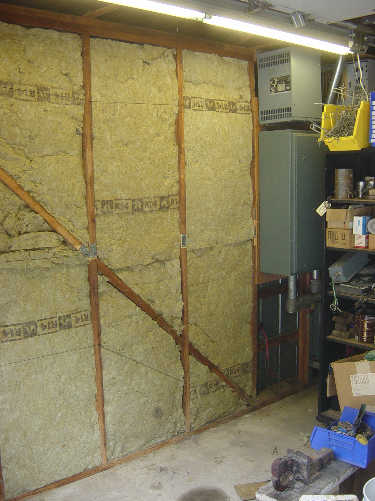

Thanks. I am insulating the wall with R14 Roxul. Man, it's now the second time I got burned buying this stuff from Home Hardware. It just falls apart in your hand. You are hard pressed to hold it vertically without it ripping apart! The first time I bought it, years ago, they assured me they had changed it, but alas the same thing.
I realize 96" won't fit in the space anyway, so I have to rip it off. My biggest worry around here is mice. For fire reasons.
