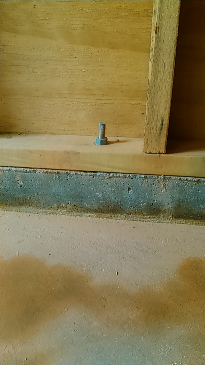

this is how I hope to eliminate the water on floor soaking into the wall covering.

I see that more and more in new house construction. Great idea!
