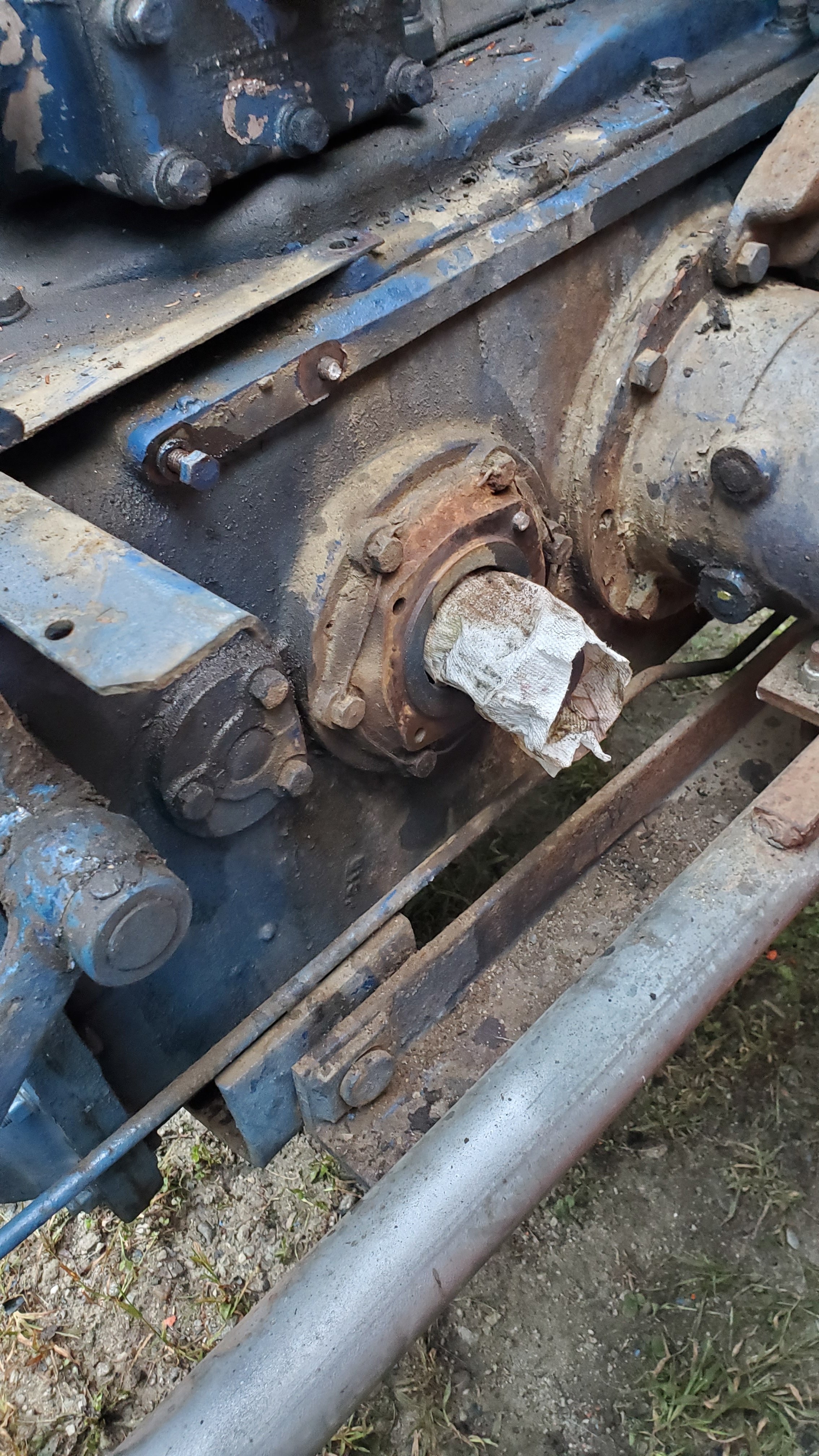

I agree. Lately I would weld a nut onto a broken stud, even if the stud is flush to the piece around it, welding in the center of the nut to make good contact. Then I put a wrench on it and back the broken stud out. The welding heats up the stud and helps it to break loose and the nut gives you something to put a wrench or socket onto. If the weld breaks, grab another nut and try again.
   / Need help getting rusty grade 5 bolt out of stainless steel. #24
OK, soft flame however.
On these two broken off cap screws, I used a rock hard flame, reheated to red hot multiple times, and then welded on a nut to turn them out.
Welding on the nuts assured they were good and HOT ;-)
