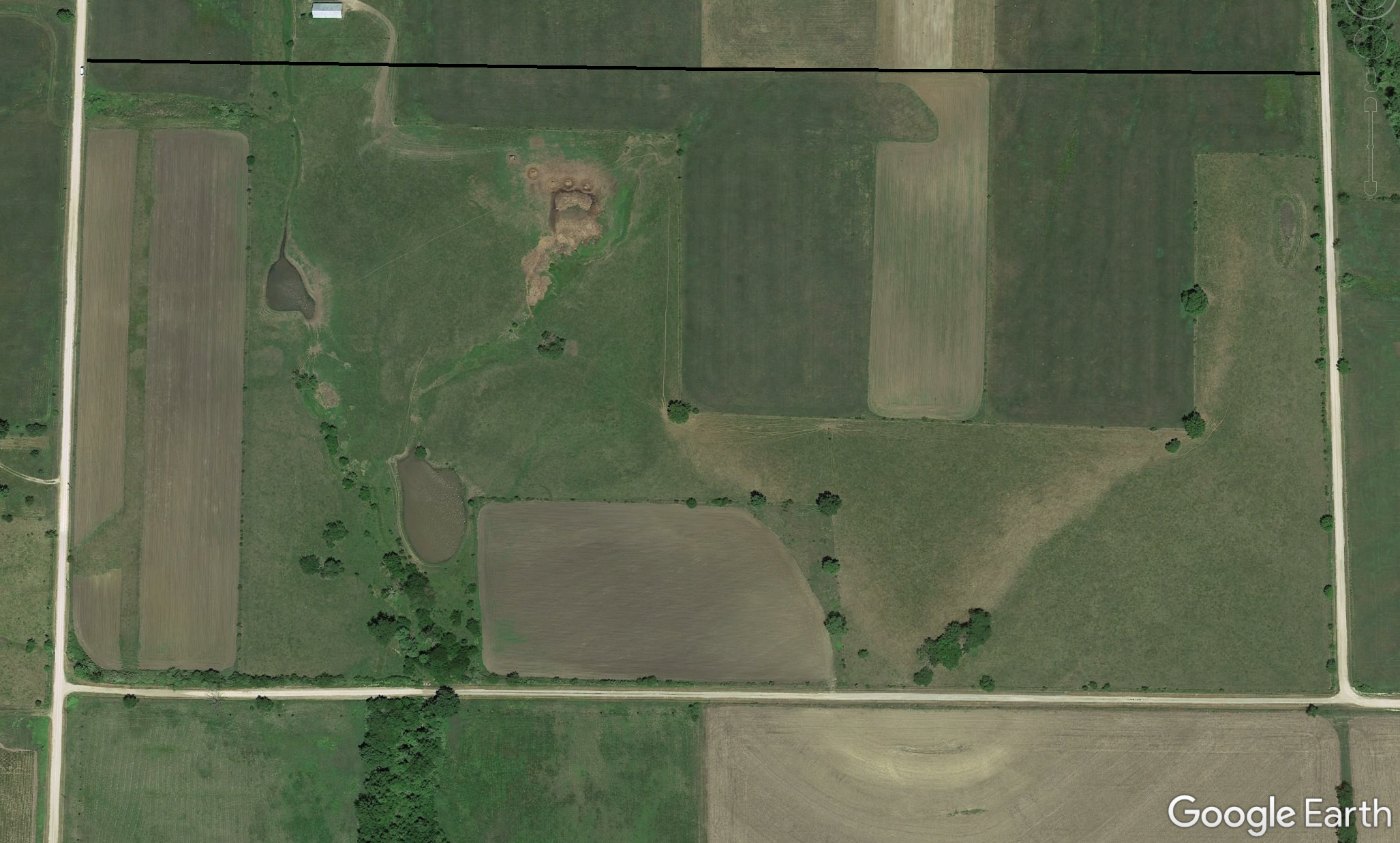

I recently purchased 80 acres of land. Currently, it is being farmed with 30 acres of tillable, about 20 acres of hay, and 30 acres of pasture. There are a couple of ponds and a creek on the property, but not much for trees. Picture below. My "day job" had a couple of really good years, which means I have some cash to work with right now, and would like to invest that cash into this land, a large barn/shop, and some equipment.
My wife and I would like to build a home and move out there at some point, but unsure if that is in the next few years, or a longer term goal. It is about 30 min from my house in the suburbs, so we are currently thinking about it as a "weekend warrior" farm, being there 1 or 2 nights a week, along with nearly every weekend. Father in law used to run a lot of cattle, and will be helping out a ton and checking on things during the week as well.
My goals for the land / Needs for the tractor:
1) Need to build and maintain a 1/4 to 1/2 mile driveway (fighting with wife over location of the future pole barn and potential house... :))
2) will likely not do row crops at least in the foreseeable future (but if we ever move out there, may consider it, particularly if I can get a little more land to go with it).
3) Will want to run cattle for sure once I am out there. Will definitely need to move bales around, etc.
4) I think I would like to convert the tillable land to hay, and mow/bale/my own, selling any excess. FIL thinks there is no money in it, but it seems to pencil out with what people are getting for round bales around here.
5) Smaller pond to the north needs constant battling and washes out. Some of this I may bring in bigger equipment to work on, but may need to work on the dam, etc. with the tractor.

- StAngerSandman

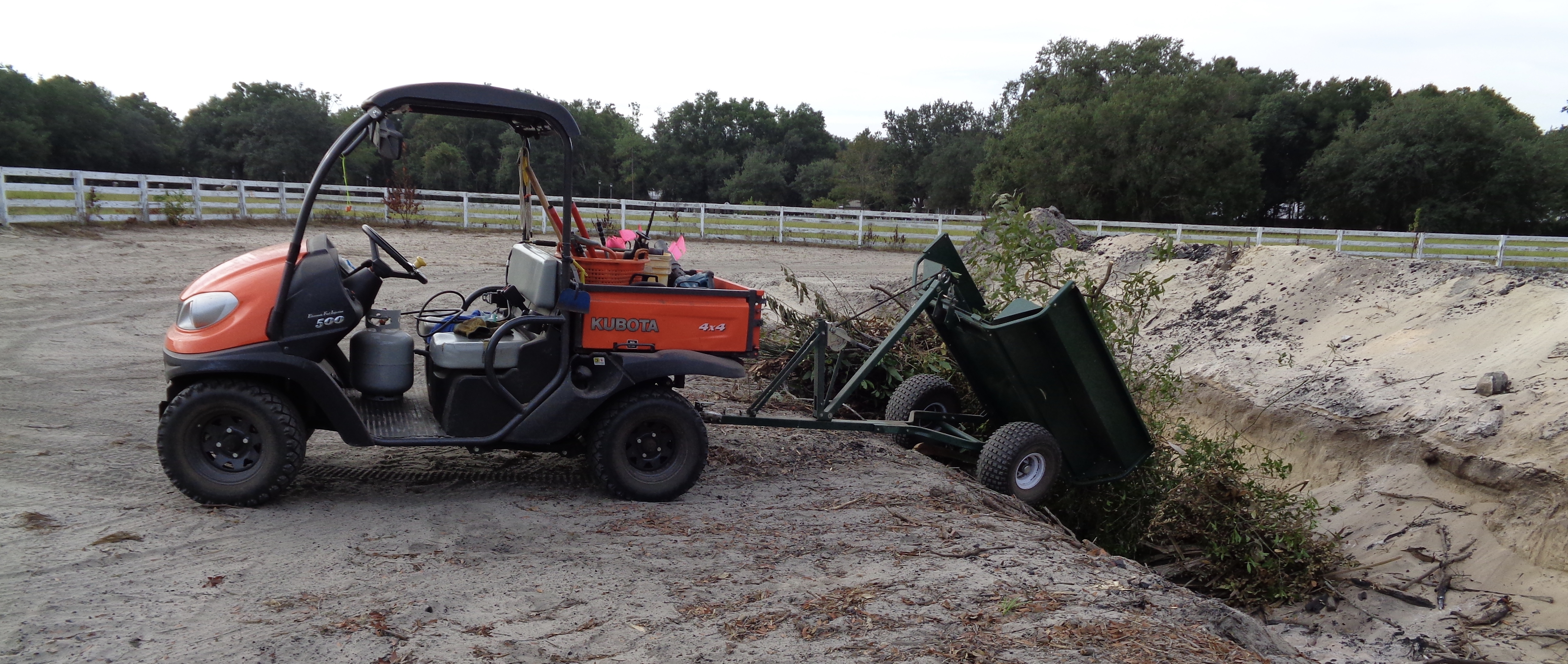

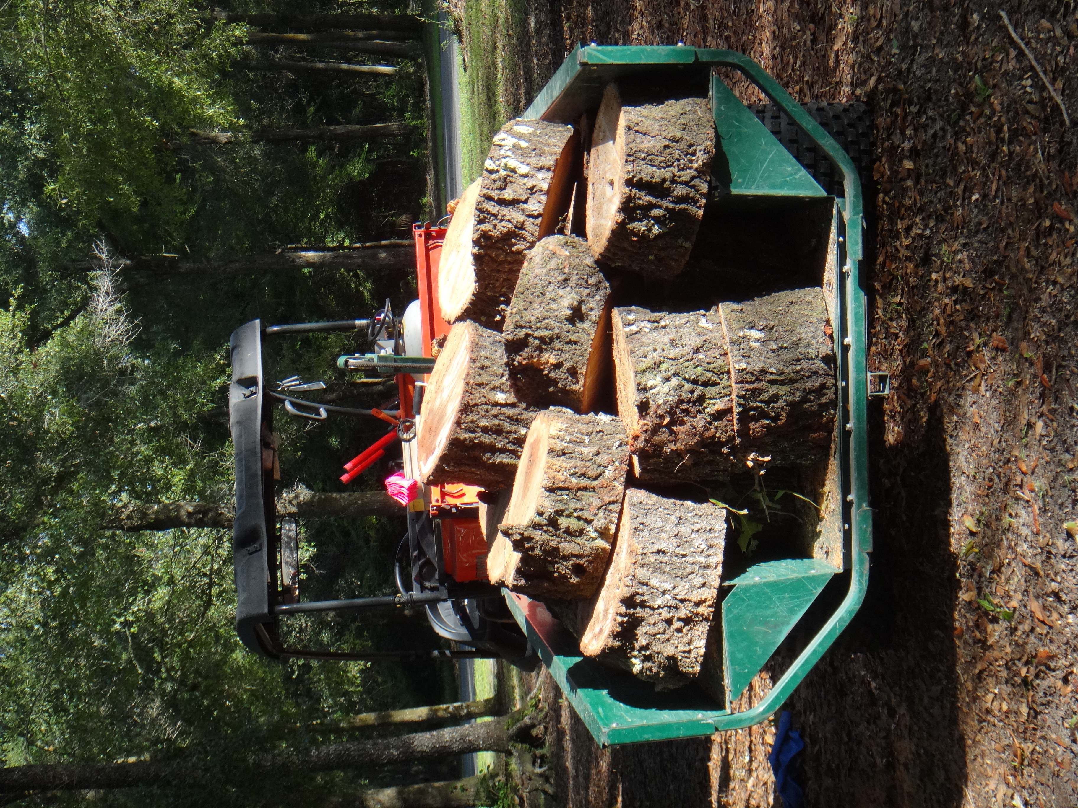

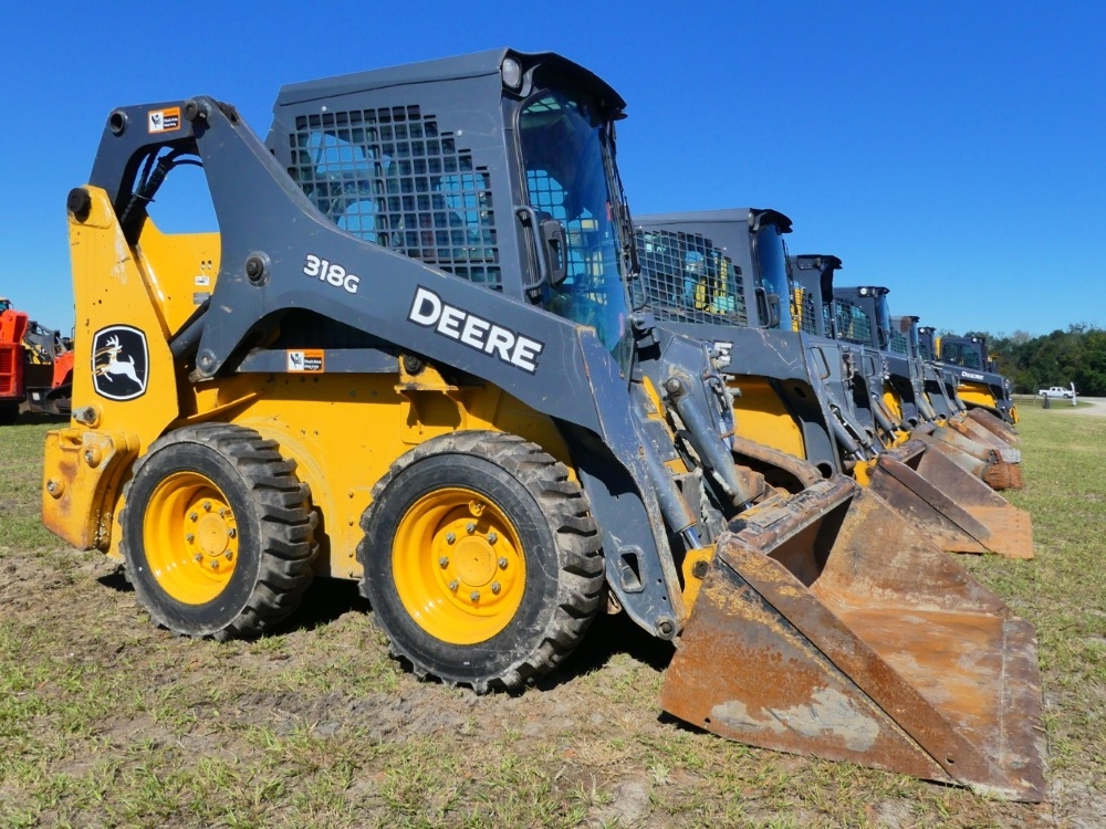

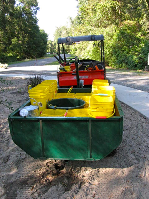

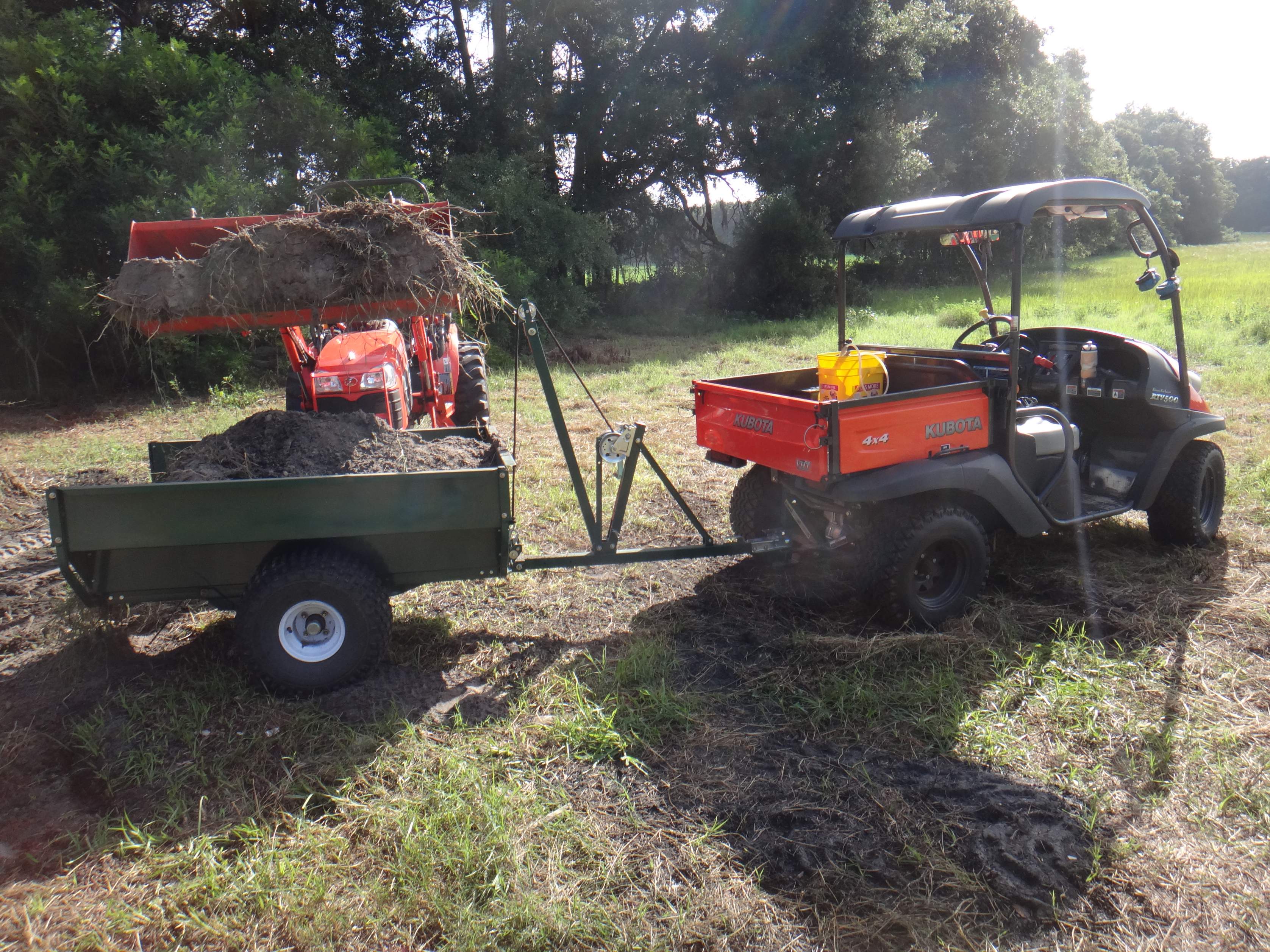

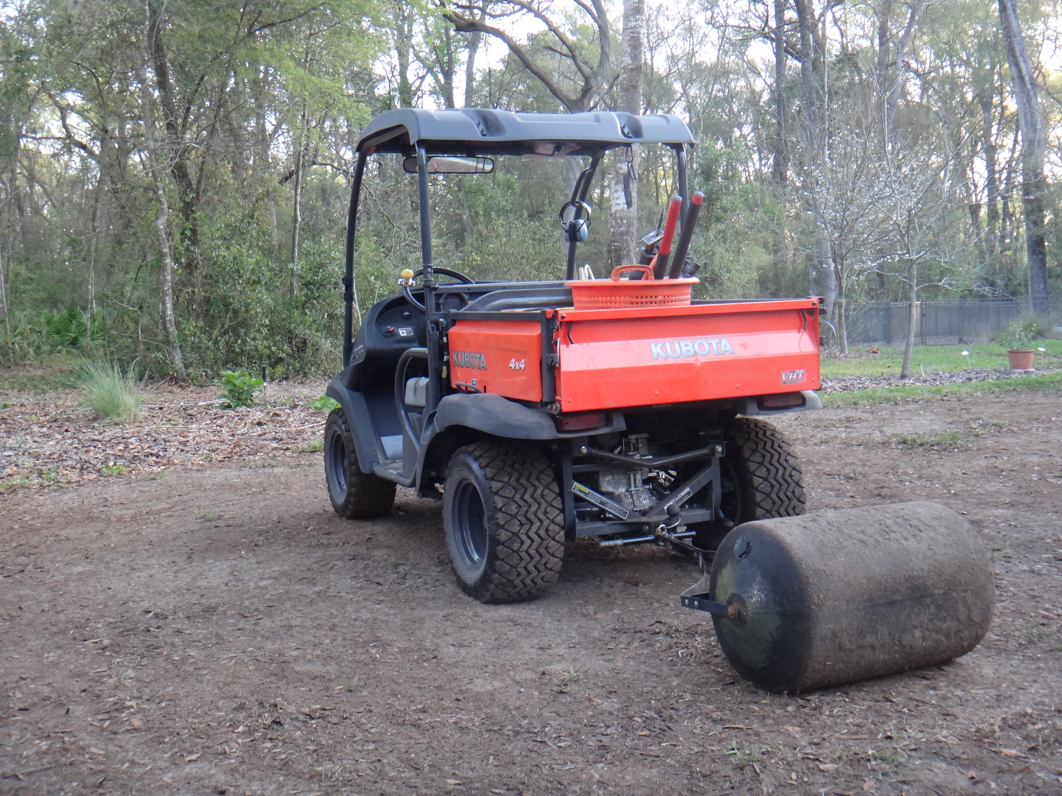

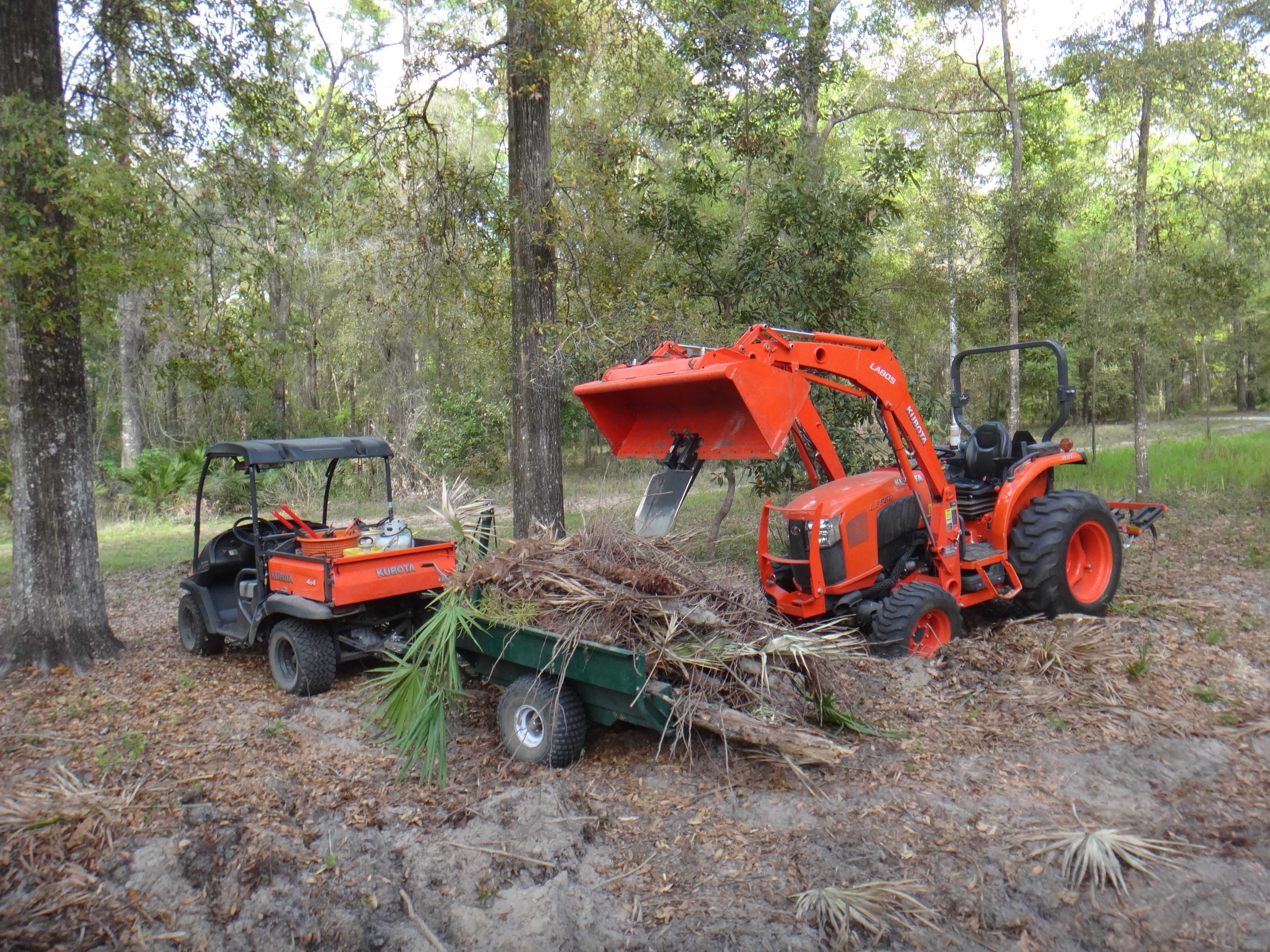

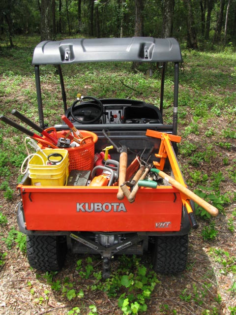

Consider a small Skid Steer as you consider a small tractor. As Skid Steer loaders are much more powerful than tractor loaders, you could omit loader on the large tractor, making large tractor significantly shorter and more maneuverable. For pond work and home construction a rear engine Skid Steer is far more useful than a front engine tractor. Hydraulic drive Skid Steer post augers allow reversal of bit. Mechanical drive tractor post augers rotate only one direction. Sometimes bits get stuck, so reversal is valuable. Skid Steers are better than tractor loaders with a Bucket Spade. (PHOTO #4)
Budget for a utility vehicle early.
