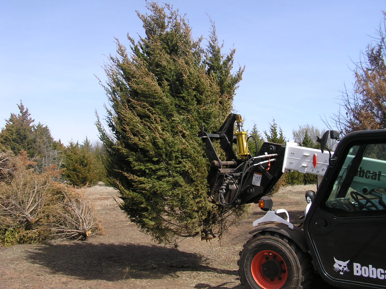

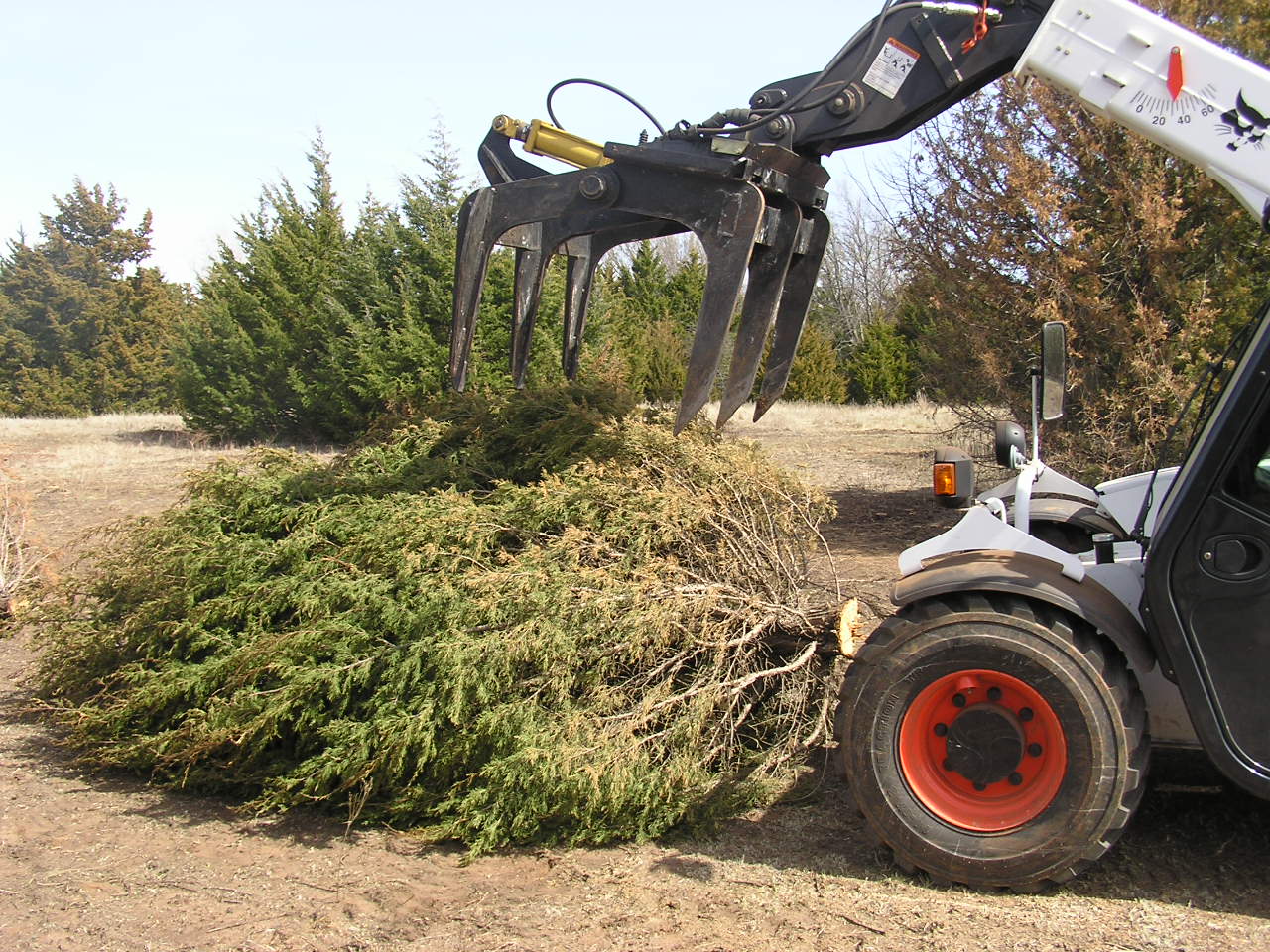

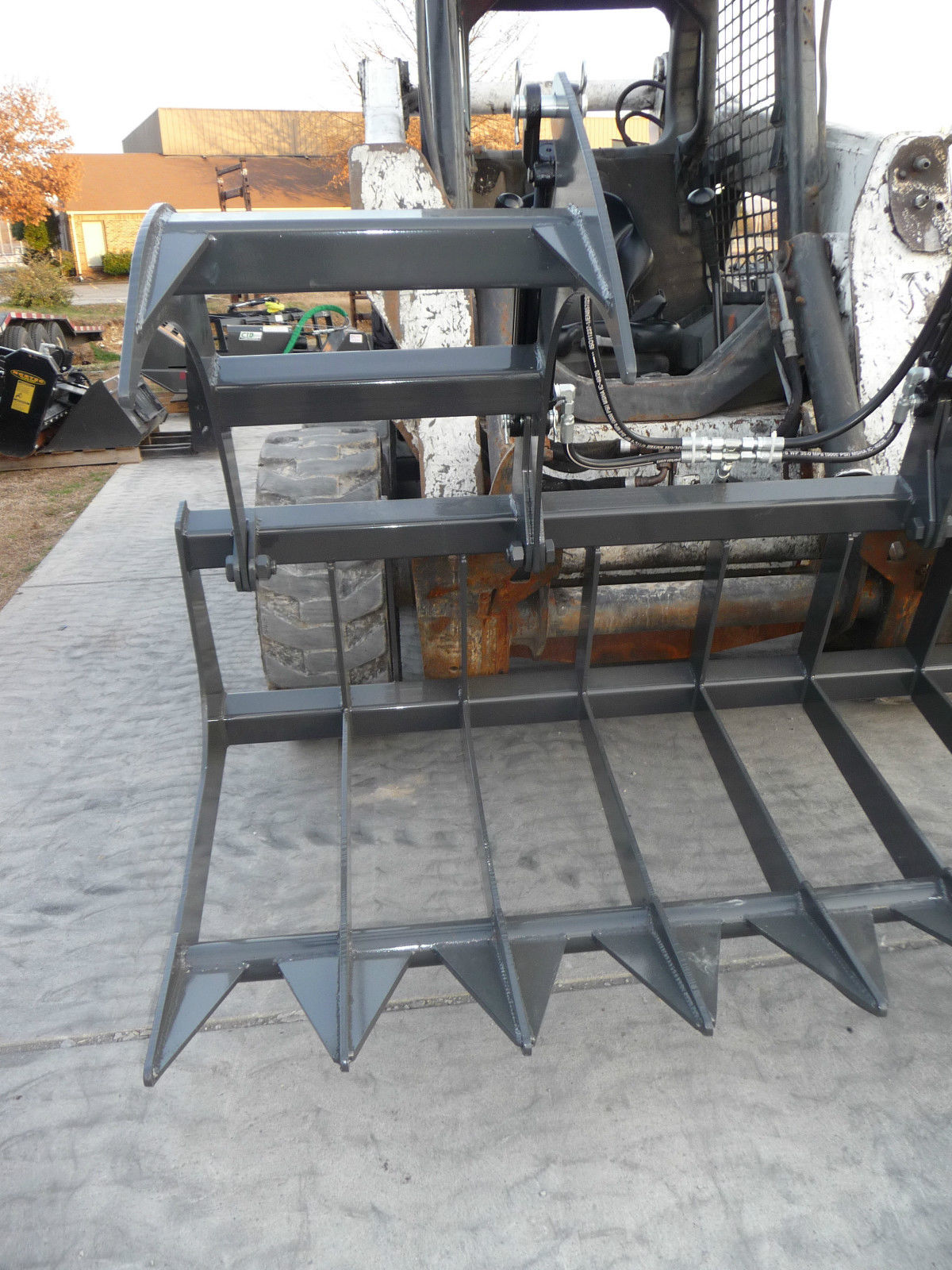

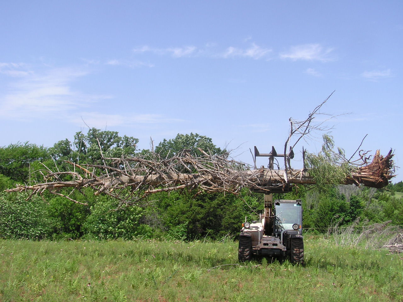

It depends on your main use. You can pick up wide stuff with a narrow grapple.

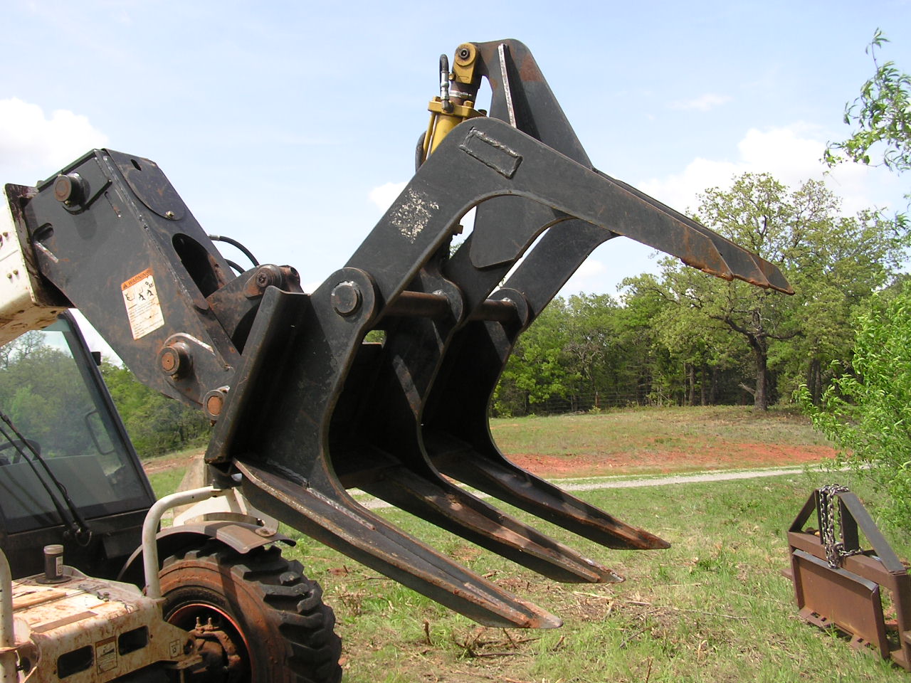

This grapple is 44 inches wide.

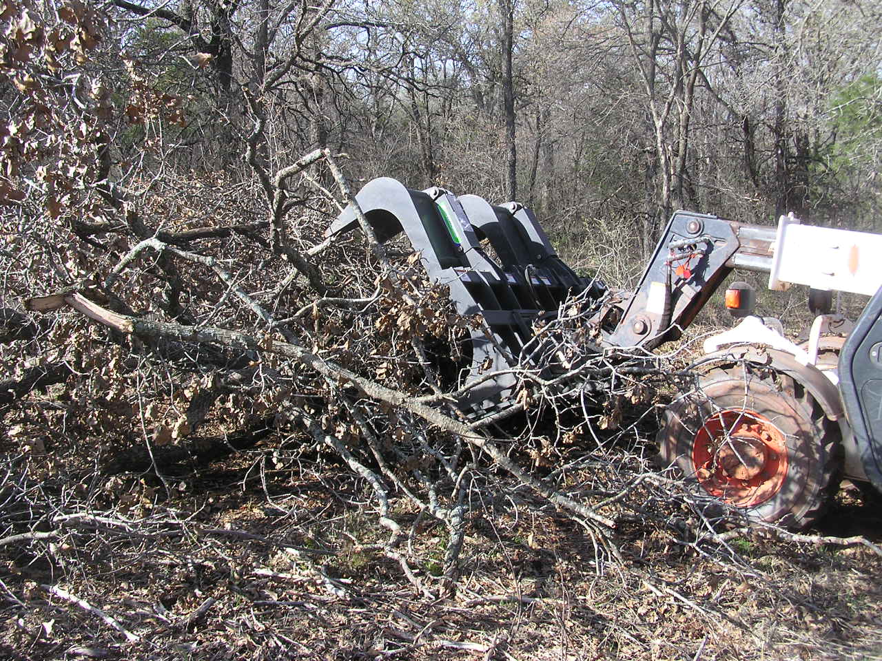

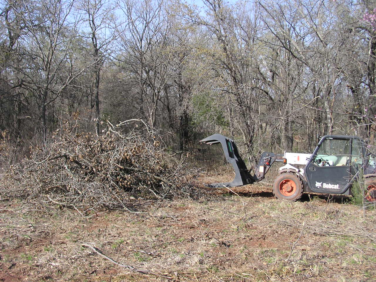

For brush I like to have a wide one, to rake the area to make a pile to pick up.
The 6' wide Monster Grapple opens to 51 inches.

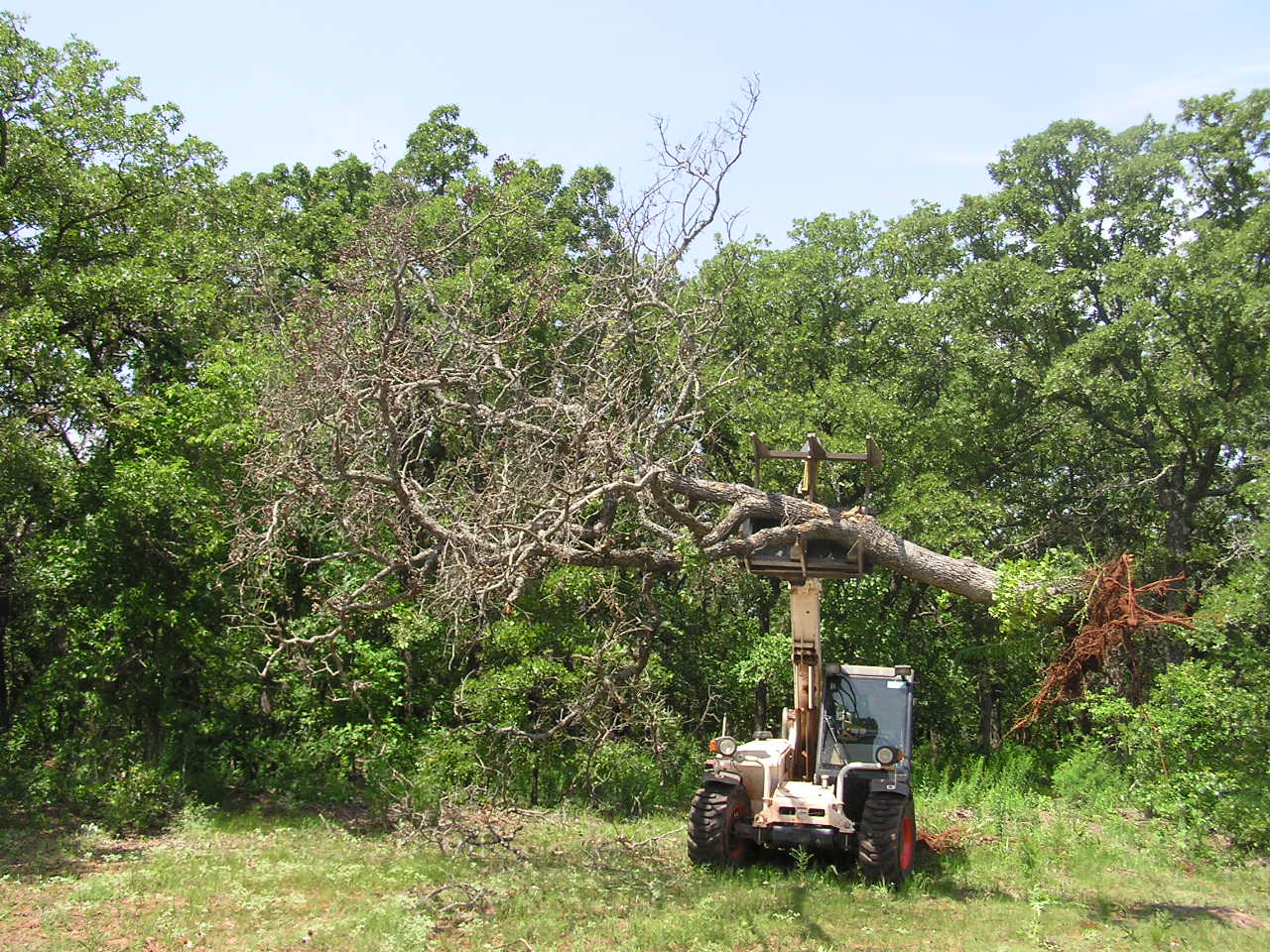

At the brush pile.
I didn't take any pictures of the small brush and sticks that I raked up, but have done a lot of that! :thumbsup:
