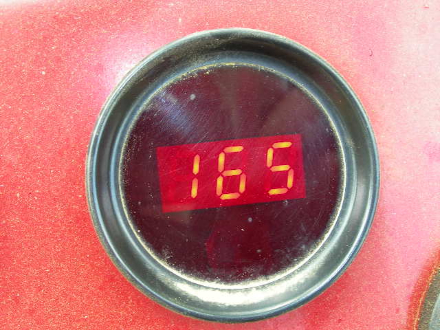

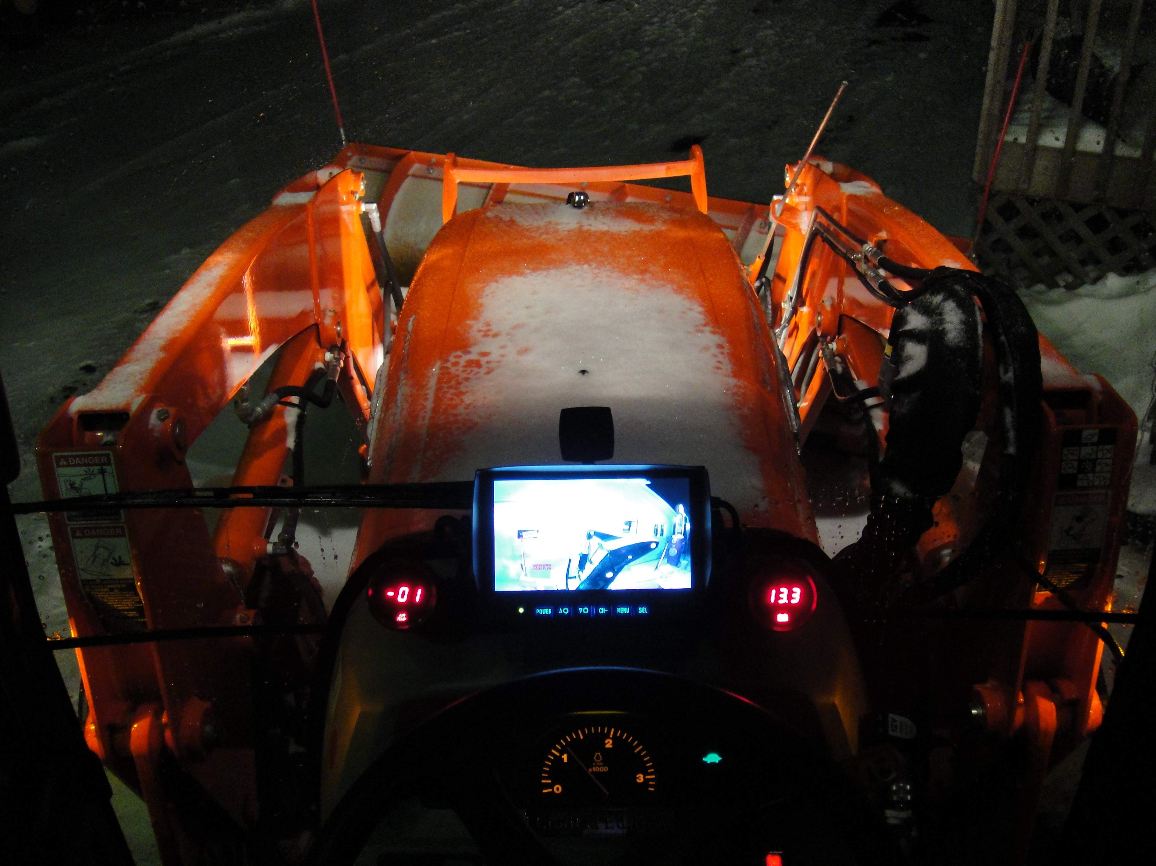

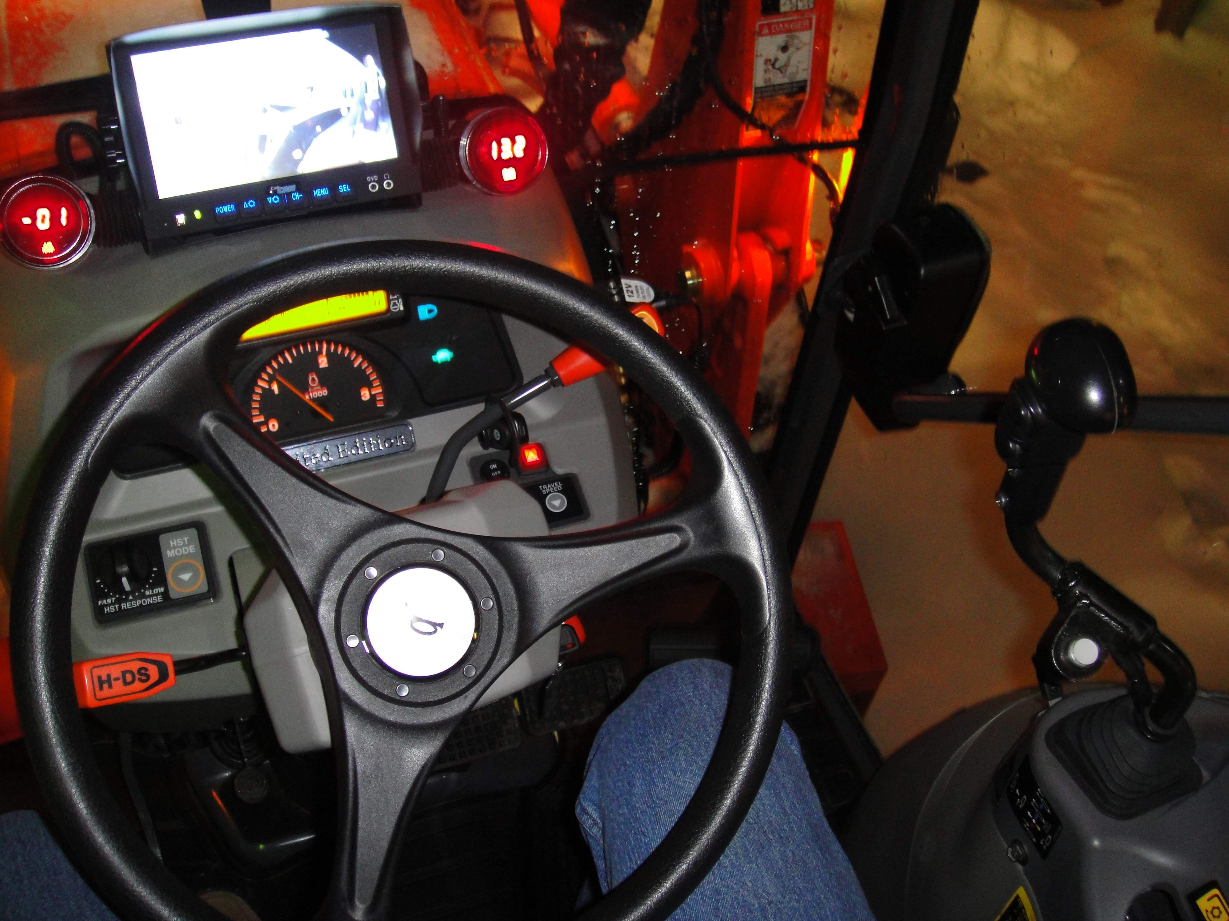

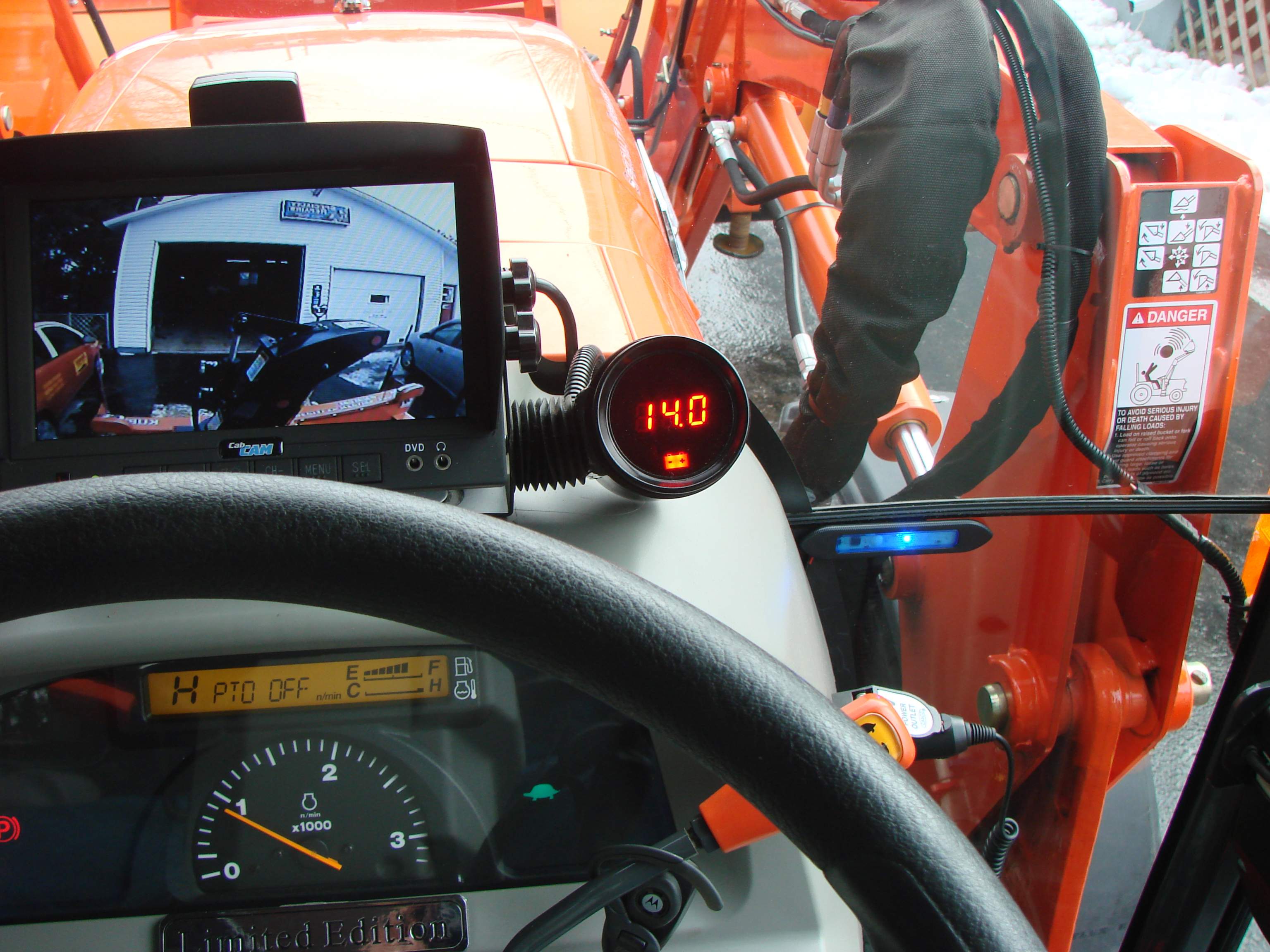

I went with a digital volt meter and it's worked great. Easy hook up as well.

Hey Paul,
What's the white button on the shaft of the FEL joystick? That parking brake light looks good too. I think this is the first pic that I've noticed it installed.
/ Need Help Adding a Voltmeter #43
Hey Paul,
Cyril that white button is lighted and is used to activate the 3rd function valve that I use for the plow angling. Glad you liked the parking light. I don't drive off anymore with the brakes on :eek:
