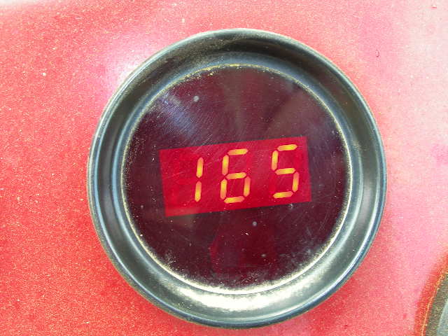

That's why I replaced my gauges with digital readouts and added gauges where there are none.
