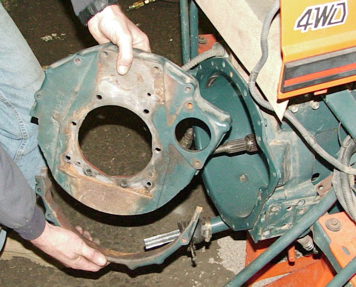

So ar eyou guys saying that ALL 3pt. hoes have to possiblity of breaking the tractor in half or that only 3pt hoes without a subframe have that possibility?
from what I gather from these posts a subframe is tracotr spcific which I pretty much guessed and that MOST ( not all) 3 pt backhoes are universal fit to these subframes. Is this correct?
Forgive our dog and pony show going on in your thread.
Today, if you were to go to your local tractor dealer and purchase a new tractor with a backhoe, overwhelmingly, they will be selling you a subframe mounted backhoe. The reason is, over the years, there have been enough tractors damaged by three point hoes to warrant selling them this way.
Certainly, the odds are against a three point hoe damaging your tractor, but I would still advise you to purchase a subframe mounted backhoe. As an example, when I was purchasing the subframe for my Woods BH80X, the price difference between the subframe and a three point mount was approximately $800. To me, it didn't make sense to NOT get the subframe mount. Your mileage may vary.
/ Need educated on 3 pt backhoe attachments. #24
It's possible that it may be a good way to sell you a more expensive one, I'm thinking..
It's also possible that it's a way to keep from having to warrant broken tractors from the unsupported stresses.
I've seen broken tractors using subframe mounted hoes. Owners manuals of construction TLB's typically call for a complete inspection of all structures at 500 hour intervals and weld all cracks found - and cracks are often found. BH's inflict a lot of stress and damage even with a sub-frame. Surely, you don't think that REMOVING the sub-frame makes the tractor/hoe stronger?

I have a 3PH backhoe that I have had for about 6 years. I don't use it a lot now but used it for most of the first 100 hours on the B7610 I had before. It doesn't simply hang on the 3PH, there is a small frame that bolts to the drawbar with large turnbuckles, similar to the adjustable top link turnbuckle, that go from that frame to the BH. Adjusted correctly you have the top link under compression rather than tension so unlikely to stretch bolts and/or threads in castings. This way the drawbar carries a good deal of the weight of the BH too.
I bought the BH from the dealer I bought the tractor from. I asked them about possible damage from the 3PH mount, having read about it on this forum. The only tractor they had seen damaged was one where a carrier had chained the BH bucket to a trailer when the BH had the transport lock on so the bucket was off the trailer deck then took off down a rough road. The bouncing of the tractor on its tires with the bucket chained down caused the damage. They did not 'know' of any tractor that had been damaged while digging witha 3PH BH.
If you tend to break things then a subframe is the better choice, IMO. If you operate with some finesse and don't just keep pounding on things until something gives then the 3PH style will give you years of problem free service.
This is my experience and my opinion based on that experience. I don't doubt that tractors with 3PH BH's have been damaged but so have tractors chained to stumps.
/ Need educated on 3 pt backhoe attachments. #32
Brandoro, I'll have to agree with you. I've had a small 3-point backhoe attached to my Kubota L245DT for several years now. I don't mistreat it because it clearly can put stress on the tractor. Of the pictures I've seen of tractors broken in half with backhoes, it appears most, if not all, were broken while driving the tractor down or across a very bumpy road or field. My guess is that most of those owners would have destroyed their tractors in just about any manner given enough time.
