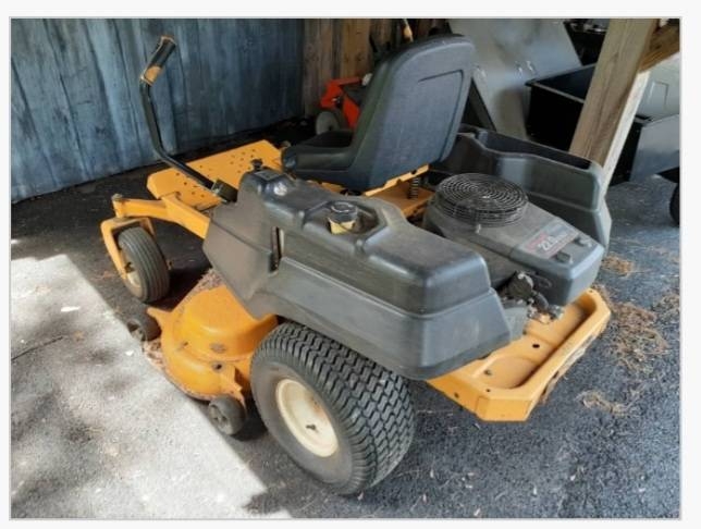

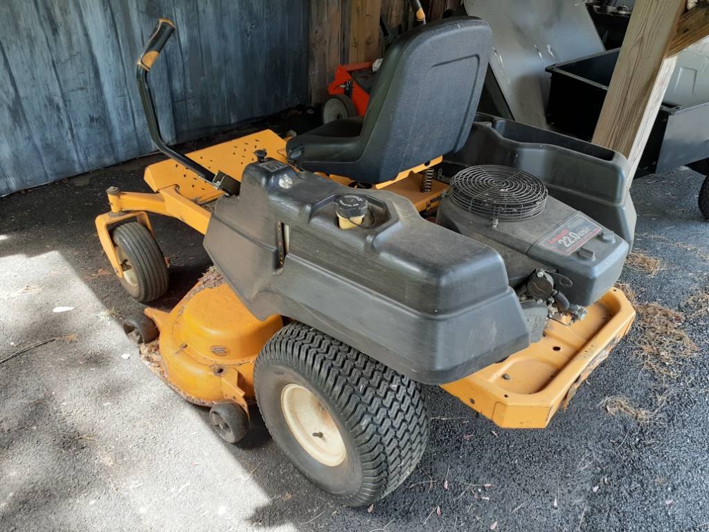

I use this one on hills, bought new about 12 years ago. If real steep I slowly go over, let gravity ease it down. The few times it's gotten "hairy" usually I can control pulling levers back or pull up on brake lever a bit.
If not terribly steep I mow sideways shifting my weight uphill.
It's never ever tipped the least bit. Never ever mow wet...wait at least 2-3 days after rain.
I never mow uphill unless not too steep.
Where it's hard to control is steep down and angled to one side since it wants to go that direction.

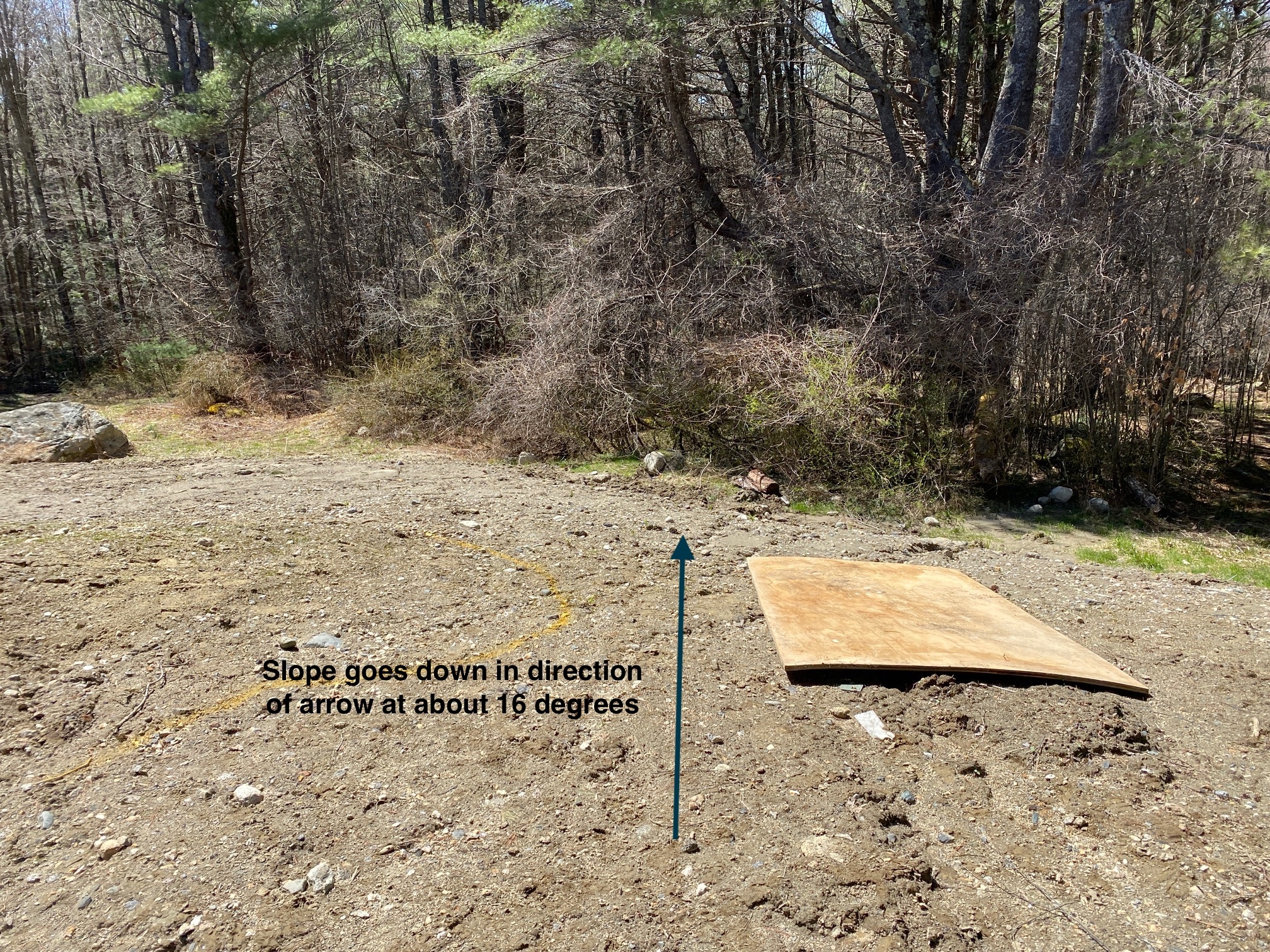

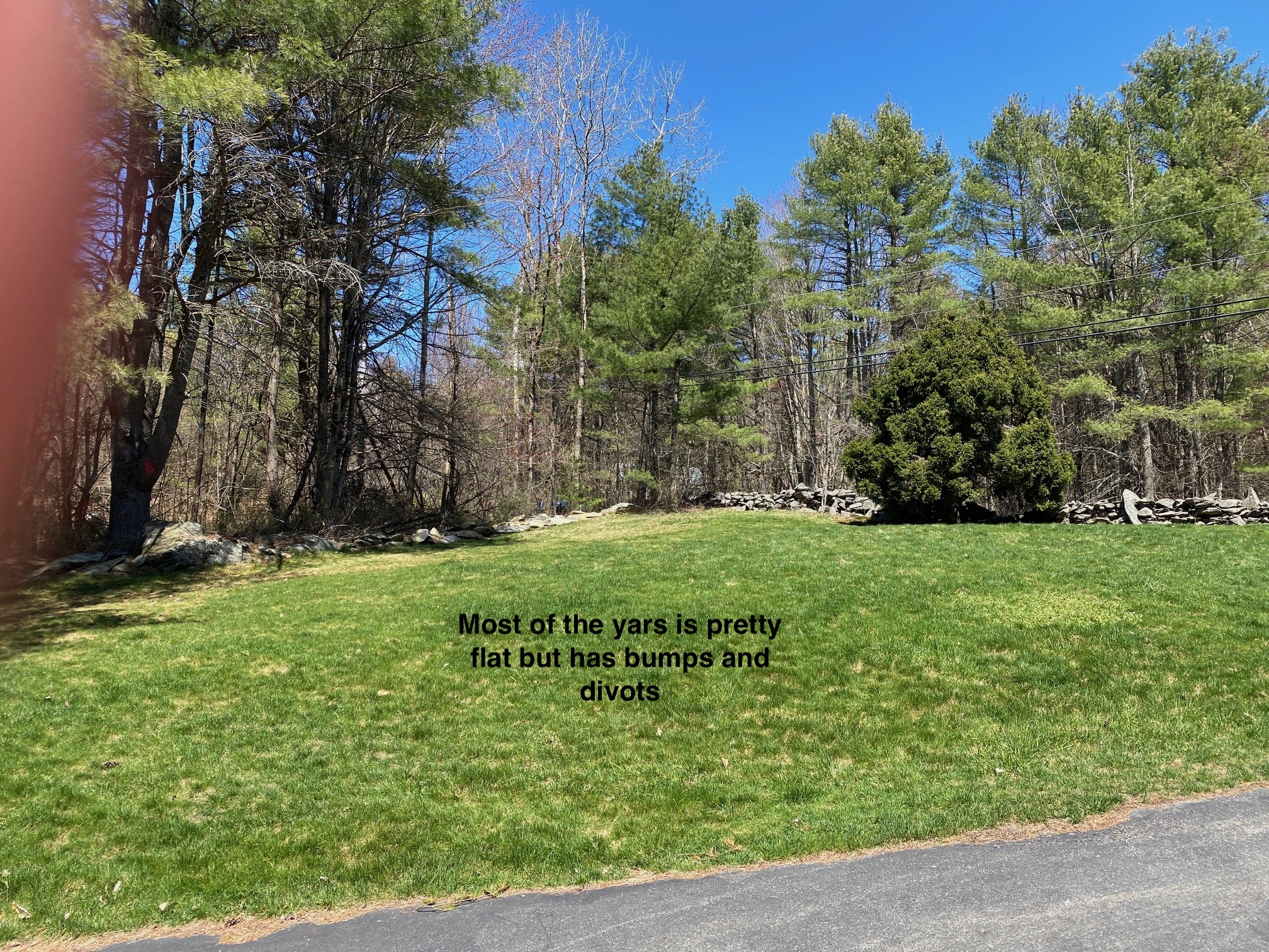

My biggest concern is the uneven terrain. Much of the yard is relatively flat, although it sure has plenty of divots and bumps. But there are two sections with significant slopes.
I attached photos.
The area that is dirt is pretty large. It will be seeded with grass I measured the slope of this area at 16.5 degrees.

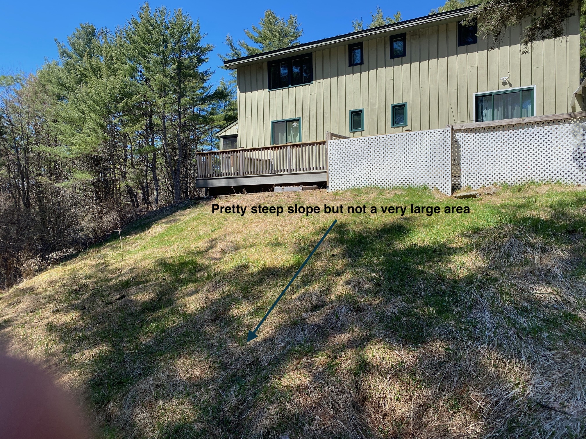

The other area behind my house has a slope of as much as 18 degrees but it's not a very large area.
I've never used a riding mower. I have read that zero turn mowers are less stable, but I don't know if there are things to look for in a riding mower to maximize stability.
If I use a mid mount on my tractor, I might consider putting some wheel spacers on the rear, as I've had some nervous moments over the years. I also feel like a tractor just would be less maneuverable than a small riding mower, so I'm kind of leaning towards the riding mower.
I guess a third option would be to use a riding mower or my CX2510 on the flat areas and use my push mower on the slopes. I could probably handle doing that but that area that is dirt currently is pretty large, and It would be nice to get it with either the tractor or a riding mower. The other slope is a small enough area that I can handle it with a regular push mower.
Those slopes seem steep to me, but I'm hoping that someone with experience can offer some advice.
Thank you.View attachment 863757View attachment 863758View attachment 863759
If you already have a Kioti CX2510 then get a belly mower and use it. It's your best option, especially when you can use 4wd if needed.

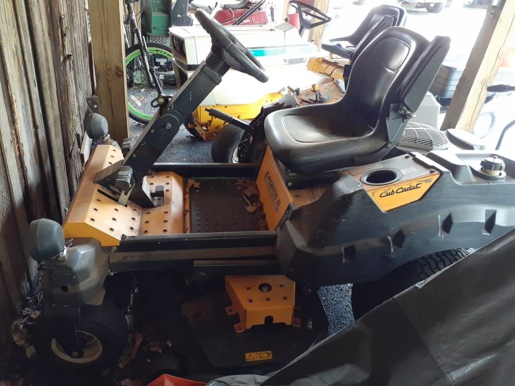

I see from your other picture that you have at least two other mowers - a lawn tractor and a CC ZTR with steering wheel. I thought the CC steering wheel ZTR's were supposed to be made for using on hills. Why do you use the regular CC ZTR instead?
Also, I am curious - how have the steering gear/hydro controls on your steerable ZTR held up over the years? Have you had any problems with it?

No problems with either mower and both work great on hills. The lever one seems better to me on real steep hills because I can ease over the crest mowing straight down. Easy to control speed (very slow), and can pull back a little if it gains speed. Steering wheel one is newer and if I could do it over I would have bought a lever instead. With my wife and I mowing we can knock out a couple acres pretty fast.
I'd shop around but both Cubs have performed well and not expensive.
