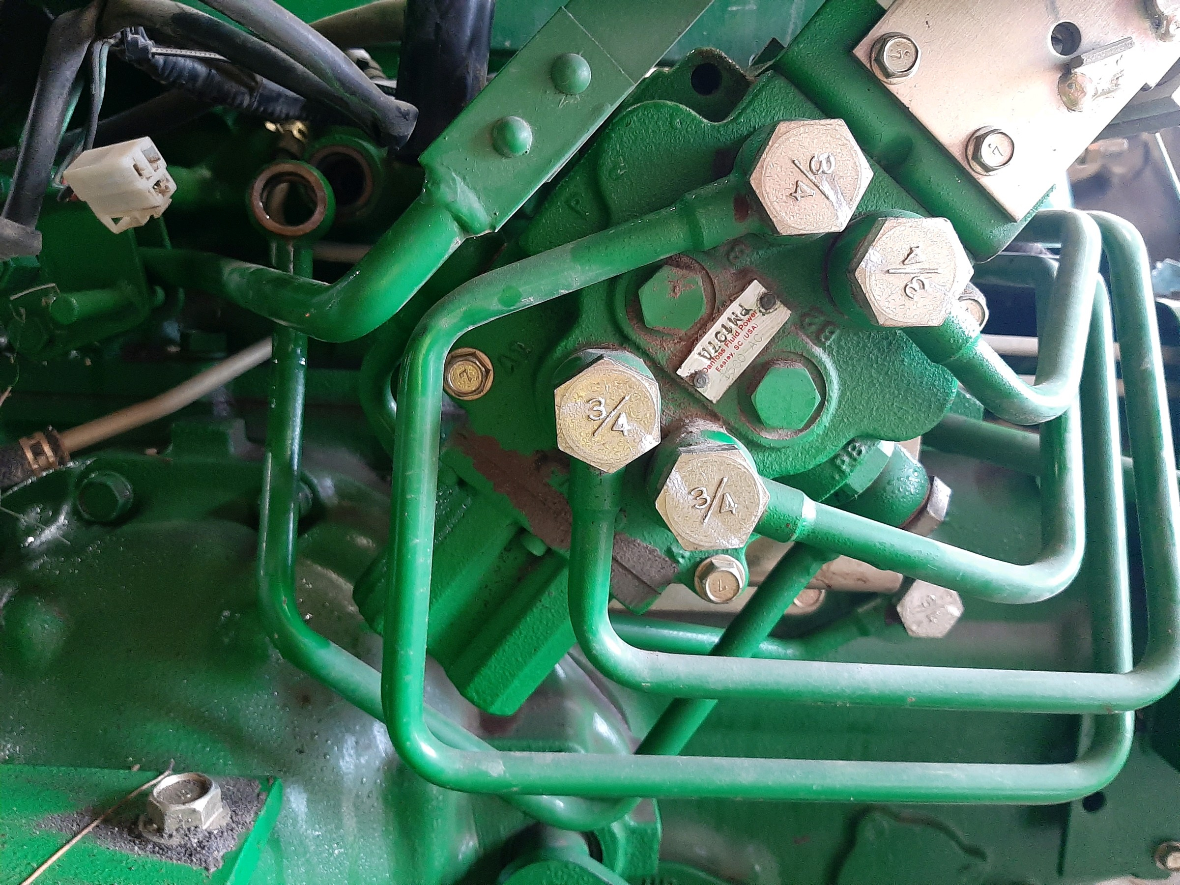

best i can do for a photo my thought add new 2 spool valve before this valve then plumb to JD valve would that work
That should work in theory. The problem I see in your picture is everything is hard lines. That will make it more of a challenge. Also I see a power port, power beyond port but no tank port. Not sure how you will plumb back to tank.

And what is the valve you have the picture of???
/ Need 2 more spools on JD 970 #15
I believe that is his loader valve.
I think you are right. But wasnt sure.
You can clearly see the P and PB ports well labeled.
And the PB line is removed in the photo where it feeds the 3PH.
It really doesnt matter where a new valve is installed. You can remove that PB line and install the valve there.....with the PB of the loader feeding the P of the new valve.....and the PB of the new valve going to the 3PH (where it is removed in the photo)....then pick up a T line somewhere.
OR, you can remove the P line going to that valve.....supply the new valve with wherever that P line is coming from (pump?)....and PB of the new valve would feed the P of the loader valve. Still pick up a T line.
Gotta add a tank line no matter what.
Only difference is priority.
Trying to activate BOTH valves at the same time.....the one that is first in the series is likely gonna be the one to move....until it is out of movement or you let off the lever....then the second valve will do its thing

Photo is of my valve but off the internet it is plumbed the same
