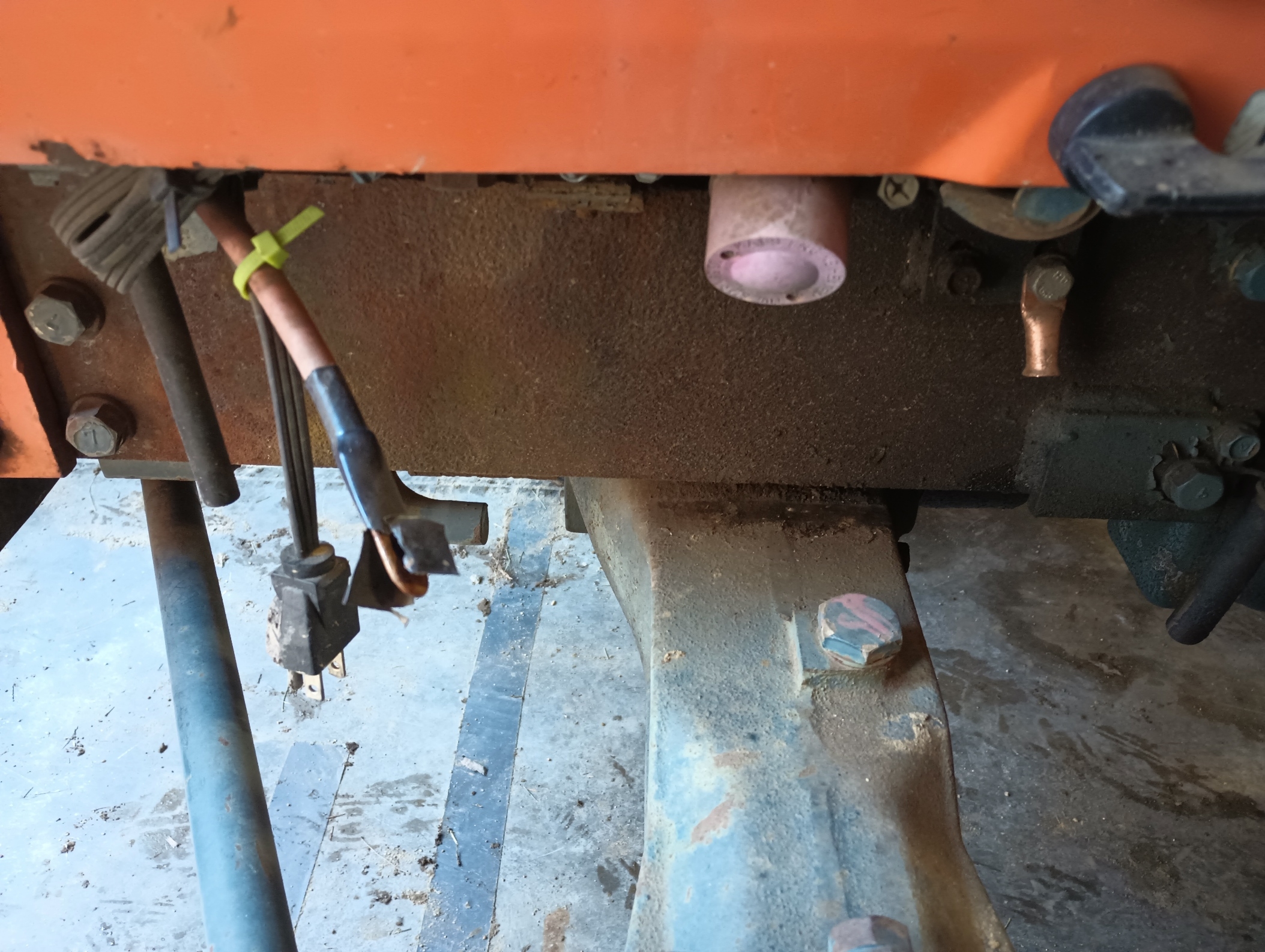

On my Kubota L3830, the battery is behind the headlights. To get to it you have to raise the hood. I'd like to put heavy duty 12 volt terminals on the outside, in front of the grill. It would make it much easier to jump-start the tractor, or to power a 12v transfer pump to fuel up. Maybe some kind of "bus-bar"?
This is what I did for charging my L2250. The positive cable on the left is pretty stiff, it never gets near the chassis. The copper connection on the right makes it easier to get a good ground.

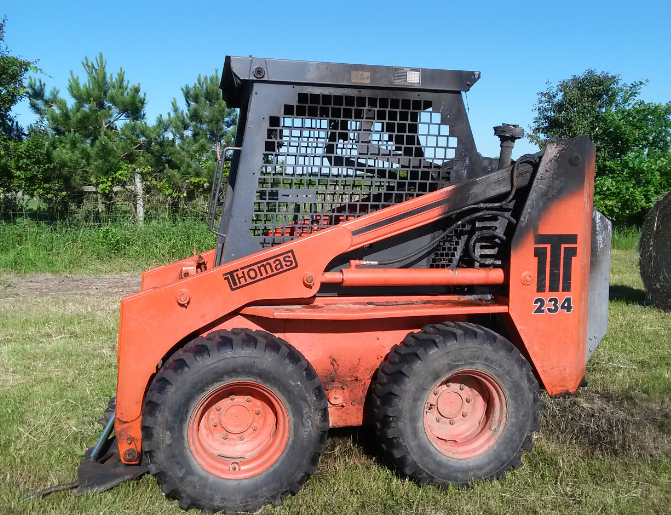

This scares me. I had a skidsteer at work that had a lugs mounted inside the rear door for jumping from the factory. The battery was in a compartment behind the seat. To get to it you had to remove the seat and the seat pan. The insulation rubbed through caught some oil in the bottom of the engine bay on fire, the fuel line burst and the machine burnt. The fire department is 2.9 miles away and is full time which is why the machine is not completely burnt. It was still a total loss.
