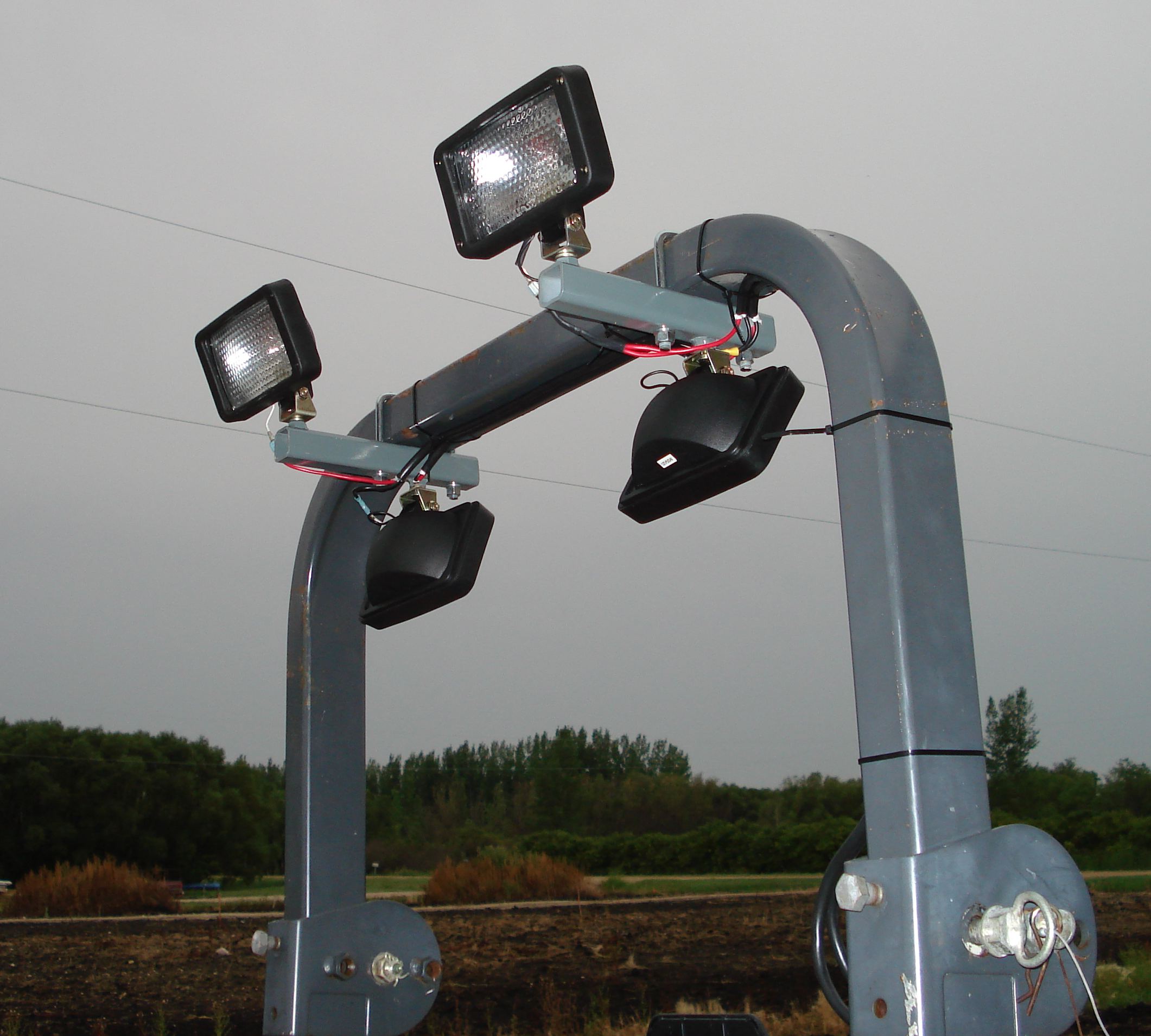

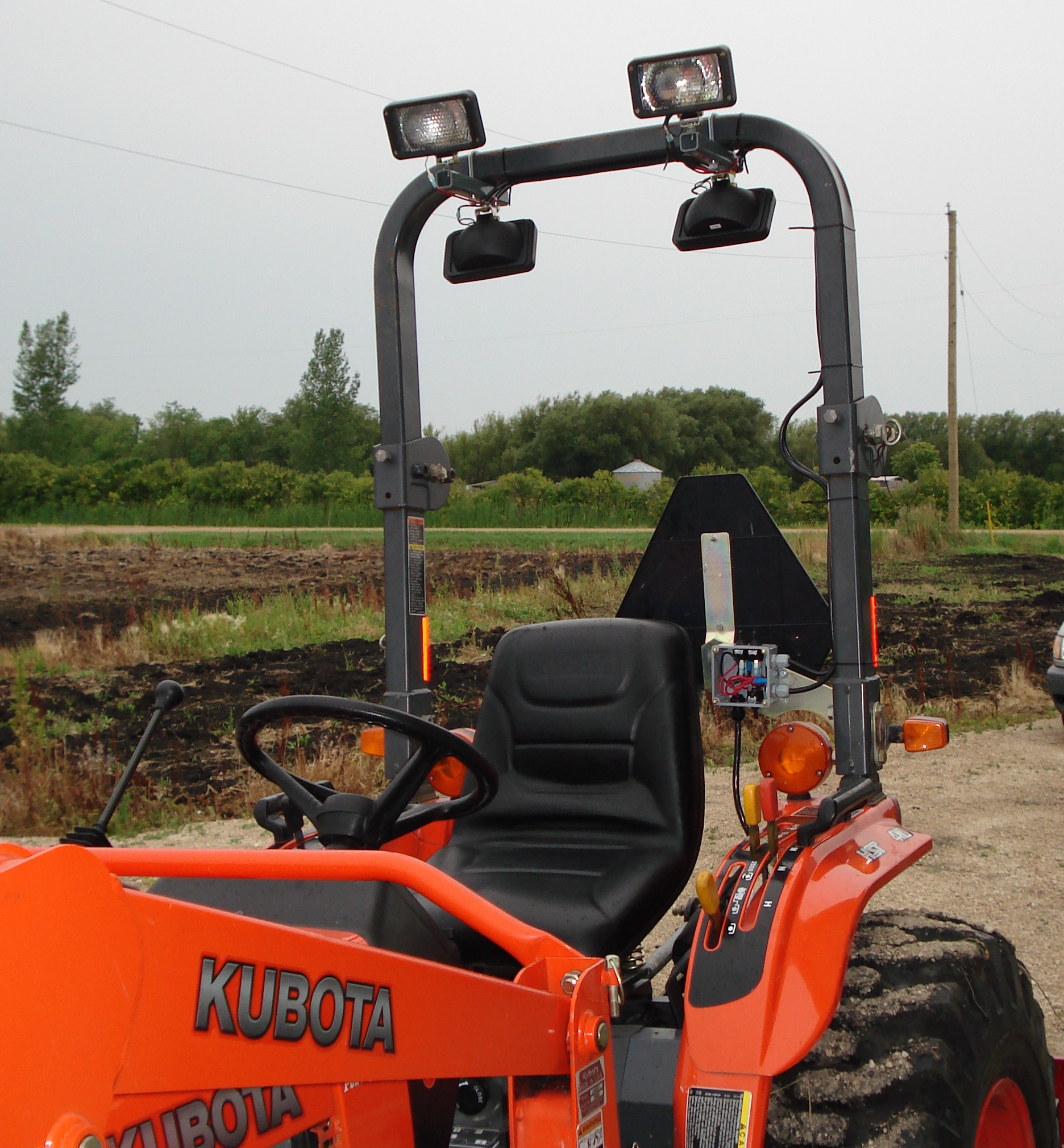

Since I usually just browse and steal ideas :D I thought give back to the community and share some pictures of the light bar I built for my Kubota B7800.
I have two 55W lamps facing backwards (great for snow blowing), and two 55W lamps facing forwards for the added general lighting. The lights are mounted to a piece of square tubing with a nut that I welded to the tubing. The light bars mount to the ROPS with simple U-Bolt over the top. You can easily reach up and adjust the direction of the light with your hand if needed.

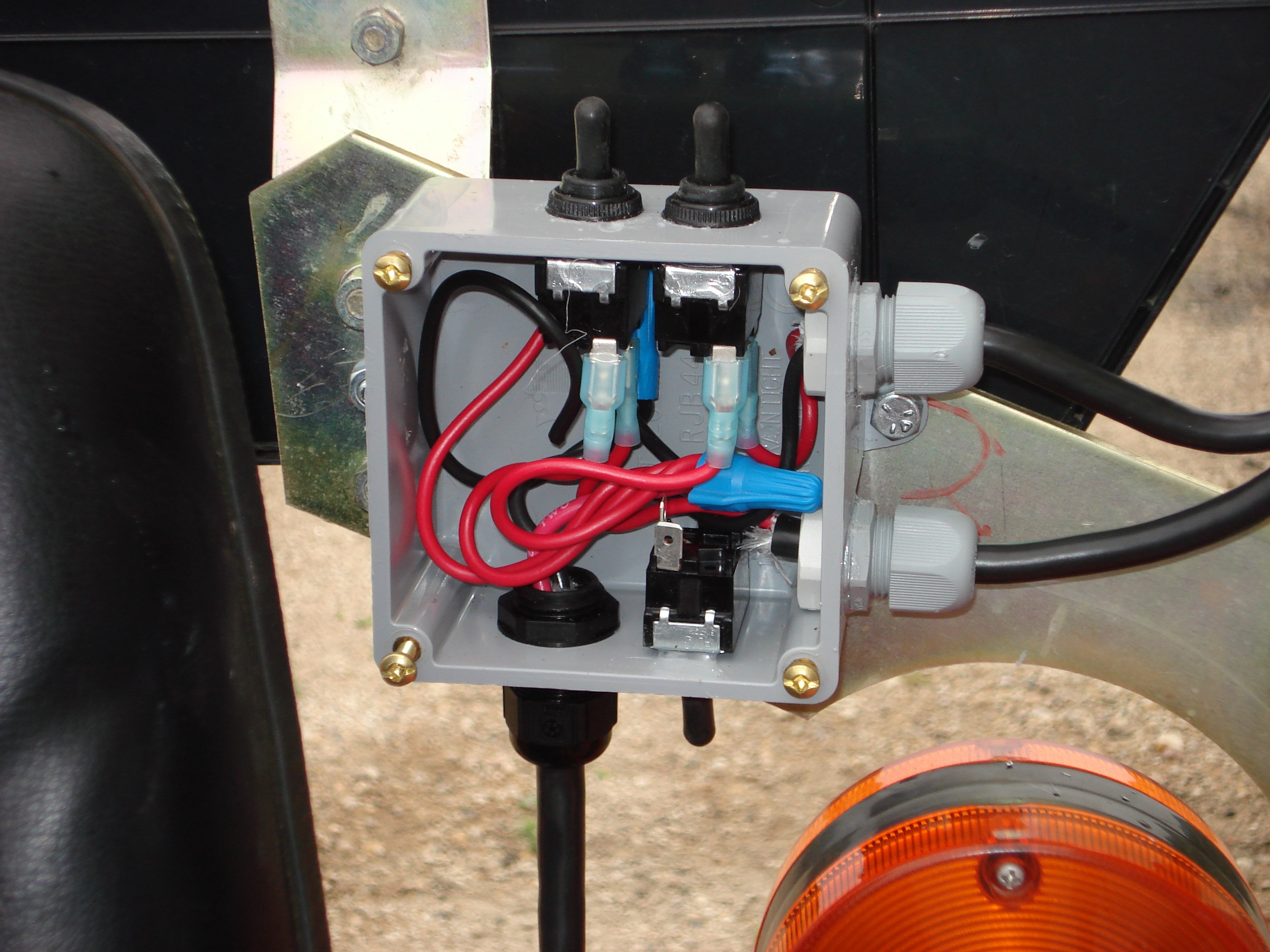

Main power was run directly from the battery (with a 25A inline fuse) using a piece of 12 gauge extension cord. I zip tied it under the chassis in locations I thought it might survive. The main wiring was done in a water proof plastic electrical box mounted to the SMV sign mount on the back. Switches and the wire grommets are sealed since tractor lives outside year round. Top switches control the lights, one for the front, the second for the rear. The bottom switch was intended for a switched 12V source to run the sprayer out the back, I just never got around to mounting the jacks :D
The whole rig was pretty easy to set up and get running and total cost was around 300$ after I bought a 40 amp alternator for the tractor.
I did all this in 2007 and everything still works great with only the occasional burnt out bulb.

Ditto that. Where did you get the box & pass thru pedoricals - is that boating gear? Looks perfect - water resistant and easy to access for repairs or alterations.

I work for an electronics company that supplies the Ag and Construction equipment companies as an electrical designer. We use the grommets on a few (older) products to get wires out without letting the water in. These ones just followed me home one day! :D I am not sure what the real name is or where you can get them but I will see if I can figure that out at work tomorrow and let you know.

With 12-gauge wire, you'll never have to worry about overloading the conductors. :D
Are the switches rated for greater than 10-amp service?

I believe the switches were rated for 20A. I liked them because they came with a rubber boot that seals out the water. I bought them at the local Princess Auto. Can't seem to find them on their web site though.

Looking at the number in the box, this looks to be the box that is being used.
PVC Junction Box 4" x 4" x 2" RJB44
I believe you can get the other pieces that hold the wire at any of the box stores, lowes/home depot/menards. You can find a similar electrical box also as I was looking at the pvc type boxes yesterday since I had read this post.
/ Tractor light bar #12
That looks like a box made by CANTEX. The gasket constantly falls out of the lid if you remove it. A Carlon box has the gasket captured in the lid, and is better than CANTEX's open cell foam type.
