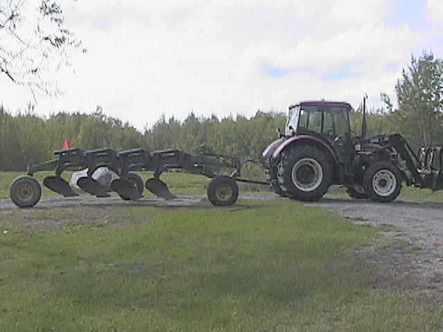

Z-Michigan said:
I think that's too general a statement. Some 6' implements require far more power than others.
There are mathematical formulas that quantify force required by various attachments. This particular plow calculated out to requiring 10,000 pounds force. With the plow adjustability (16" - 18" and 20") force could range 8-12,000. There is a fudge factor constant to accommodate diferent soil types. The Farmer I bought it from had trouble pulling it with his 8,000 lb 2wd tractors so was going back to his semi mount plow which adds weight to the tractor and also puts a wheel in a furrow for steering guidance.
Anyway, I knew going in I was at my limit for tractive force, the price was right (cheap) and it was a one time use. I knew better than borrow a plow because I have a tendency to break everything at least once. I do salvage from the wreckage and create something needed. Be tough to explain borrowing a plow but returning a hay wagon. It pays to have a good relationship with a local blacksmiths shop. :D
