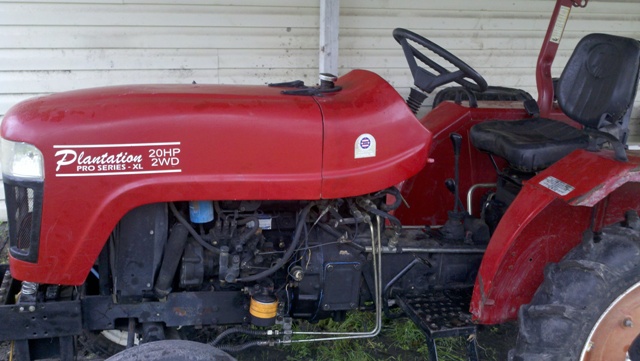

20HP with a collection of implements came up on craigslist. Seller claims it to be a 2007 model. Odd labeling that I can only assume is of chinese manufacturer descent. I've spoke with the sellers wife who doesn't know much about it, he's at work. Anyway take a peek at the pic and see if anyone recognizes it.

Ah so it is a Jinma. Thanks! :thumbsup:

The Grill is labeled JM200, so I'm assuming it's a Jinma JM200
