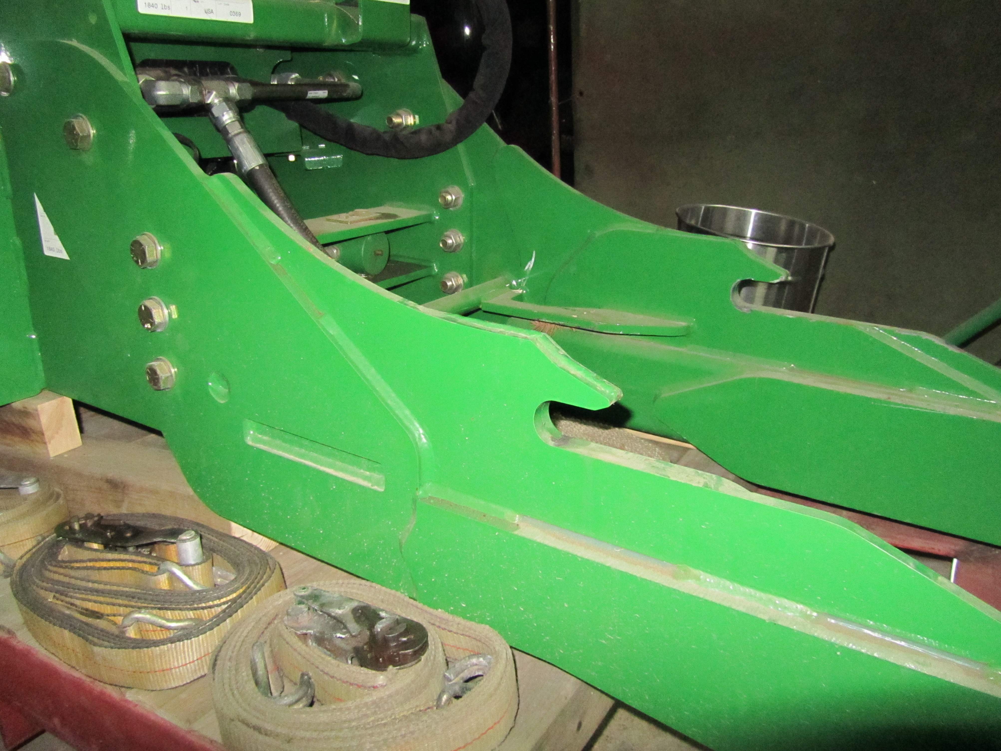

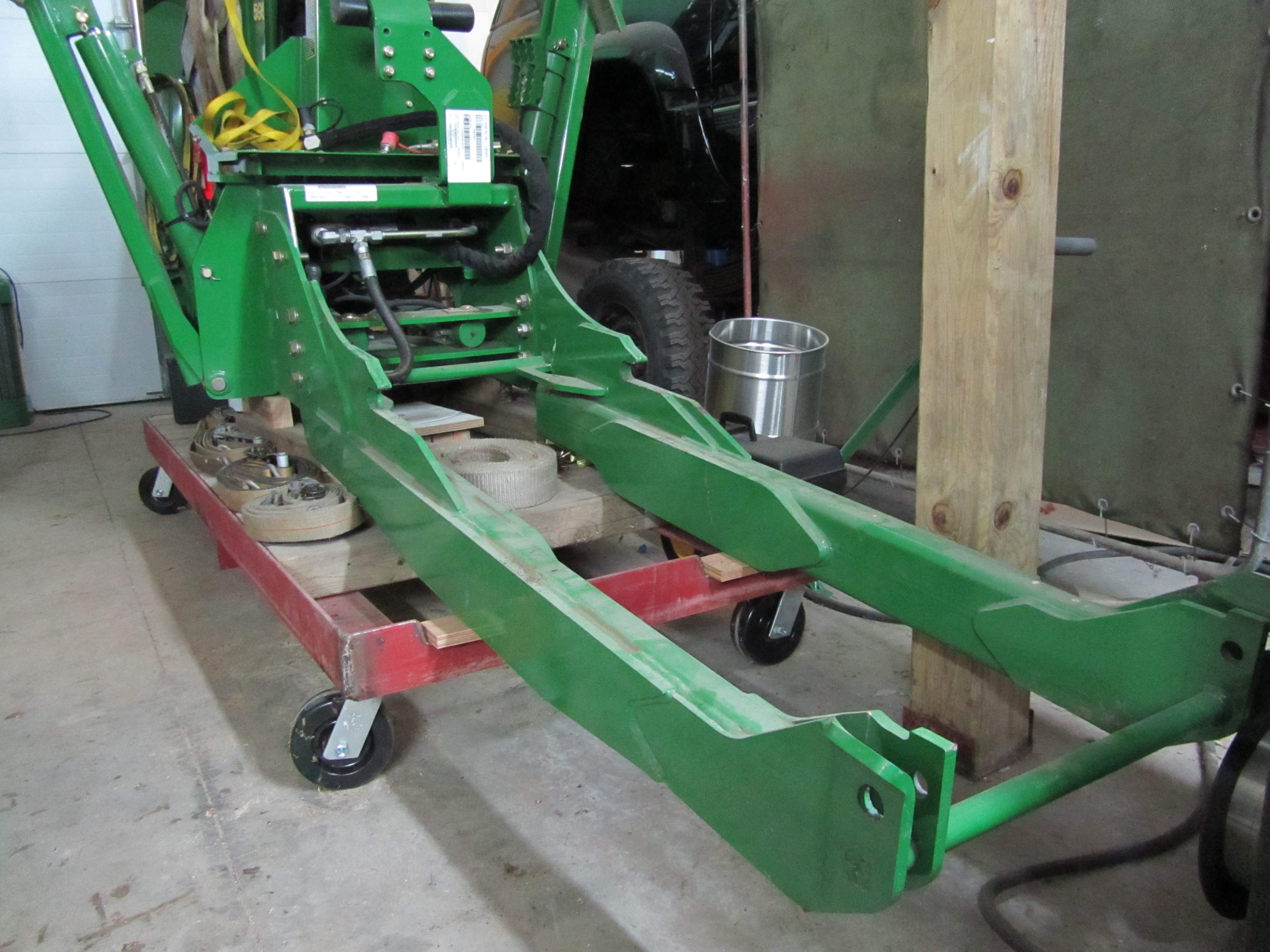

Yesterday my dealer told me that my 5085M is in manufacturing, which means it should be delivered to my dealer next week! :thumbsup:
I stopped by today to pick up my Frontier grapple and loader suspension package. Here is it on the truck.
Getting ready to unload.
Ready to lower.
On the car dolleys.
Closeup of one of the cylinders. I like how they put grease on the rods from the factory.
I also picked up the loader suspension kit for my H260. I plan to install all the "dealer installed options" myself.
Can't wait for next week! :D
