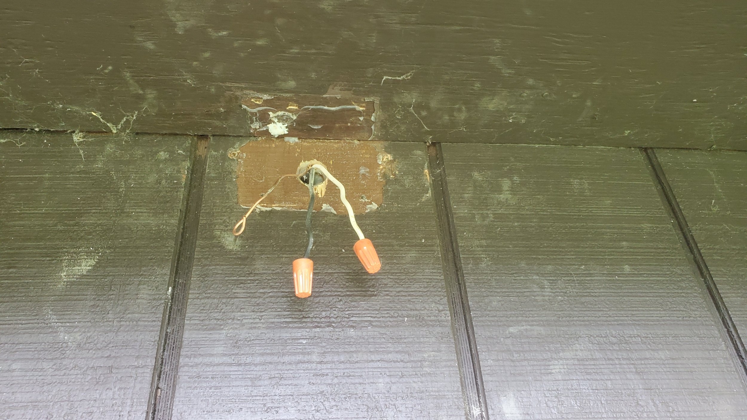

I am replacing an old floodlight setup on the side of my house with a bigger LED light. The problem is after removing the old fixture, I realized the wires coming from the house are not long enough to reach into the new fixture. I was thinking of putting a junction box where the old light was and running wires from there to the new light.
Any better ideas out there?

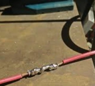

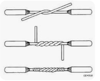

As mentioned, just solder on (properly) some new wire long enough to make the needed run and shrink wrap the soldered connections.

I would not solder it; there are many jurisdictions that no longer allow it due to the problems with insulating the splice sufficiently.
I would use new wire nuts for the correct wire gauge totals. Pretwist the wires, and then put the wire nut on. I prefer the versions that have "ears" for easier tightening. YMMV...

If you're going to put a new junction box in, why not fit it a bit lower and add an external power socket
Thanks
Dave
Do you have a picture or link for the new light?
