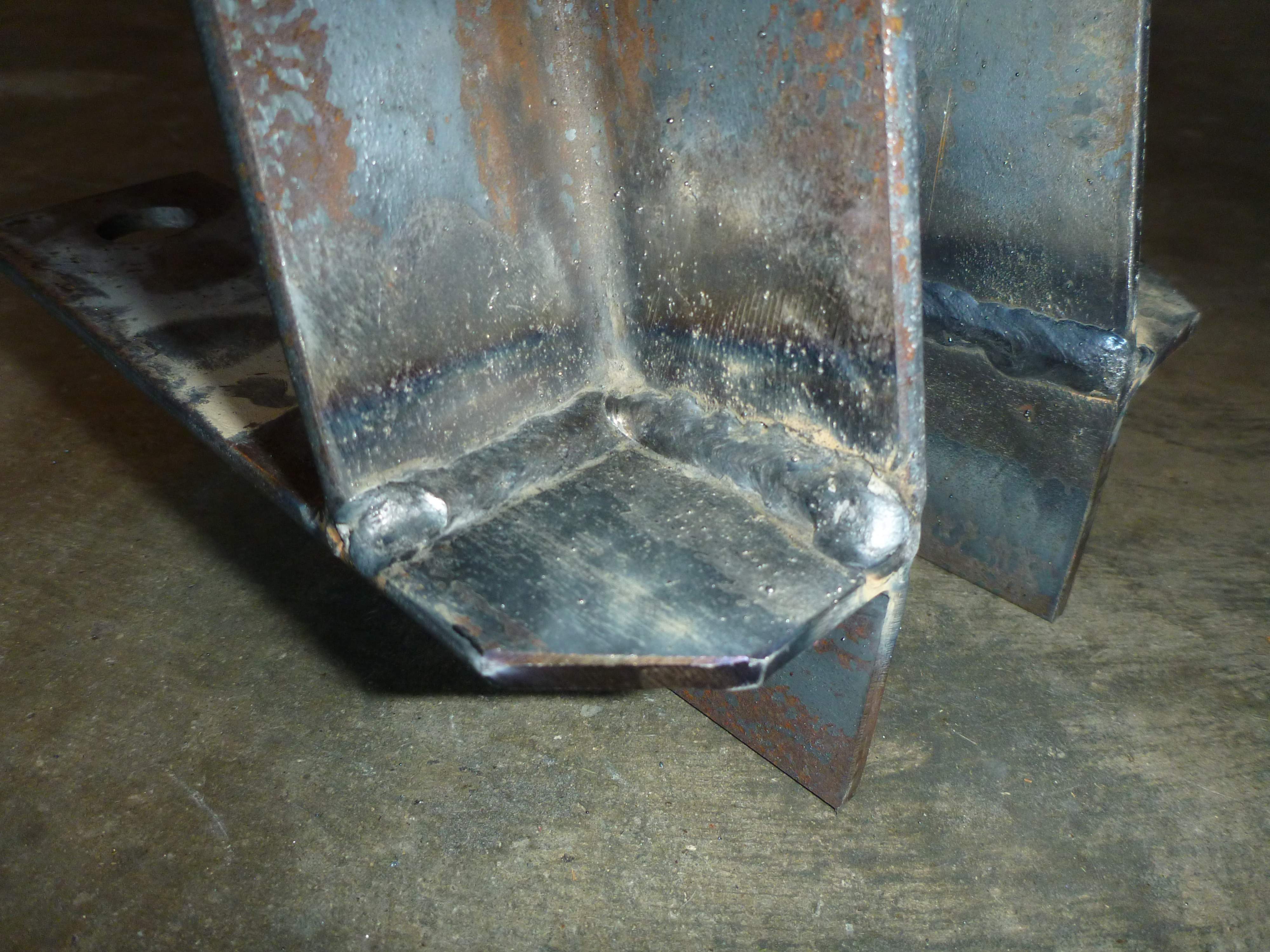

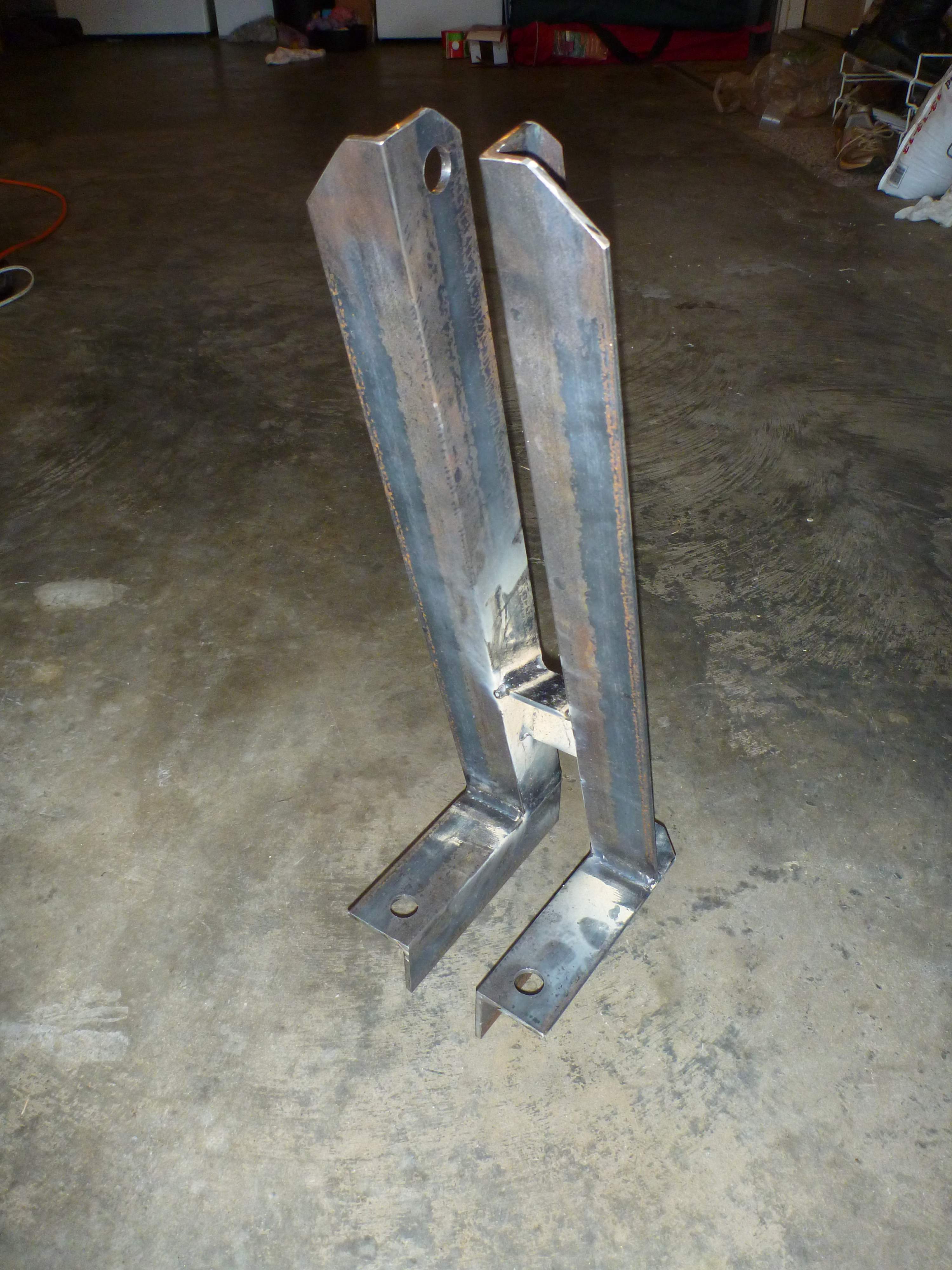

I have been doing some more welding. I finished I project that I have had in my head, but what is it? Any guesses? I will picture it assembled after I paint it.

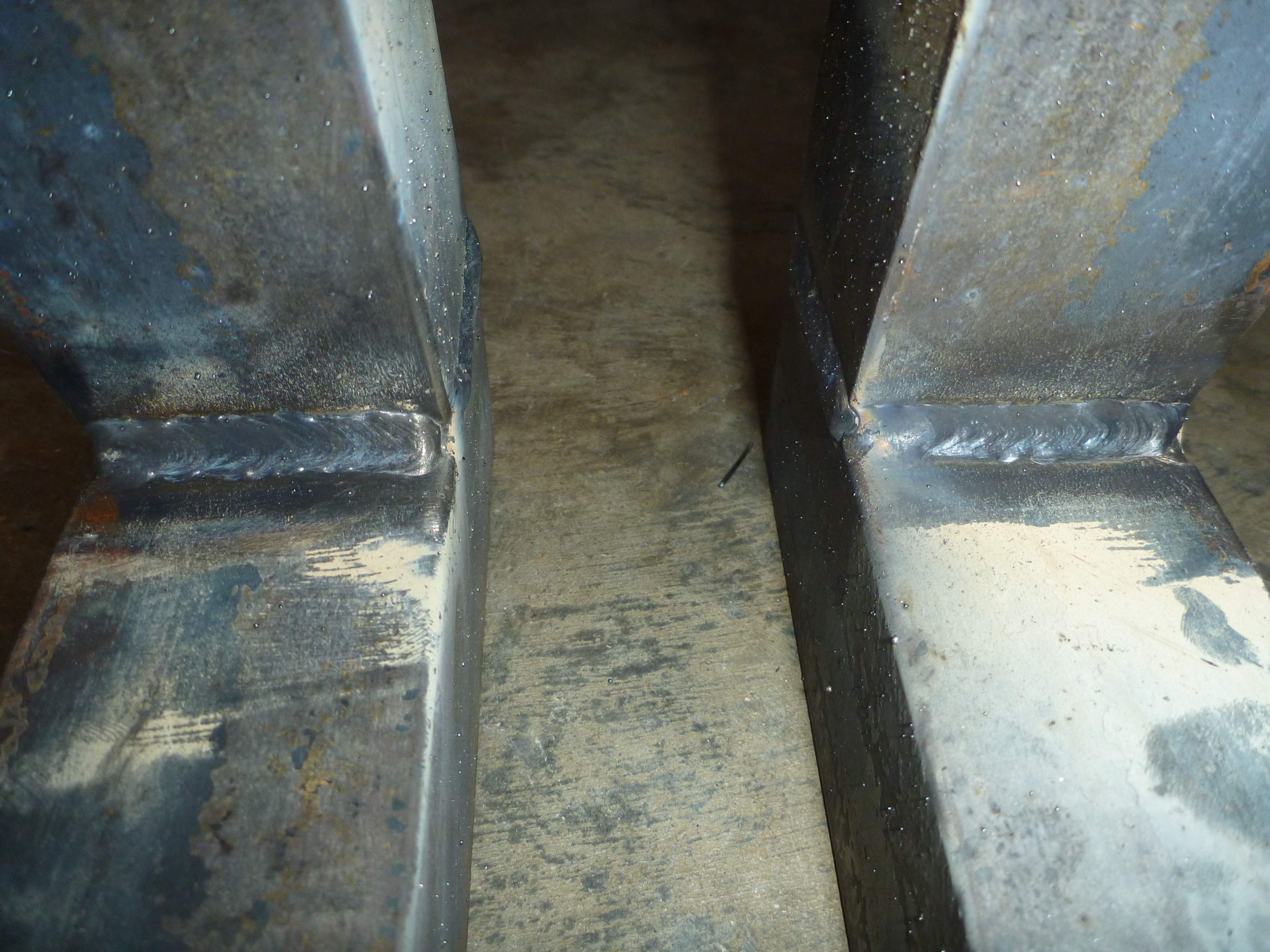

I also will show some of the welds that I did. Some of them have some undercut. I have seen people try to show what undercut looks like in photos, but I believe that is much easier to spot in person. I believe that some of this undercut could be solved by pausing more at the end of my zig zags to deposit more material. I lowered the voltage slightly on a few welds and they looked a little colder with more material buildup. shown below are some of the better welds.
In the one picture, the slag makes it look like cold lap to me except it looks like undercut in person. I need to clean the weld up a little more. It is a little hard to get in there.

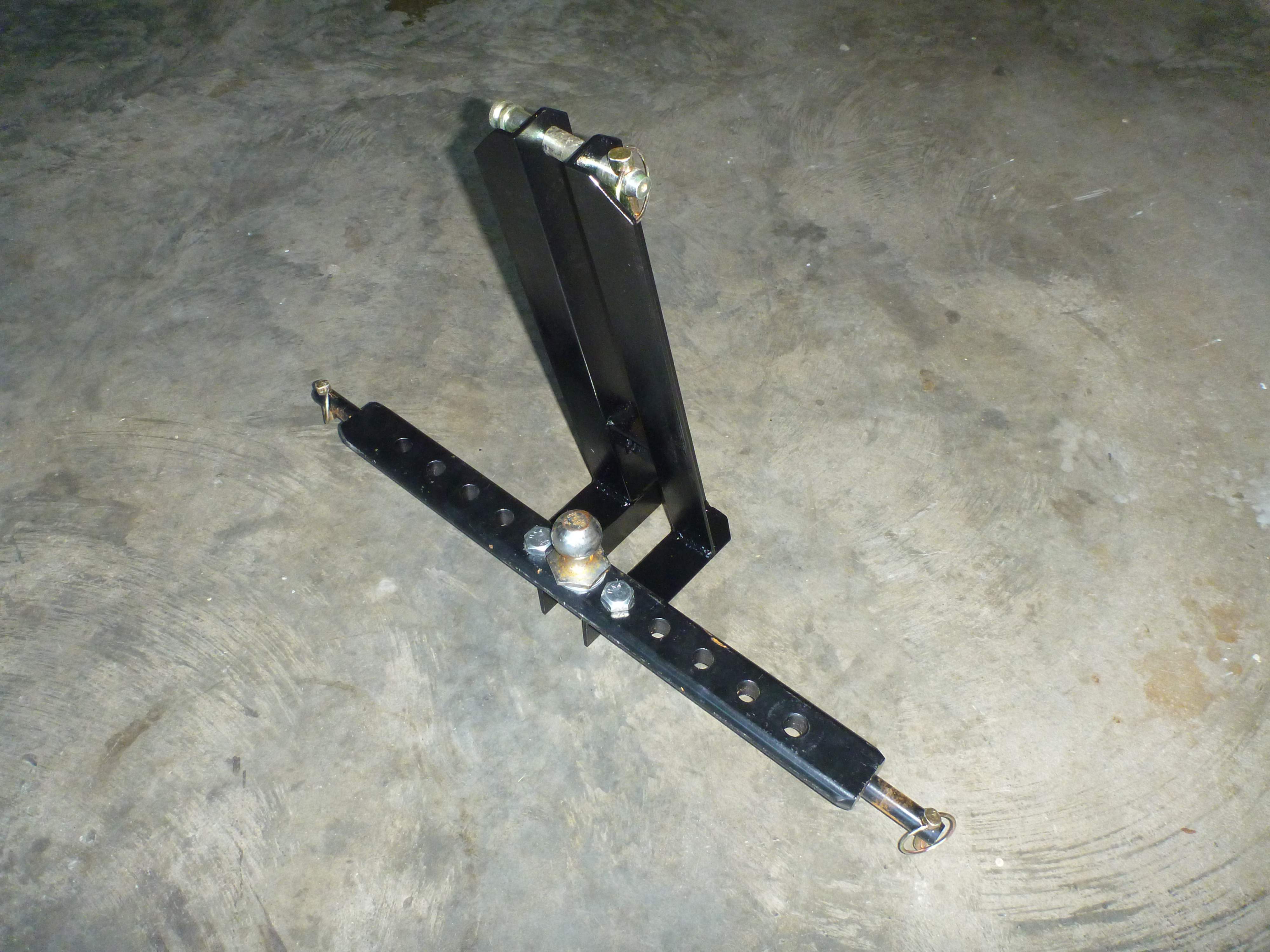

No guesses as to what it is? I guess a finished picture will help. I angled the uprights forward so that I would not have to adjust my top link so much compared to my other implements. I should be well overbuilt compared to the torque that is applied to the drawbar.

Lookin' good! What are all the holes for in the bottom bar?
Good looking setup. Your welds are coming along real nice.
