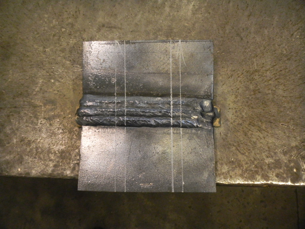

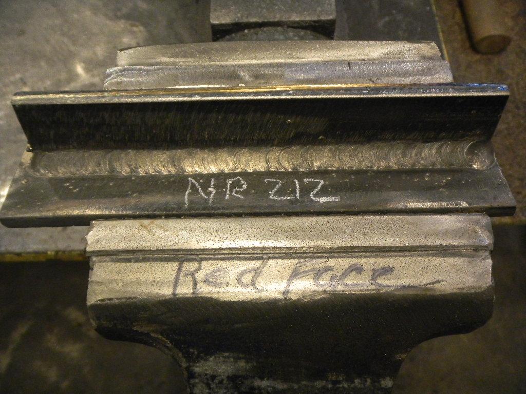

What self shielded wire are you using?
Every one of those welds, you were either traveling to slow. Or you are still to cold.

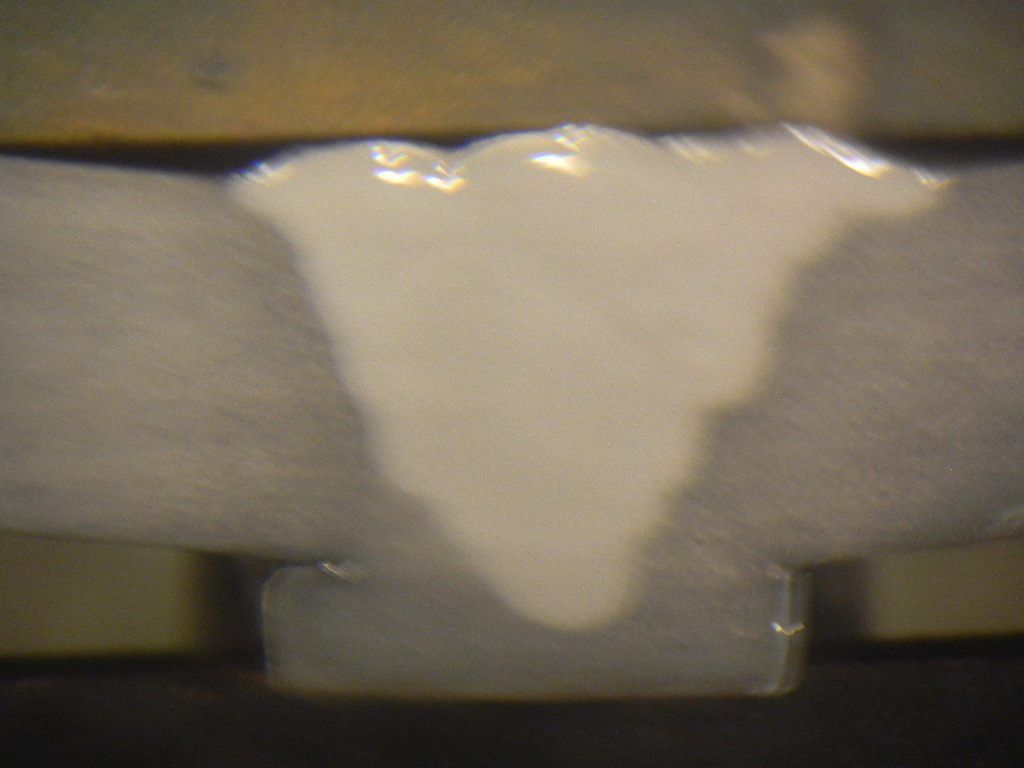

You want it to more like this.

It is .035 NR-211-mp. I am pretty sure it is too cold and I probably going too slow.
/ My Welding Projects #4

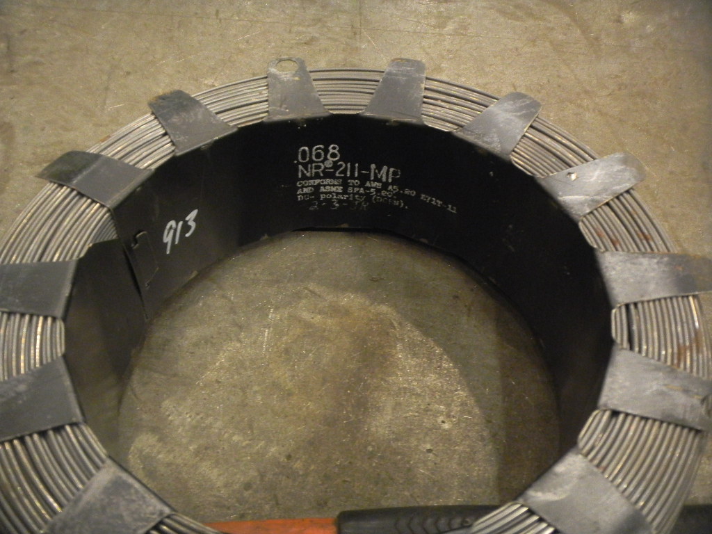

For years all we got on the job site was NR-211, or Hobart's 21B.
If you're not traveling to slow, then start turning up the wire speed, then the voltage. When you turn the wire speed up, and the wire wants to bounce into the puddle, turn the voltage up some.

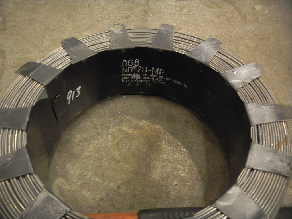

I found some NR-211 in my Dad's barn. I took this wire off a job site in the 1980. The wire even had some rust on it. But it ran fine.

I had my wife look at the readout as I welded. She said that it bounced around 140-160. This is supposed to be too low. This is with volts at 19.5. I upped it to 20.5 and it looks better.
I have the ipm at 264. I have measured it with a tape measure and it seems to measure about 25% slow (indicator higher than actual). I am using a flux core roller and the spool has minimal friction.:confused3:
The last two welds at the bottom are with the latest settings and straight drags. Please disregard the top four. My form was not great.

With NR-211, or any of the T-11 wires I run about 3/8" stick out.
I was running about that and was getting spotty slag on the welds. One of the Lincoln videos says to increase the stickout to bout 1/2 to 5/8 to get flux preheating.
https://www.youtube.com/watch?v=iD7Y57gK3yU here at 5:15.
Going to about 1/2 seems to give me good slag coverage.
/ My Welding Projects #10
Give it a try, that small of wire may have a tendency to dance on you tho.
Generally with any T-11 wire if you get spotty slag coverage, means you have to much voltage.
Here is what the slag looked like on that NR-211 wire I found in my Dad's barn
