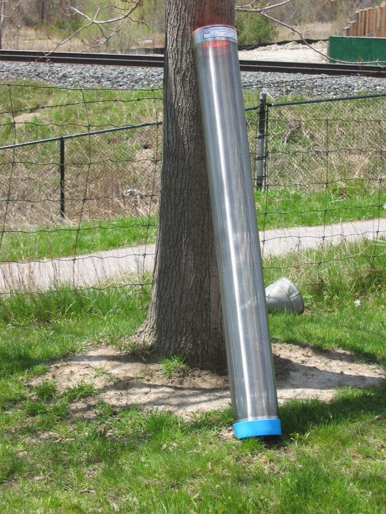

Starting with well basics you have one of two types of well:
  1. Open Bore Well: the well was drilled and cased down to rock, then the bore (hole) was extended into the rock. Fissures in the rock let the water enter the well to be pumped out.
  2. Screened Well: The well was drilled and a screen was inserted out of the bottom of the casing, or slotted casing was put in. The screen size is sized to what the formation is made of. Formations made of course material have course screens, fine formation have fine screens. Below is a screen
You have a few different options, however they depend on how the well was constructed. If it has a slotted casing your pretty much out of luck and a new well is in order as there is no "fix" that I know of.
If the well is screened and the screen was too course then you need to remove the screen and replace it with a finer one. To do this you will need to bail the well.

If it is a plastic casing you should not drill through a plastic casing. The drill rod will rub holes in the plastic casing almost all of the time, normally were the drill stem stabilizer is. If it is a steel casing you can drill through it with out much worry.
If the well is open bore then you could bail it and set a screen. The screen would prevent the well collapse and mostly eliminate the sediment.
