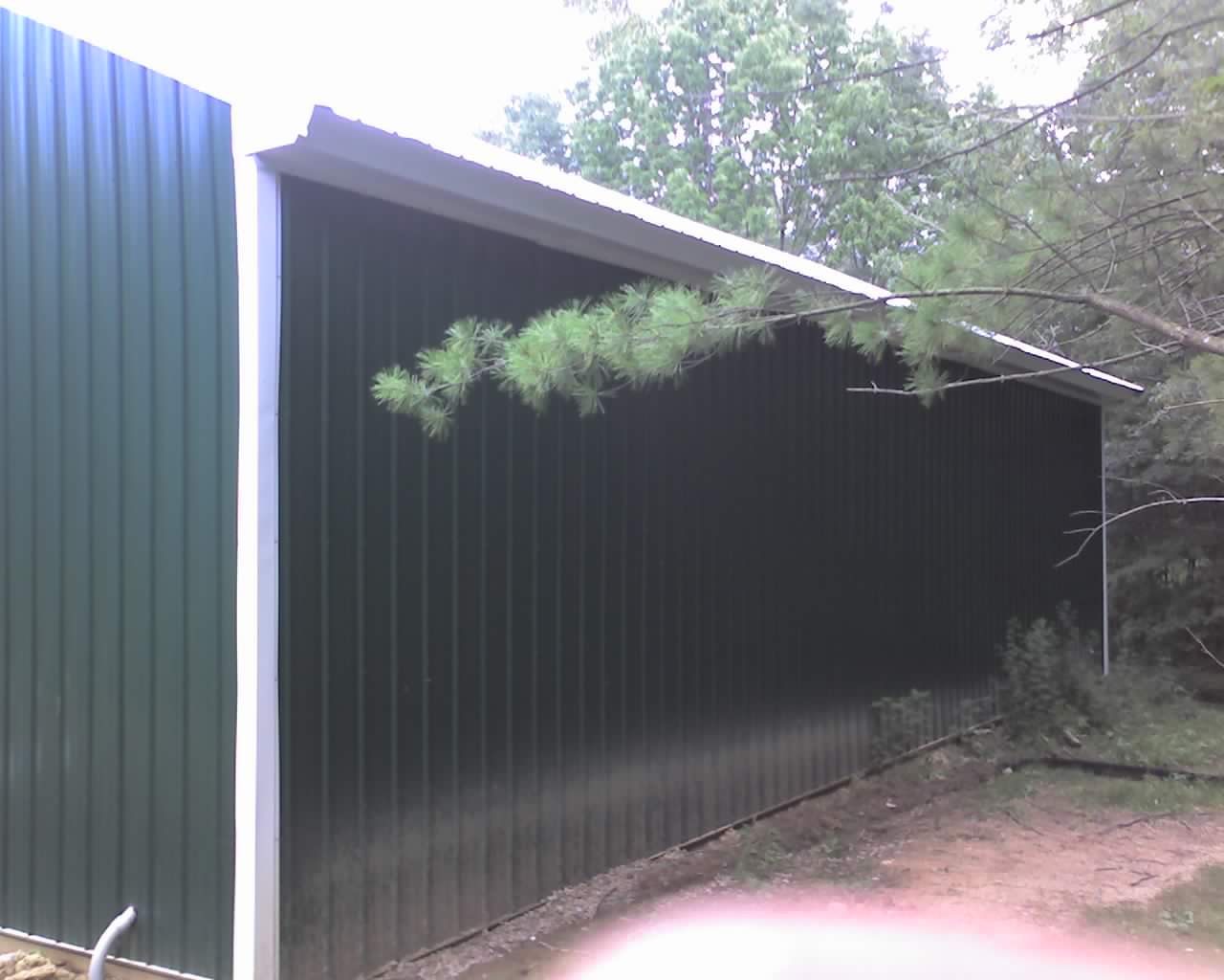

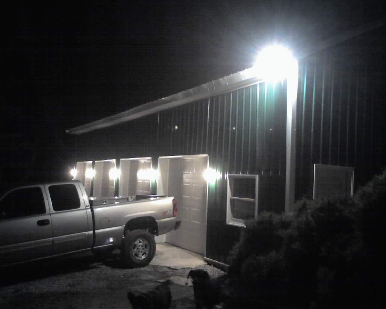

#11
Here is the finished looking exterior with all the trim

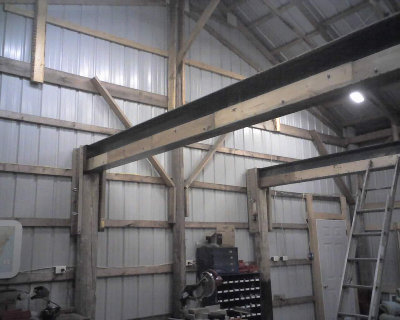

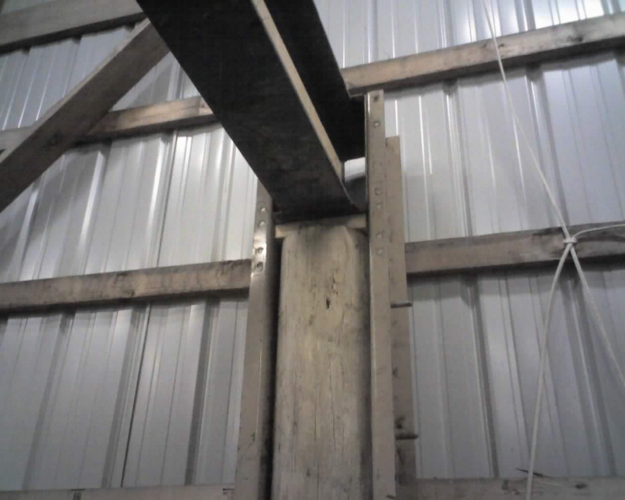

   / My uniquely built 30x50 Pole barn

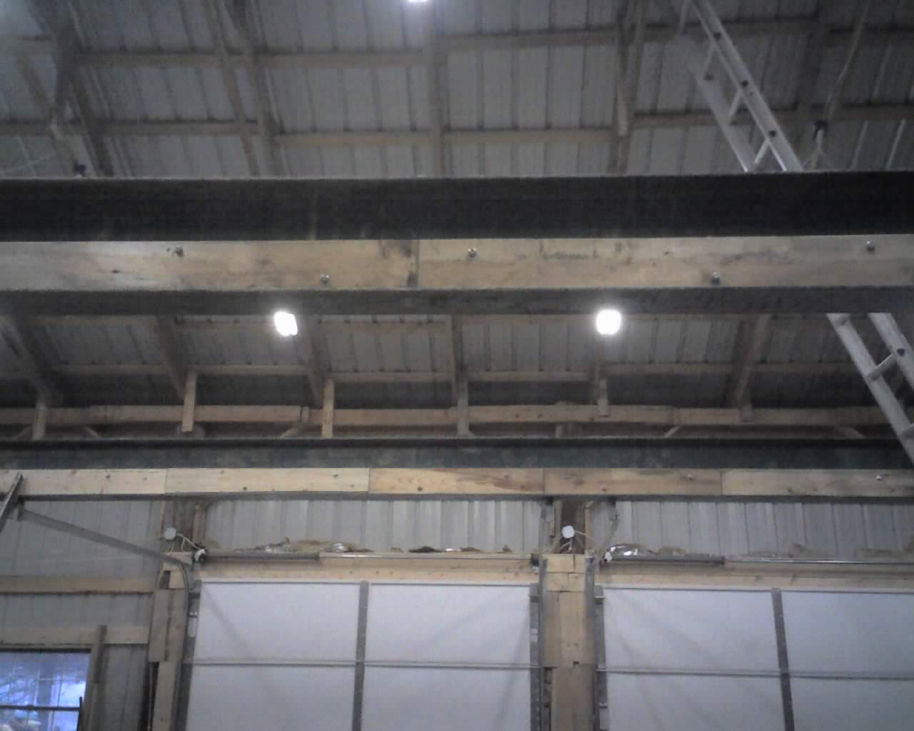

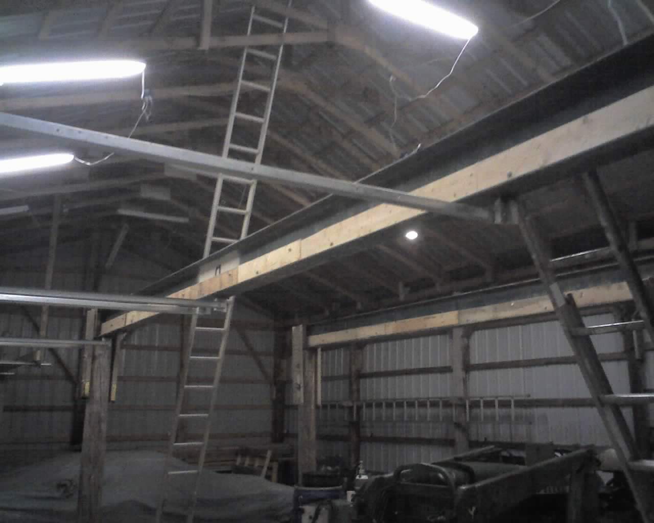

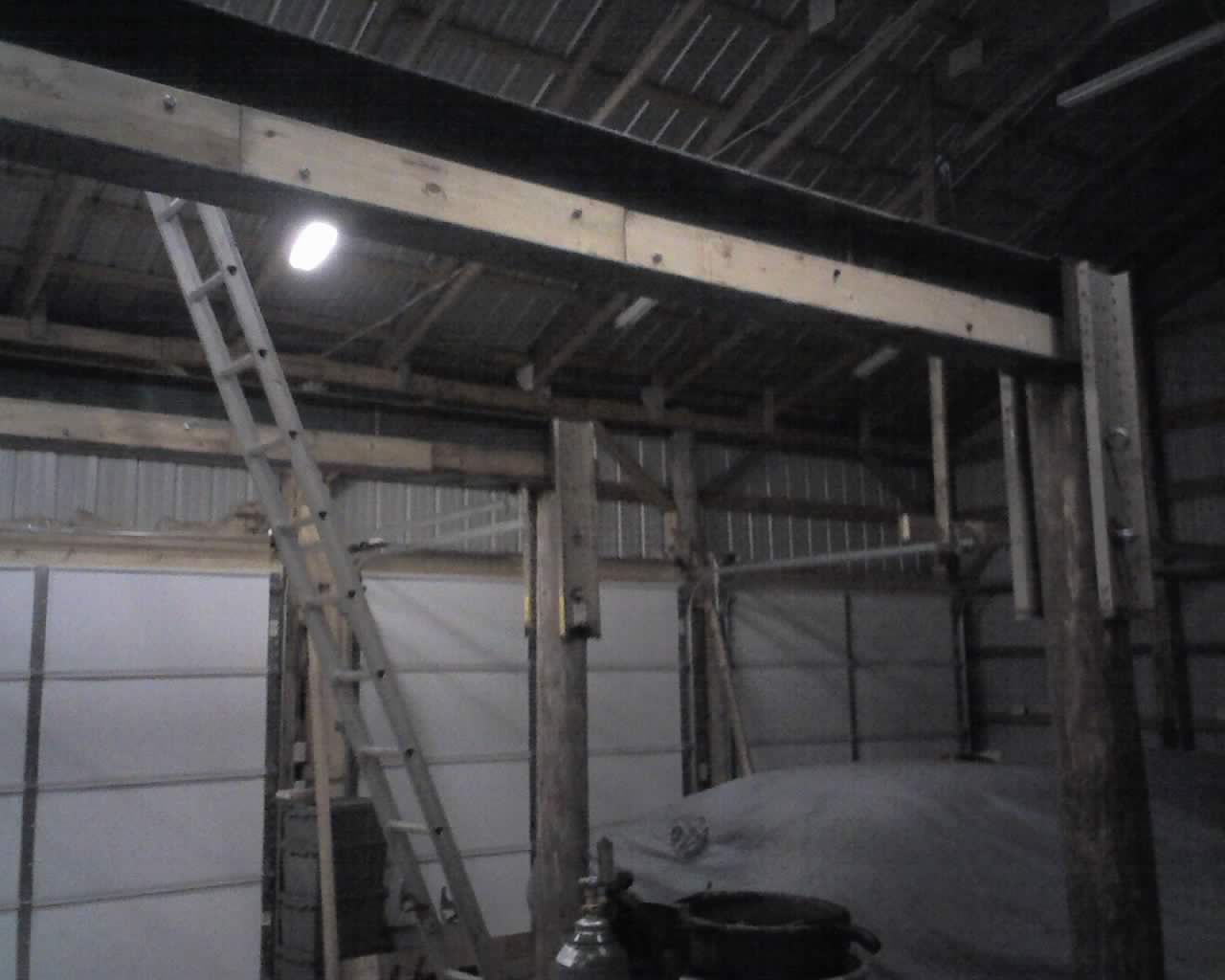

#12
Now some interior. I mentioned the loft earlier. The plan was to have a loft over the 30x30 concreted area. Then build a wall to divide the two areas that way I only have to heat the 30x30 ad not the whole 30x50.
So here are some of setting the I-beams

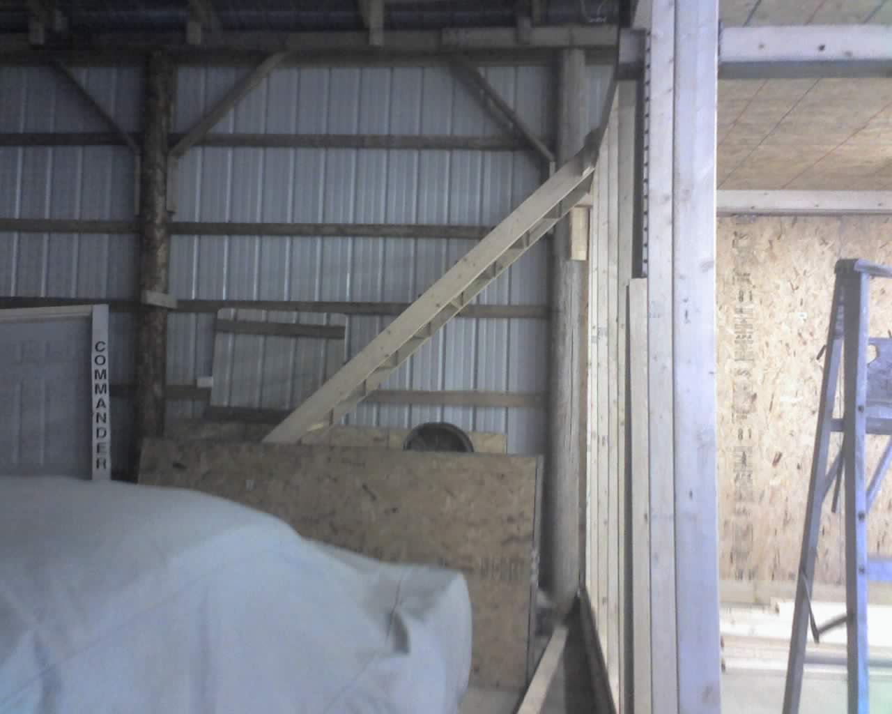

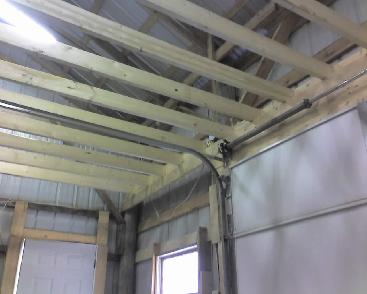

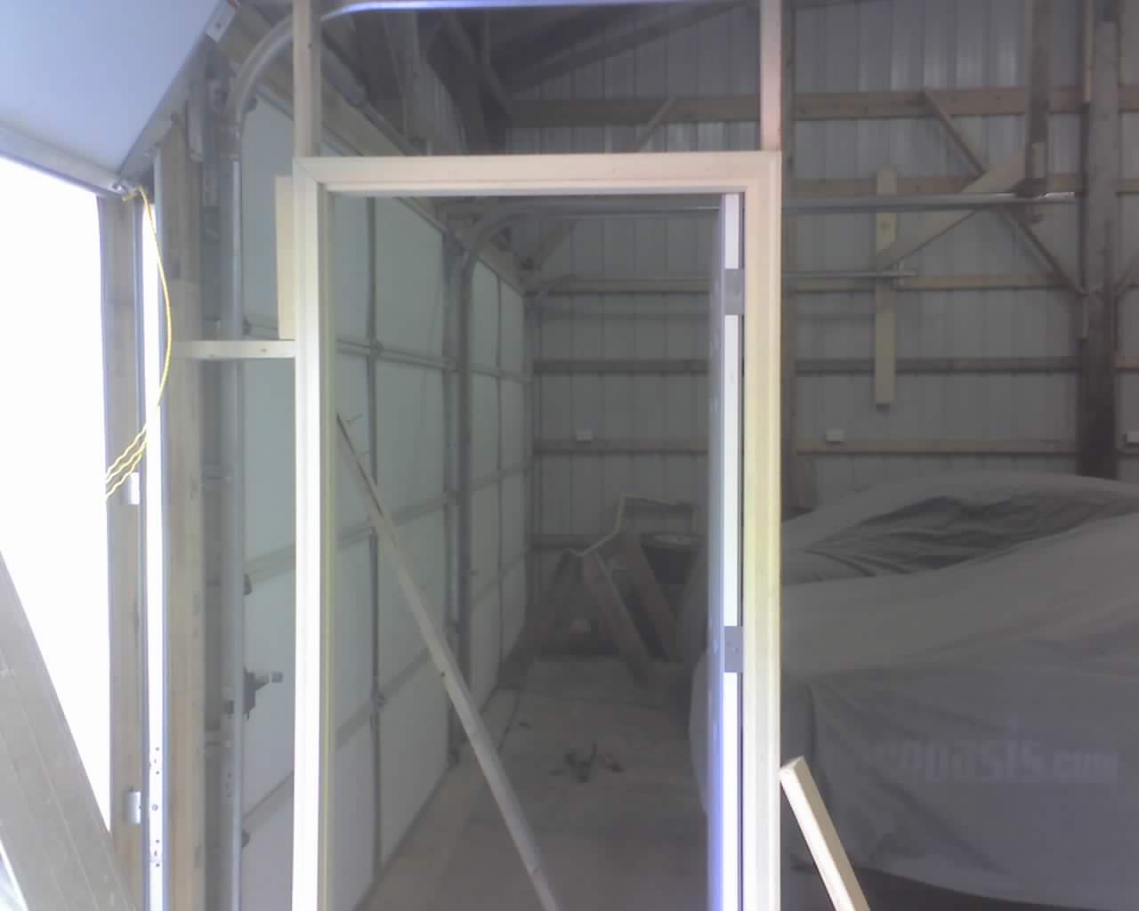

#13

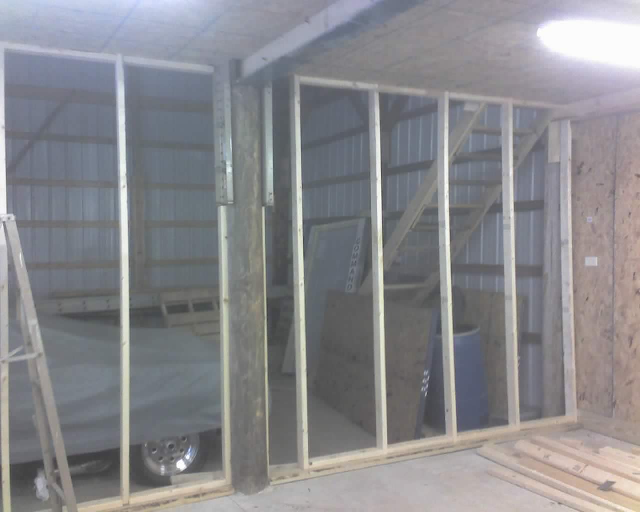

Some framing for the loft/ceiling and the dividing wall

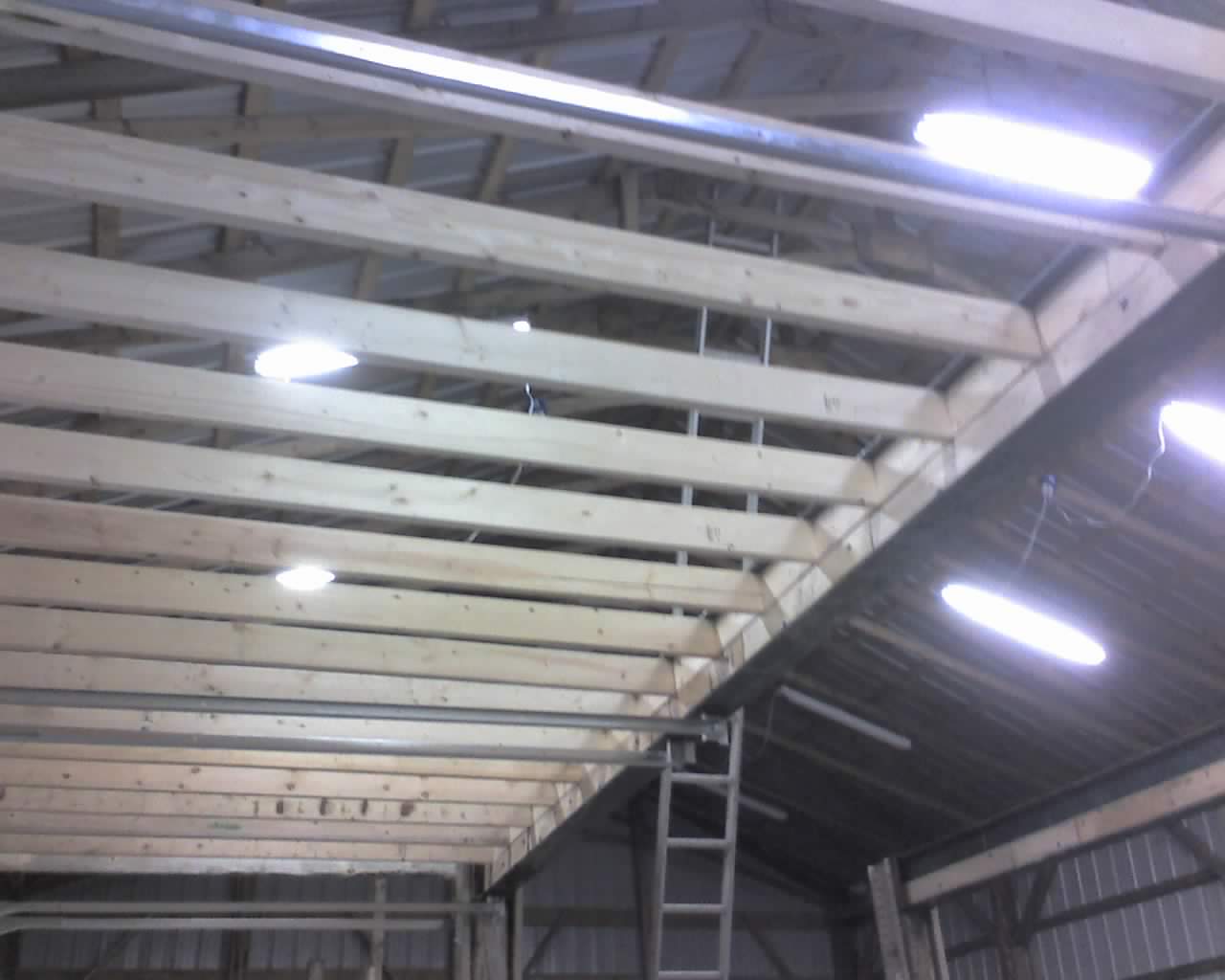

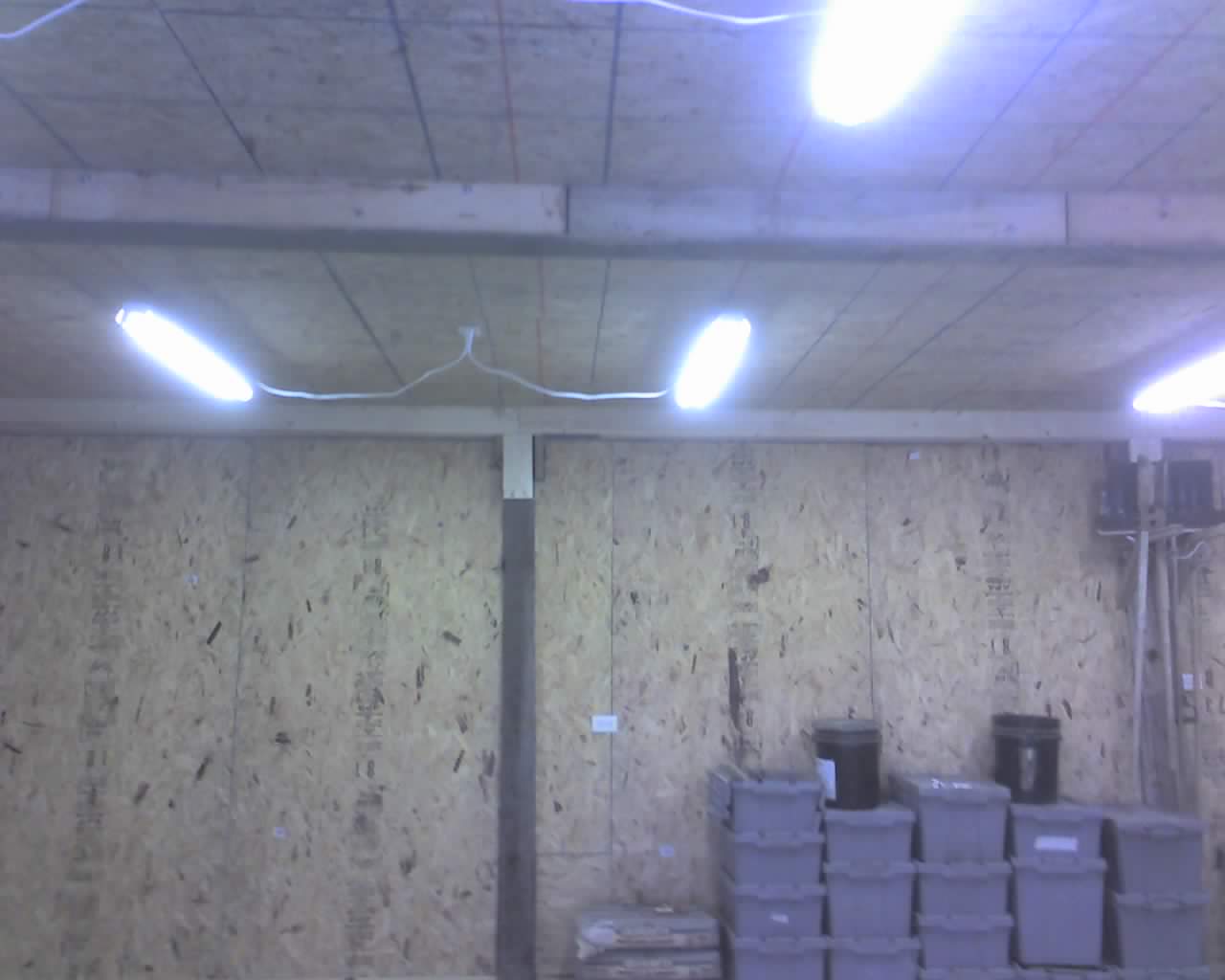

#14

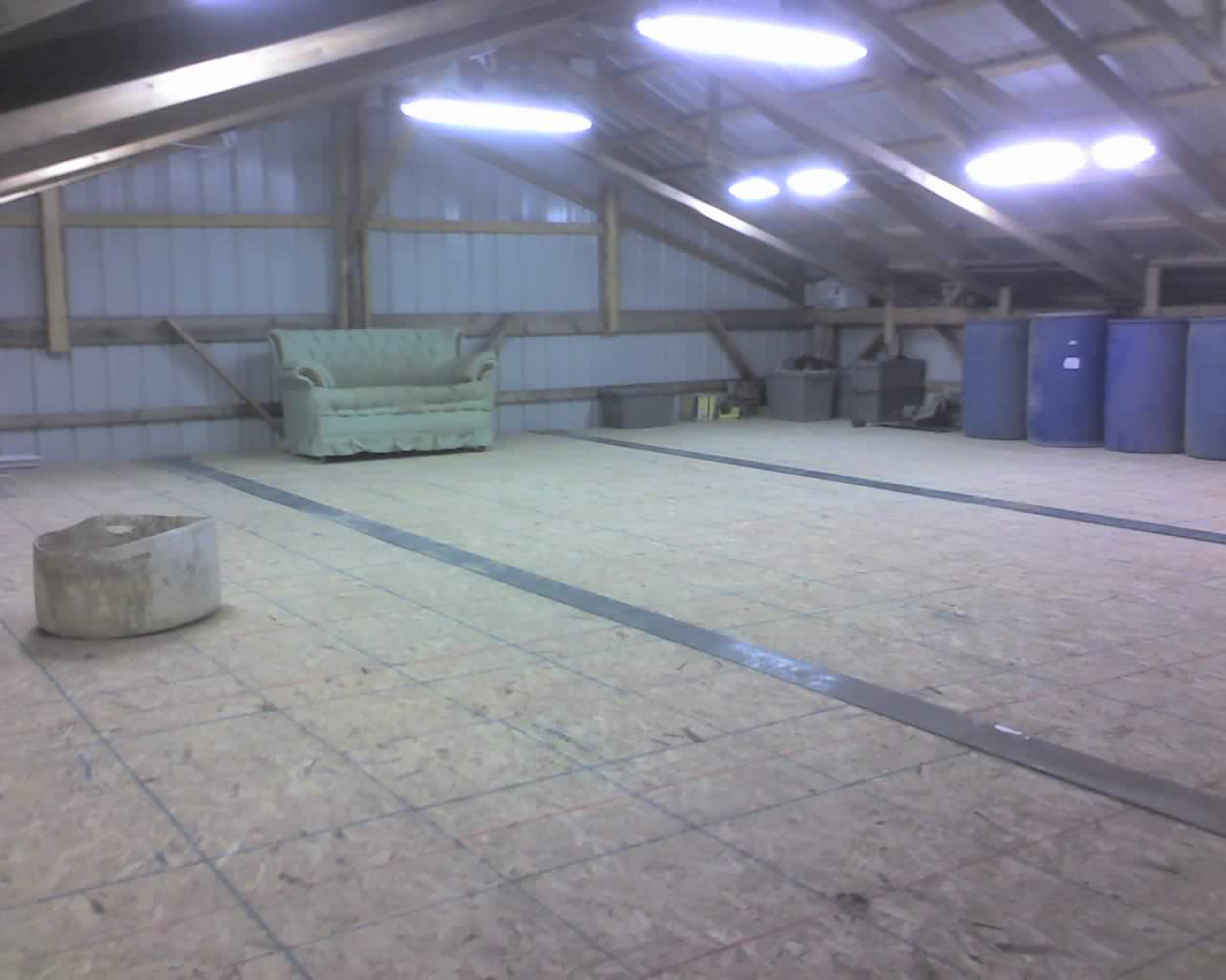

The finished upstairs loft

Unfortunatally that is all I have at the moment. I dont have any good pics of the workshop area. It is currently heated with a barrel stove and has been finished for about a year now. So this is not something that I just finished. I would go out and take some pics but it is pretty messy at the moment.
