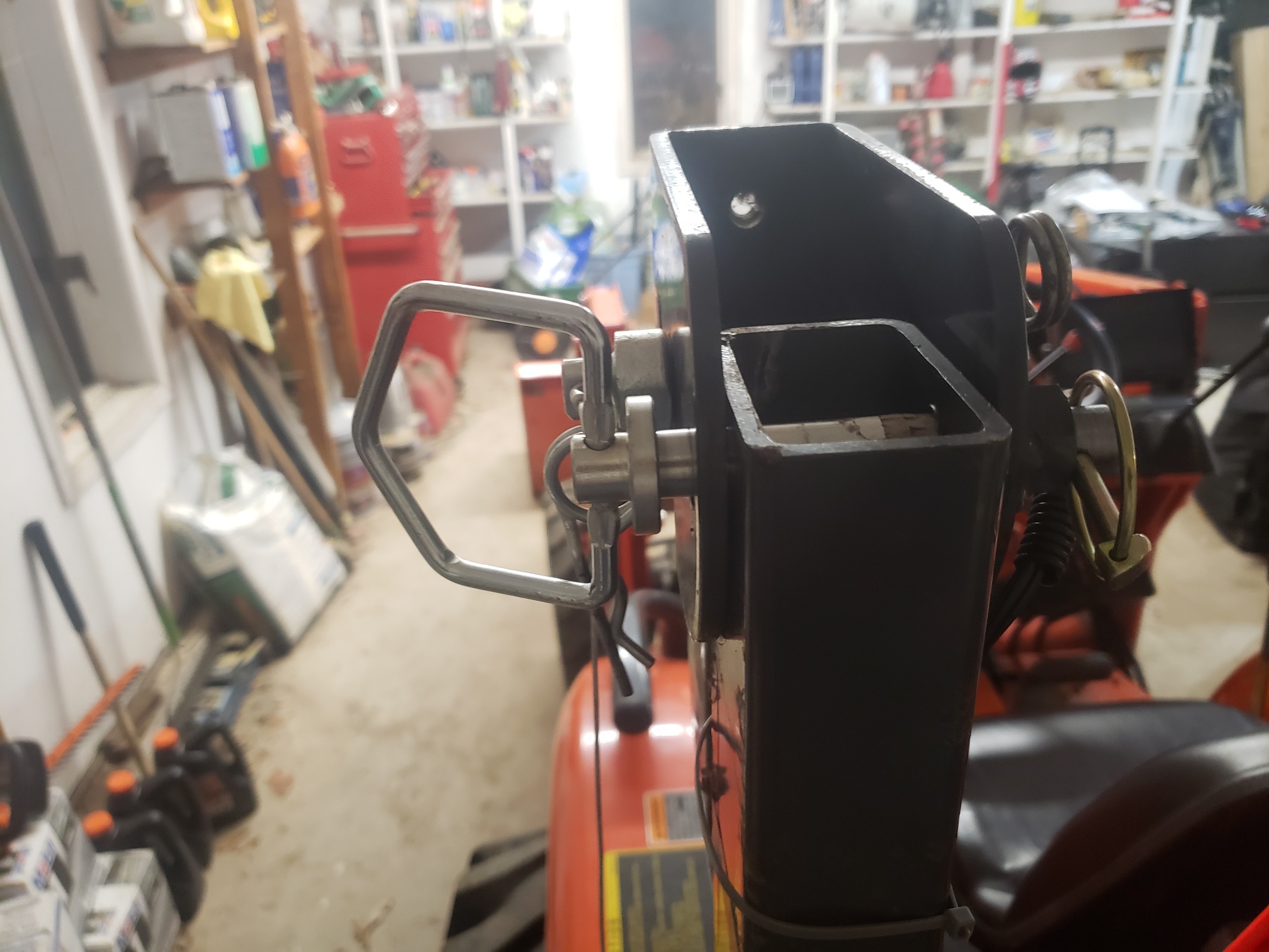

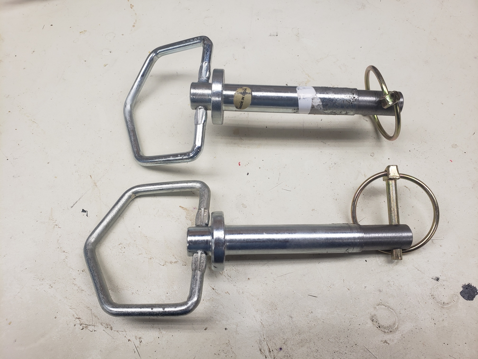

Ok, UPS delivered the modified pins from my son.
I had to drill out the hole for my lynch pins. The hair pins that came with them were really small.
I installed them on the tractor. The pin does not insert completely (planned) as it is stopped when the 5/8" diameter reaches the threads of the welded on nut. The 9/16" portion continues through the nut and the lynch pin secures it. There is ~1/8" of play before the lynch pin hits the frame of the rops. The 5/8" diameter portion is still completely through the frame.
No more 'screwing around"!
Thanks Adam!
   / My solution to the ROPS pin #25
If they vibrate you can always put an o-ring or two on the pin so they compress slightly when you put the pin in.
   / My solution to the ROPS pin #26
Could the ROPS vibrate enough to shift slightly when the pin is out and make re-insertion of the factory pin difficult or impossible?
