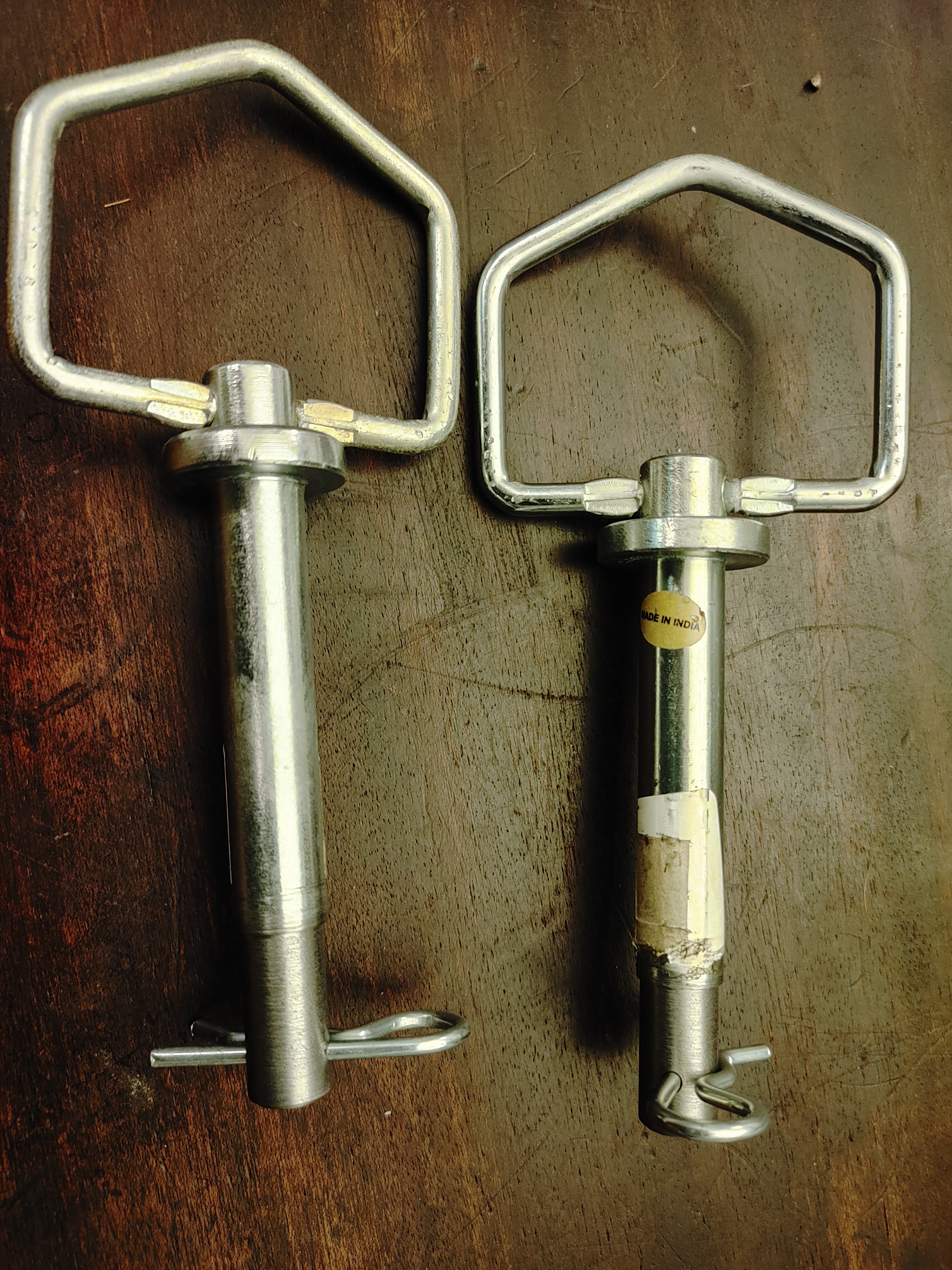

My L3800's ROPS has screw in pins for locking it in place, up or down. The factory pins have no handle of any kind to aid in screwing them in. It's a tedious process putting the ROPS up and down - the tractor is garage kept and of course the erected ROPS doesn't make it through the door. I tried another poster's idea of just getting a smaller diameter pin and sliding it through the threaded welded on nuts. That works but there is some expected play. I wasn't really good with the solution.
I thought of just drilling out the threads but could bring myself to do it.

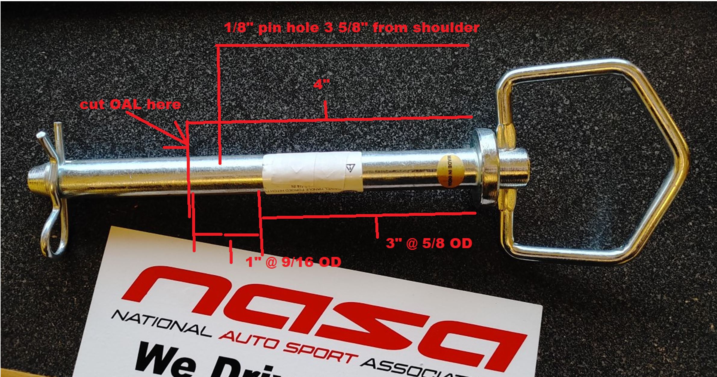

My son that lives in MD has a nice garage set up including a Bridgeport and full metal working shop. I sent him 2 hitch pins and a crude drawing. He is going to fab them today:
The pin will be full size where it goes through the support holes and will reduce only going through the welded on threaded bolt. I have high hopes here!

My son just sent me a pix of the finished product. I should get it by Wednesday (he isn't Prime).

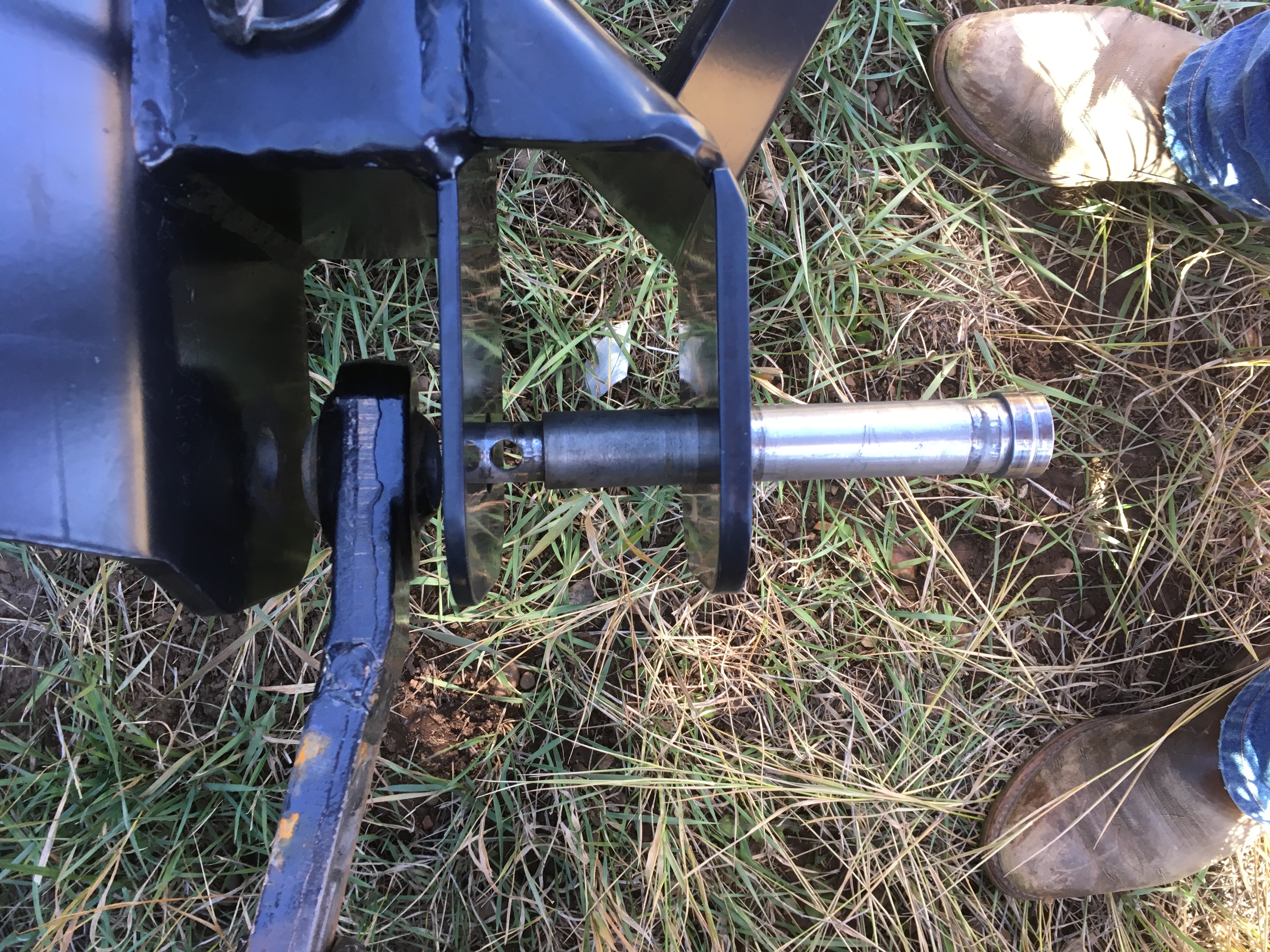

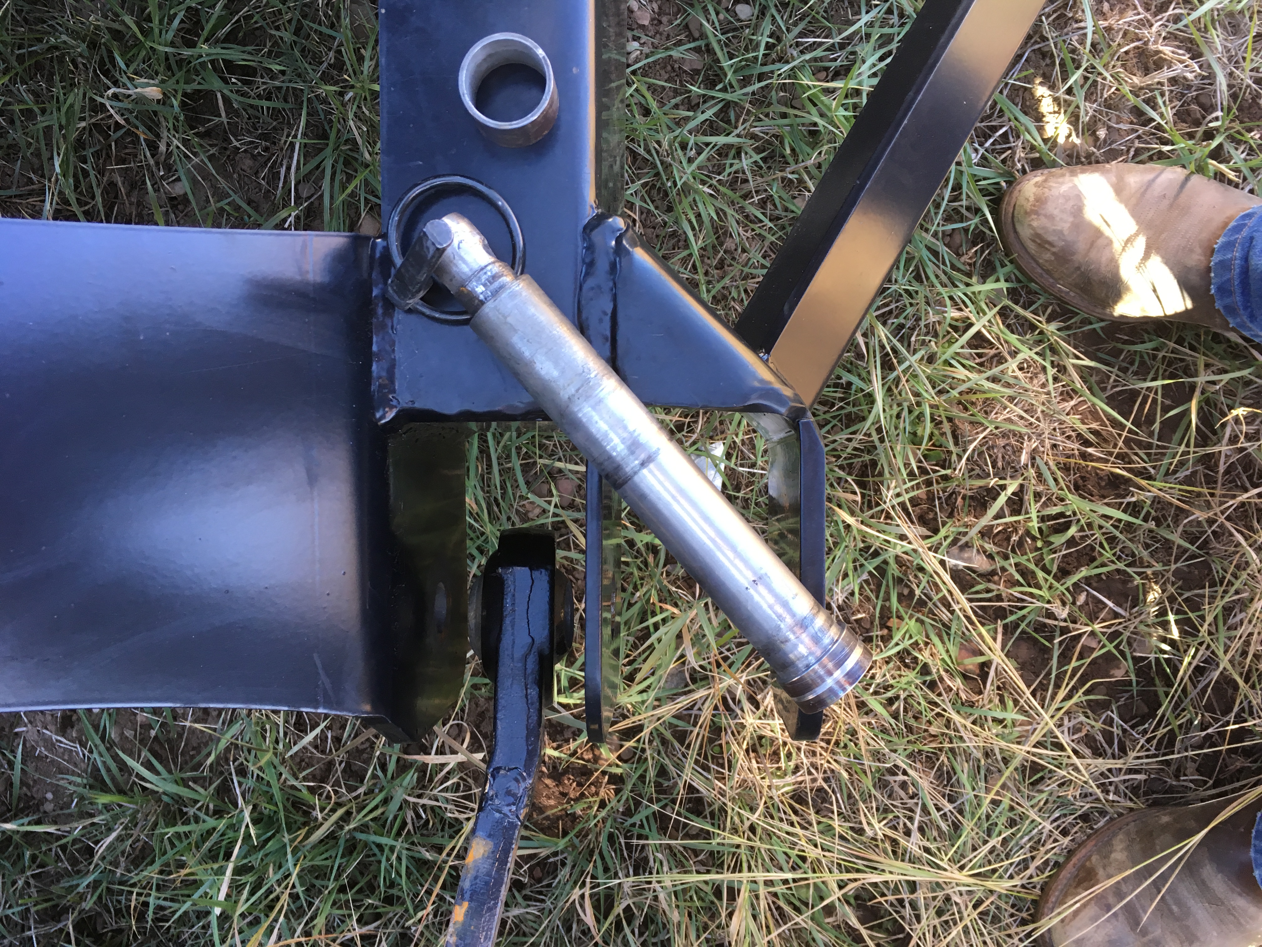

I did a similar thing with the pins for the lower lift arms on my snowblower. The original pins required bushings for both diameter and width which was just something else to lose and a pain to get in place so I made a step pin that was full size all the way through except through the last flange where it stepped down. Then the click pin held it in place. The only bushing required was to reduce side slop of the lift arm between the two flanges.
Your idea should work good but I would get rid of the hair pin clip, instead get a click pin which should be easier to get in and out.

I agree :) those are the clips that came with the hitch pins. One of the first things I did when I picked up this tractor was buy a large assortment of click pins. It came with way too many hair pins.

Hope you report back, whether it works as shown or how you tweeked it. It would really be a freak accident if you ever rolled it AND it sheared the 9/16 diameter when it wouldn't have it were full diameter. I was going to do it Not2old's way but the impactor battery would probably be dead when I needed it.

If the hole for the retention pin is in the right place, the full 5/8" diameter of the pin will be all the way through the ROPS frame work. The 5/8" to 9/16" shoulder will be held close to the inside of the nut.

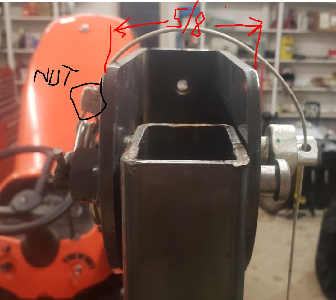

No, if all works as designed it will be the full 5/8" diameter going thru the ROPS channel. The 9/16 will go in as far as the welded nut on the outside of the channel:
the keeper pin hole in the new hitch pin should be pretty close to keeping the 5/8 snug to the threads
Good point. And he can always add a washer out there if it's loose.

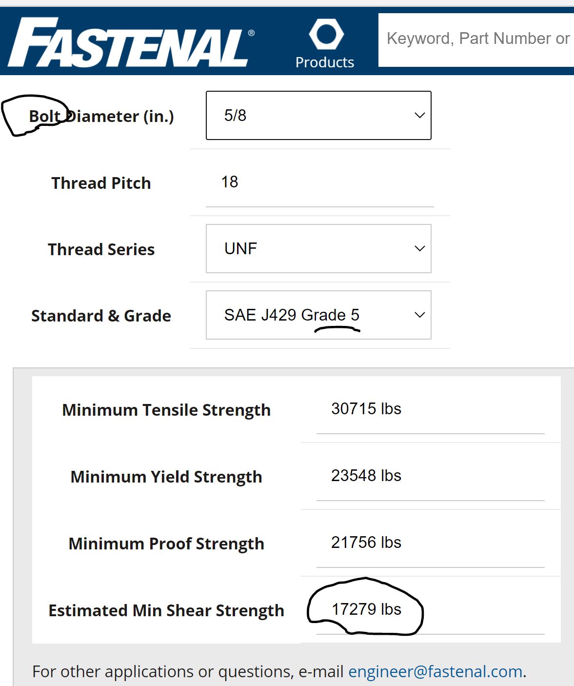

The pin from India is likely a grade 5 while the factory threaded pit is likely in excess of grade 8. Any concern that the weaker grade 5 pin would fail in a rollover?

The following is for a grade 5 5/8" bolt. One would think a solid 5/8 rod would be stronger (this rating is 60% of max strength)
