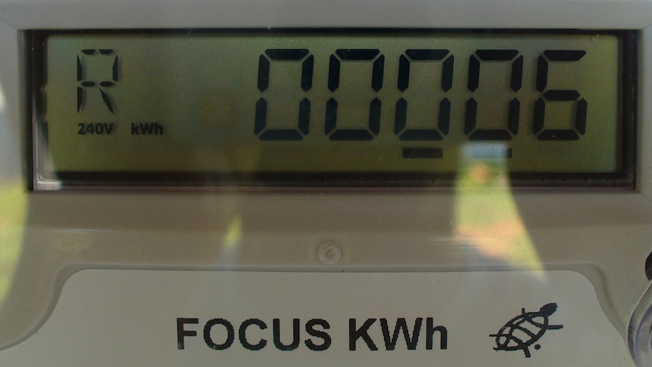

I've looked into it and the cost just doesn't justify doing it for me. I really do like the idea of not having to pay for power. But Vermont isn't one of the sunny states so that pushes out the ROI time. Does your state have a special price the utility must pay you for the power or do they just give you wholesale price. I don't know for sure but I've been told the new digital meters track both in coming and returning power independently so they know how much you've supplied.
Al, I have a digital meter that records both forward and reverse power. I pay for forward and get paid for reverse. North Carolina has a net metering law, so for grid tie systems you can get what you pay for power, but if you over-supply they will not cut you a check. So you pay for the net amount of KWH you use, but they won't cut you a check.
The power is being purchased by NC Green Power. They have a web site. Basically, they pay more than what the utility would under net metering. They get their power from people who wish to pay a bit more to purchase green power. If you have over 10KW (in NC) you are classified as a power generator and you get paid the burden rate for your power. So the rates are:
Burdon Rate: about 6 cents
My rate at he house for power I use: about 10 cents
What I get for my green power: about 15 cents.
I had to get a new meter and drop because the house if 400 amp service, and the meter base does not have CTs (current transformers). My power co-operative did not have a digital two way meter that would plug in. On the plus side, I've got an extra 100+ amps of service by the outbuilding garage if I need it.

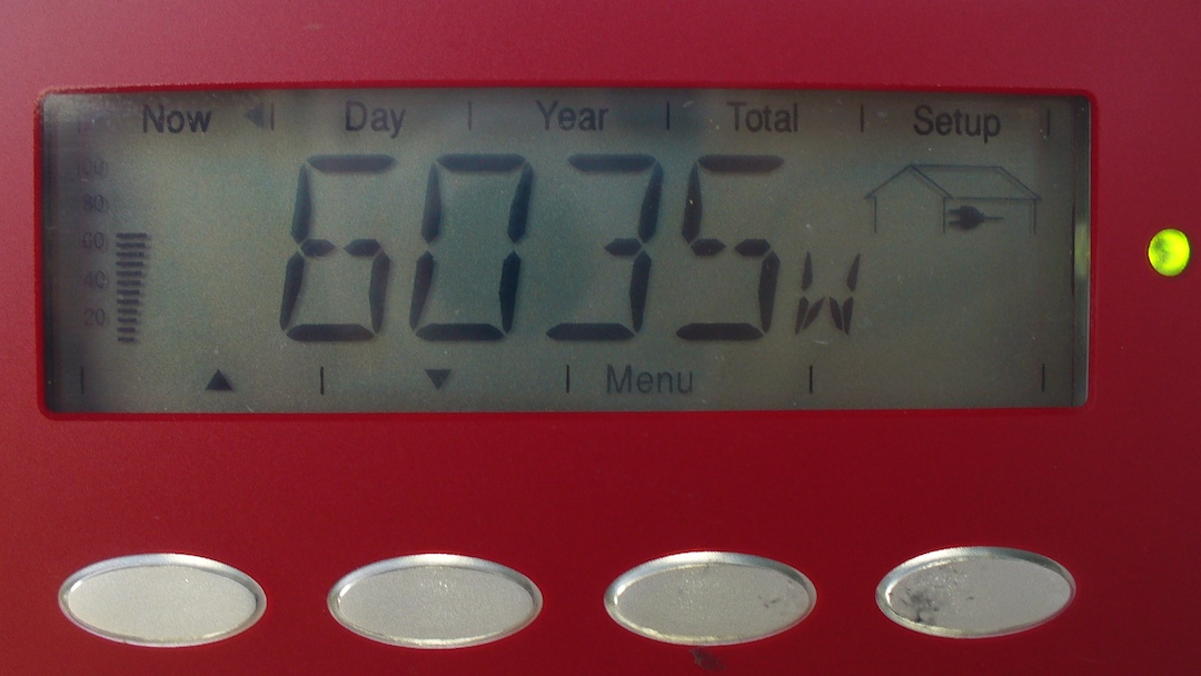

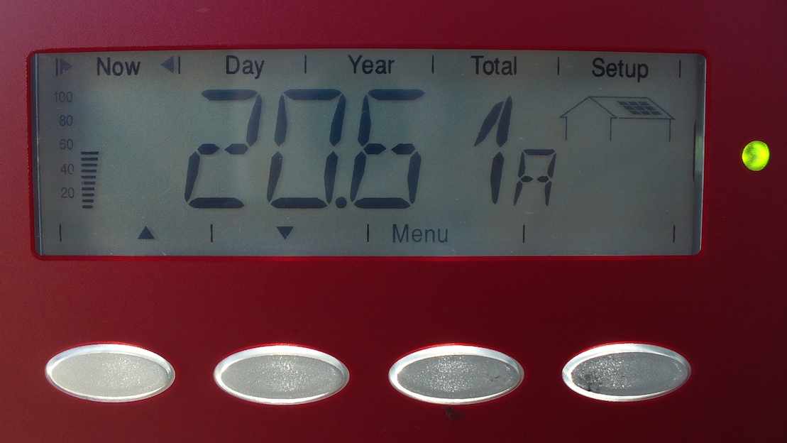

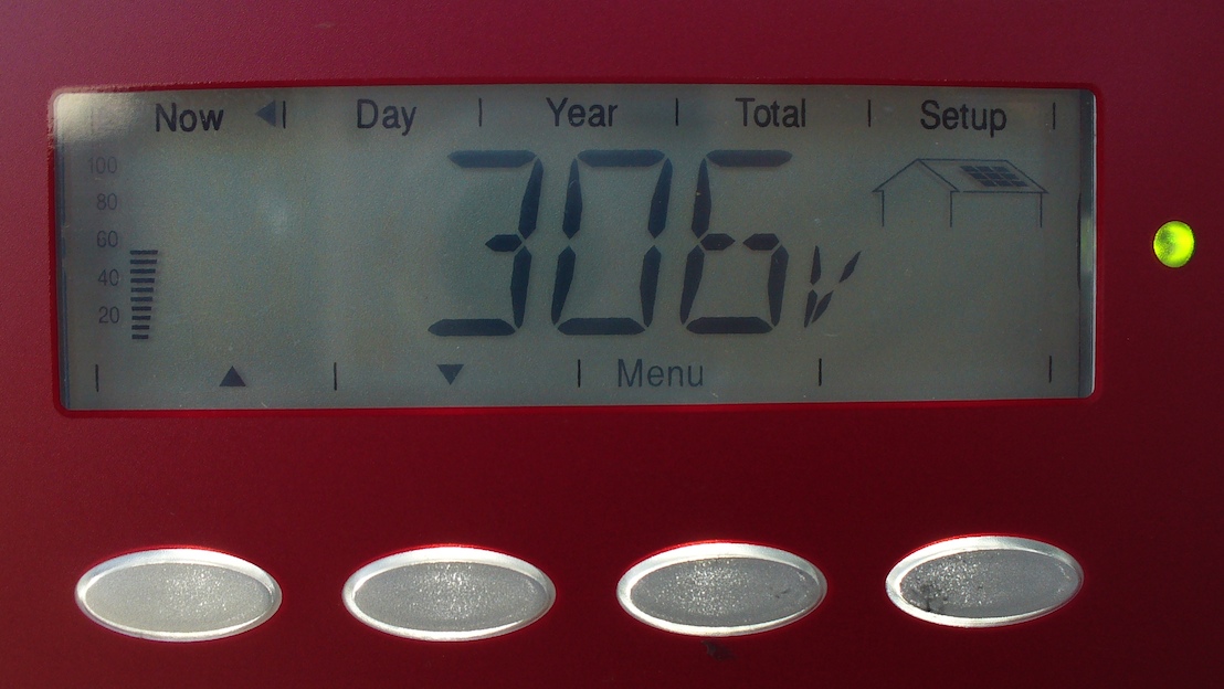

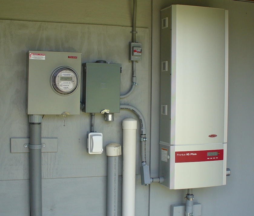

Tom, glad your battery storage system is working for you. It is quite a task to figure out which way to go regarding mounts, tracking, number of panels, simplicity/reliability.
Lt., I hope the price comes down too. A big part of the problem is a lack of standard panel sizes between manufactures. They don't want to be generic and interchangeable, but that is what it takes to get the price down. The rail system could be a much better design, but I suspect the company in Utah that makes it can't afford a re-tool due to the volumes. The design they have takes a little more labor and thinking than I'd like. I do like that the silicon came from Japan but the mounts (aluminum and glass) are made in Tennessee and the mounts are made in Utah. Wire was all made in US, as was the DC combiner. At least the project has some US content, and maybee even an appropriate amount for a global economy.
The Fronious brand inverter I have is a top of the line, 96% efficient, unity power factor, and low harmonic distortion. But it has a common base for all the sizes from 2500 to 14000 KW. So there is a price to pay at the low end. If there was some clear high volume size (say the 2000 or 2500 watt system) the inverter could be tailored specifically to that size and it's cost would come down. I'd love to rip the skin of and look inside, but I don't want to void the warranty. That's an expensive but well thought out piece of equipment. It reminds me of what the U.S. used to be able to design.
There are some pieces missing regarding tying up the cables and the solar combiner. So anyway, with a mix of volume and smaller number of design sizes, and more standard mounts the price of the equipment and installation could come down.

When NC got a net metering law, and a target goal for some percent of green energy, things changed. North Carolina also has a tax credit for installing lots of energy stuff, so that plus the Feds makes it possible.
With a grid tie system, the inverter shuts down if there is no commercial mains. It has to in order to get the required UL listing. That's fine, good feature, safety first.
I would love to have a way to tell the inverter that "I'm on my own". I am guessing that the problem is how to co-ordinate that with a mechanical switch (or electro-mechanical switch) so that you can not backfeed the grid.
There is also the problem of what happens when the power output of the array goes down? Do you risk damaging your compressor? How do you manage your load in a changing supply environment?
So I think what you want is doable, but suspect that the additional cost of some sort of inverter-controled electromechanical transfer switch would be a big expense in a low volume market. The low volume would come from the varying output of the cells during the day. You'd have to be a pretty savvy user to work with that.
For what it's worth, I did not connect the PV system after my transfer switch (on the same side as the generator). I'm pretty sure it wants to "push around" the grid and counts on that being an "immovable object". If the inverter was "pushing around" the generator, I think things would be unstable. The inverter has some pretty stringent requirements regarding the AC line frequency, and might also be unhappy if the frequency changed a bit on the generator as more load (like a heat pump kicking on) was added. It would be interesting to know if anyone has tried this, but I don't want to be the test case due to the cost of all the stuff I could blow up :laughing:.

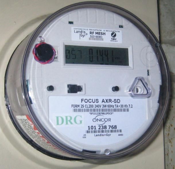

I see where Enphase is now offering a thermostat that is connected wirelessly to the Envoy. You can control your thermostat by logging in to your Enlighten web page. At $350 each (I would need two) plus monthly monitoring fees, I'll pass for now.
I have a "smartmeter", which measures incoming and outgoing energy and communicates with the transmission company's computers for remote monitoring and billing. I'm guessing you have a similar or identical meter? In Texas, we have a portal where you can monitor your incoming electricity in 15 minute increments. You can also add up to 5 HAN (Home Are Network) devices to your smartmeter account. I'm not sure about the capabilities of this site, i.e. whether you can control those HAN devices, or just monitor them. This sounds like the type of program that you are looking into for your installation, yes?

That's the same Landis+Gyr meter I have. Too bad it's made in Mexico and not back in Lafayette, IN anymore :(.
It is read via RF on the power lines. No portal, that's OK. I have two CTs on the lines to the inverter, that's how I'll measure the output power. I have 8 CTs on my breaker boxes to measure power I've used.
The $350 thermostats are OK. The problem in a very general sense is that by the time a house has all these various gadgets, the time to maintain them all is high and the interoperability is low. So reduce it all to simple sensors, web based or app based displays (like a program that runs on you Apple platform), and a single machine to run it all.
The incremental pain of running all these single purpose devices can soon outweigh the individual advantages. Well, the PV array is another step to figuring all this out.
The new meters with Zigbee/2.4GHz RF interfaces will also be interesting. It will let people read how much power they have used without having to retro fit CTs into their wiring. This is how Google does it's power monitoring service. There are just too many things going on in this area at once. Something goods got to emerge from it.
