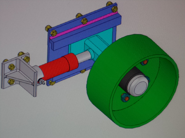

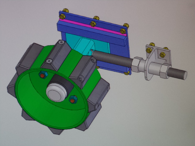

Update: I recently made a few changes to the rear track tensioning system. The first image shows the first design I tried using porta-power cylinders pressurized with grease to tension the tracks. It worked but I just could not keep the grease inside them and it eventually leaked past the zerk fitting threads - I decided to ditch them. Image 2 shows the new and improved 1" threaded rod system I installed to tension the tracks. No leaks! I took it out for a test spin the other day around the lower yard and the tracks stayed taut. I did start to smell hot brake pads as if some pad(s) were dragging. I will check to see if I need to back off the master cylinder push rods. I may also need to get some cooling air flowing past them like they do in NASCAR. You'll also notice the black teeth I added in the second image. Occasionally, I saw that the belts would ride up onto the spool faces - not a good thing. To keep the belts straddling the spool, I just mounted the old sprocket teeth to the spool and they seem to be guiding the belts just fine. I still get some track chatter so I plan to wrap the drive spools with 1/16" UHMW to prevent the metal-to-metal contact. I experienced some hard shifting into third gear. With 105 hp, I wonder if I really need an automatic transmission to make the shifts automatically. What if I want to start in 3rd or OD instead of 1st? In looking over the transmission control description and the associated wiring diagram, it looks like I can integrate a selector switch which would force the appropriate solenoid valve to make the selected gear change and keep it there. I could add images of the write-up and wiring if anyone wants to review/comment. More tweaks to come...
