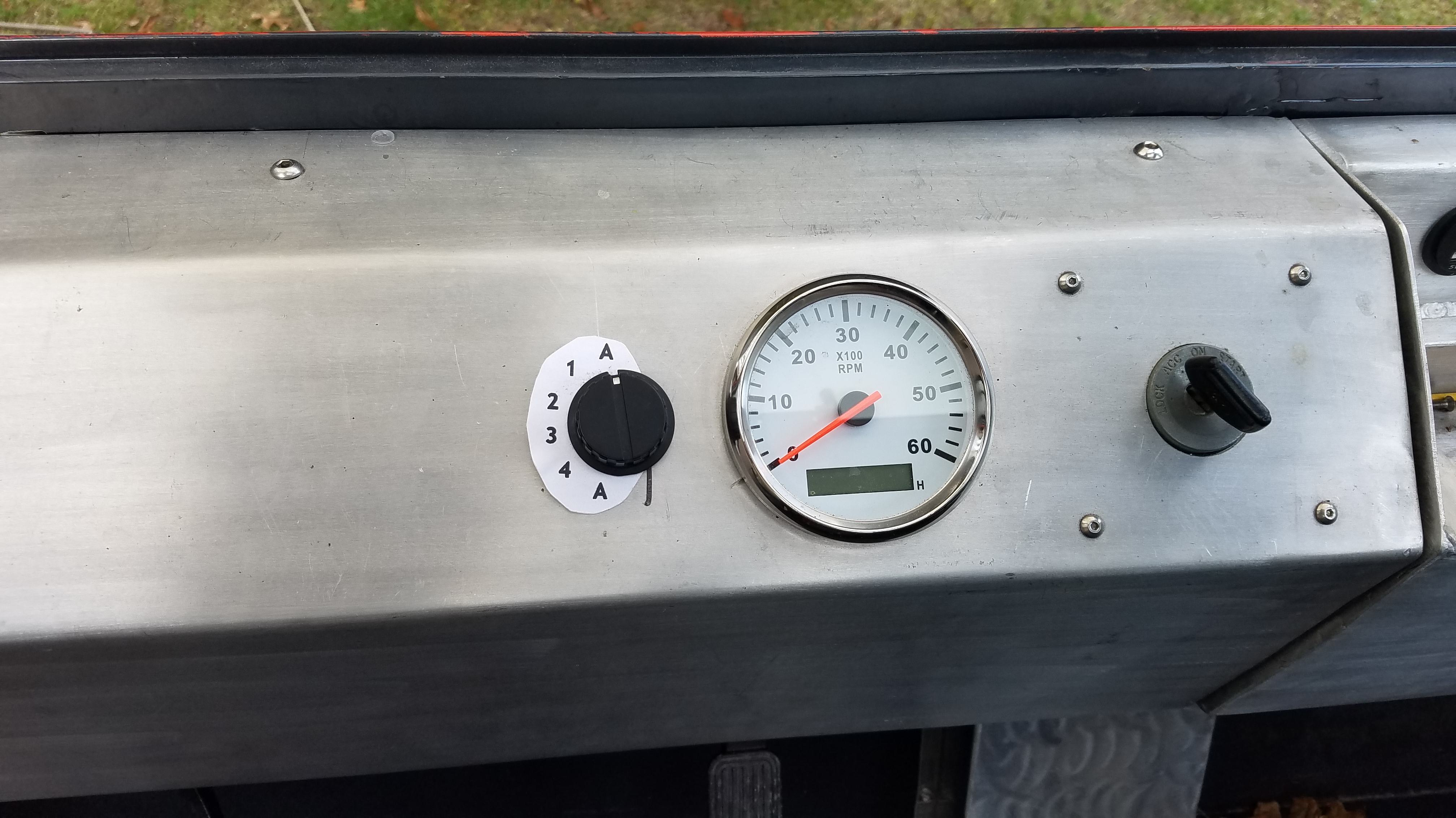

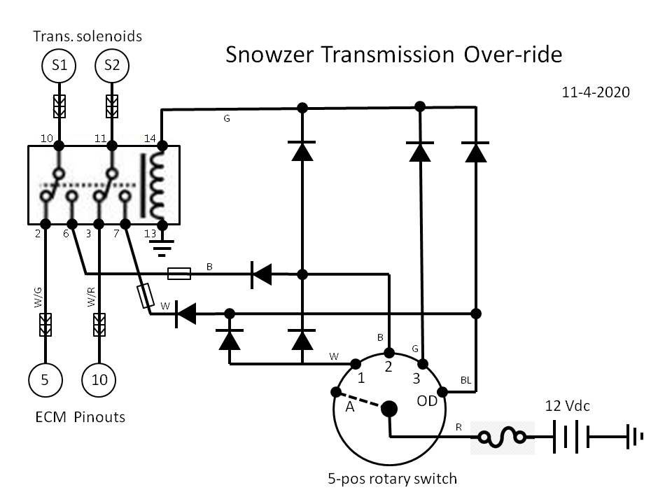

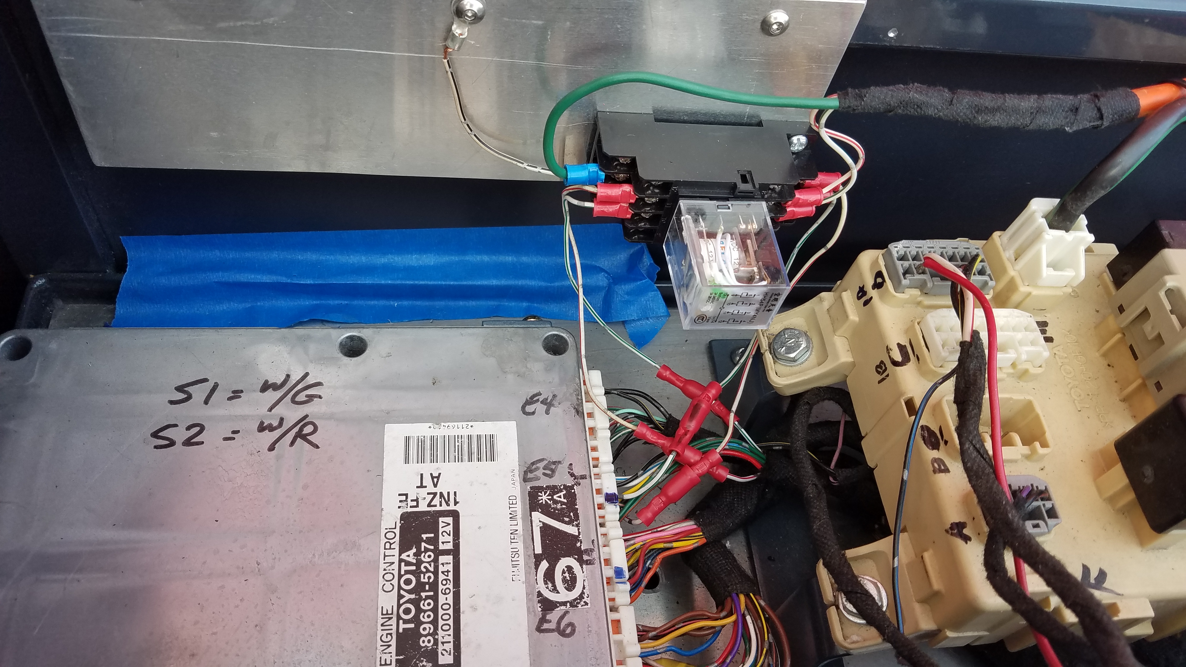

The Snowzer sideshow continues.. After a few fits and starts I finally got the "Select-a-speed" wiring installed and tested. In summary, this lets me specify which gear will be used when the shifter is moved to Drive. I test drove it today and worked just fine. Here's the wiring schematic and a few images of it. Yes, I plan to make a nicer dash legend. :)
Transmission shift Over-ride wiring.png 20201105_142717.jpg 20201105_142655.jpg

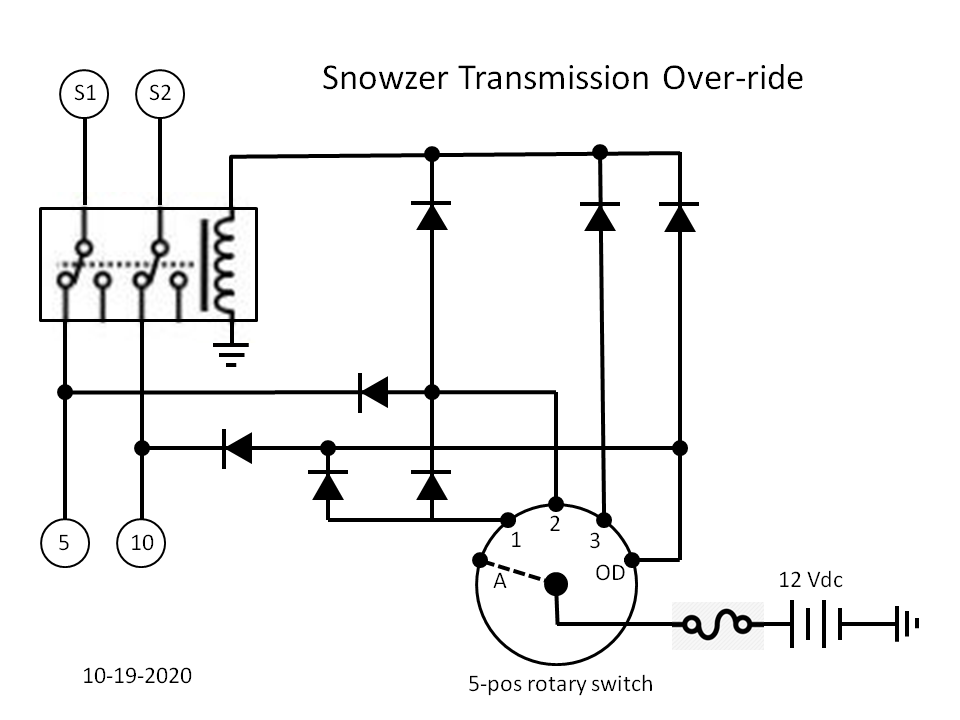

Well, the previous schematic wouldn't work; a diode was in the wrong place. I hope this one will. I am currently soldering together the components and will try it out soon.
You have an awesome project! Sometimes when I'm doodling out a schematic I use colored sharpies to draw it out, it helps me keep track of things. Keep on sharing this with us, thanks.

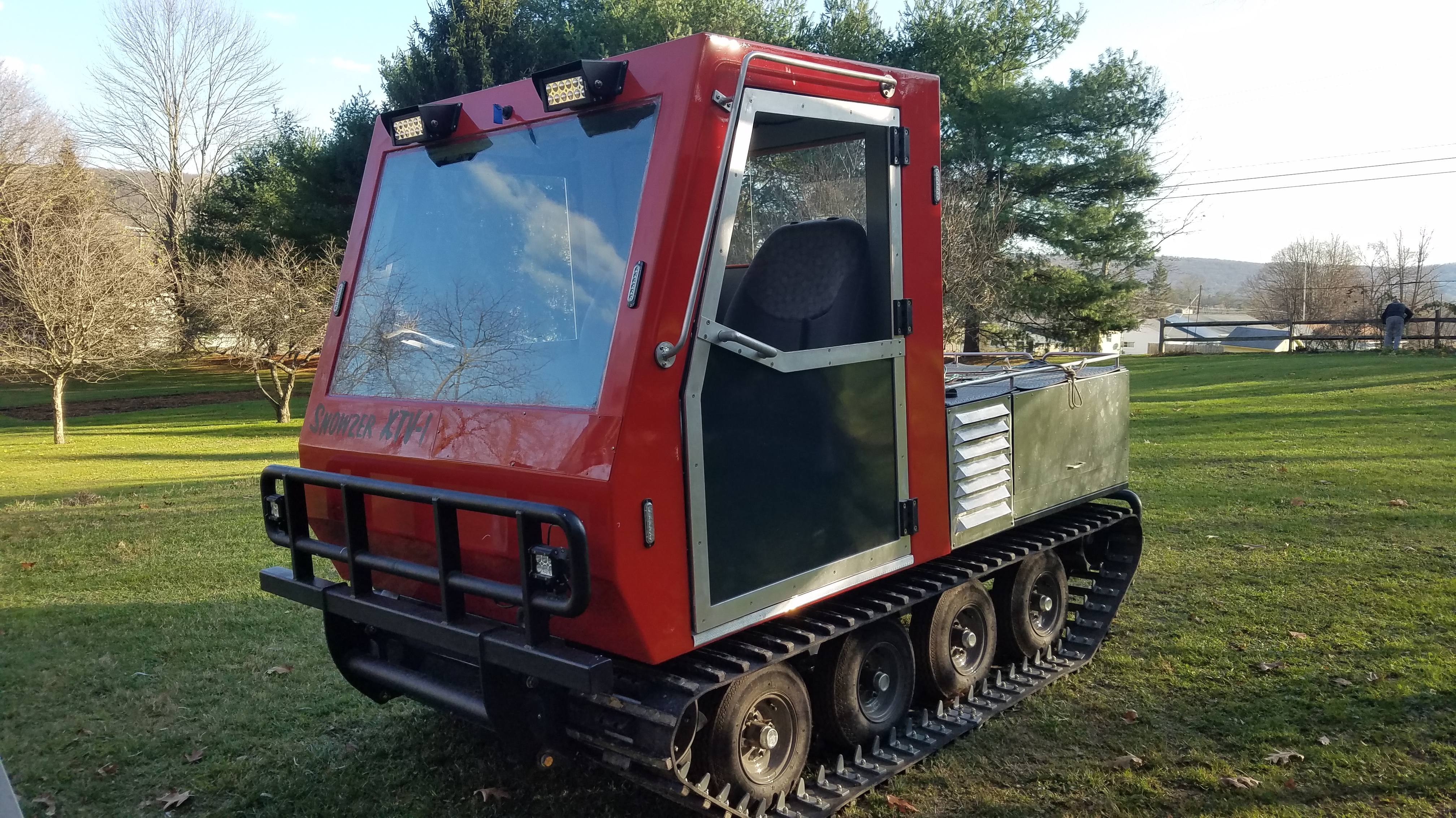

Thanks for the encouragement. I installed the windshield today and plan to hook up the wiper tomorrow if the weather cooperates.

Chilly here today with a nice breeze to keep the bugs away. Actually, too fricken cold to do anything except take a photo showing the new windshield installed. I'll probably put the wiper on it tomorrow. I recently found a used NP231J transfer case at a decent price that I plan to procure next week. I will see if I can use it as a speed increaser or rev decreaser depending on how you think. Currently, Snowzer is geared to go about 18 mph at 6,000 rpm in 4th (OD) gear. This tc has a ratio of 2.72:1 which could reduce the revs at 18 mph to 2200 rpm to up the top speed to 49 mph at 6000 rpm. If it fits within the chassis along with the two prop shafts, I probably won't put it in after winter once I played around in the snow a bit. :thumbsup:
   / My Senior design project - a "Swamp Thing" tracked vehicle clone #419
looking great! What did you use for a windshield?
#420
I used 1/4" thick laminated safety glass - same as a car windshield. The cost was $170.
