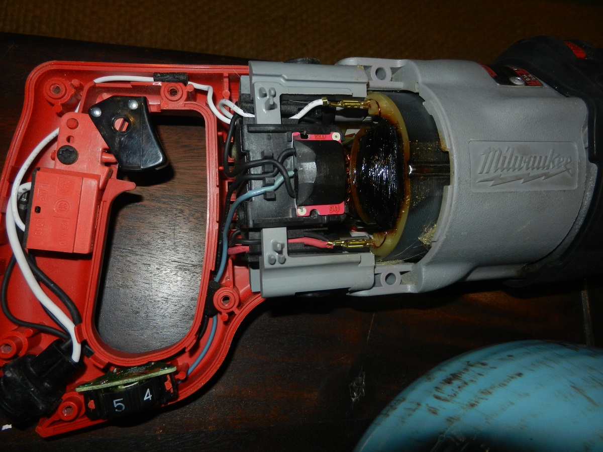

I bought this a couple years ago. I'm a homeowner, not a contractor. I've only used it (don't really know) let's say a dozen times.
Just now pulled it out to cut two 2x4's that are hard to reach.
Held it firm, cut first 2x4 and noticed a smell in room.
Started to cut the second 2x4 and stopped midway to readjust... realized that my pants leg was hot. (I was using my body as a weight against the body of the saw, cutting away from me BUT, I was not "grinding" into it)
Anyway, I noticed some smoke coming out of it. :eek:
Not really thinking, I presumed it just got warm from cutting a 2x4 (it should not be THIS warm with a single cut)
I started cutting....then I noticed what appeared to be "flames" (a too strong of word) where the brushes might touch the stator (or whatever it's called)
Stopped again...more smoke.
I only had a tiny amount to cut for the board to be finished so I cut it and watched the saw. It was smoking and "blowing out some flames" (not really flames, just a bunch of sparks)
It WAS getting hot to the touch in that area of the case.

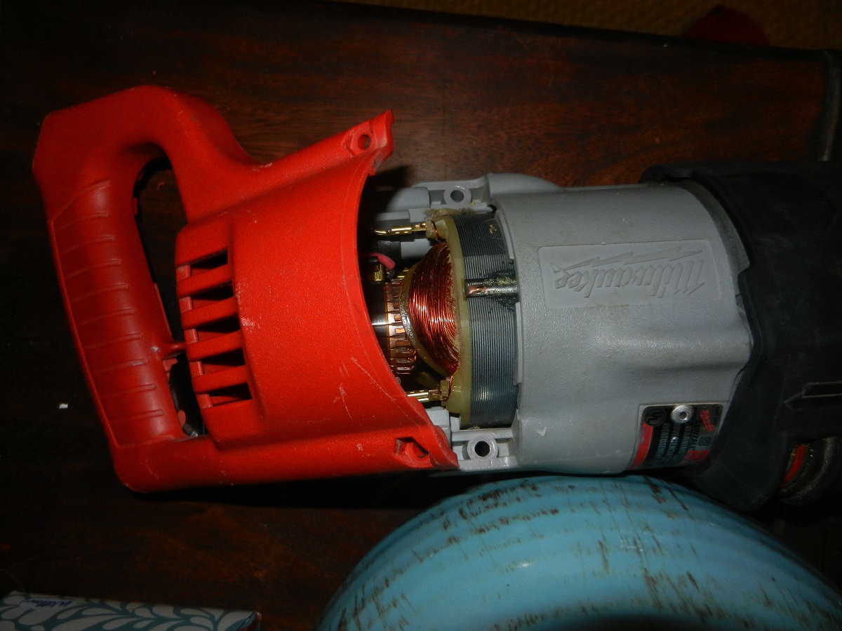

Unplugged it and took it apart to inspect the brushes, they look 100% fine. Took handle off and noticed the bluing on the coils.
Don't know what caused it but this is evidently where my issue was.
So, your thoughts?
Saw is toast, pitch it and buy a new one?
Saw is worth fixing, ship it back to Milwaukee?
(I only paid $100 for it as I bought it at a pawn shop and it was PRISTINE with the box, never had an issue until this)

Looks like a nice saw except for the fire think. It looks like the winding got fried. Not counting parts it would probably cost $50 to fix, maybe more.
I would chuck it and get a new one and not think about it anymore.

Just tried something.
Plugged it in and turned it on.
Whenever you have a motor, you can see little sparks where the brushes rub on the stator/armature?
This does that too but, when I pull the trigger all the way, the sparks get MUCH larger and that seems to be a visual description of the problem.

It sounds like the commutator is coated (corroded) and the brushes are not making good contact. If you can get to it take some fine sandpaper and rub clean the surface of the commutator. Also verify the brushes are in straight and have a good contact surface. This is something that can happen from lack of use or possible cracked brush if it was dropped or something.

Creamers suggestion could fix it - and that could be all that is needed, but
My guess is that at least one set of windings is shorted, the commutator contacts for each winding are at 180 degrees to each other.
A resistance test of each set of contacts will probably reveal at least one pair with a much lower resistance- Thus the blueing of the armature windings, and the sparks that fly every time that pair of commutator contacts line up with the carbon brushes and a large in rush of current flows.
If you send it in and a new armature is installed it may well be as good as new. jmo
