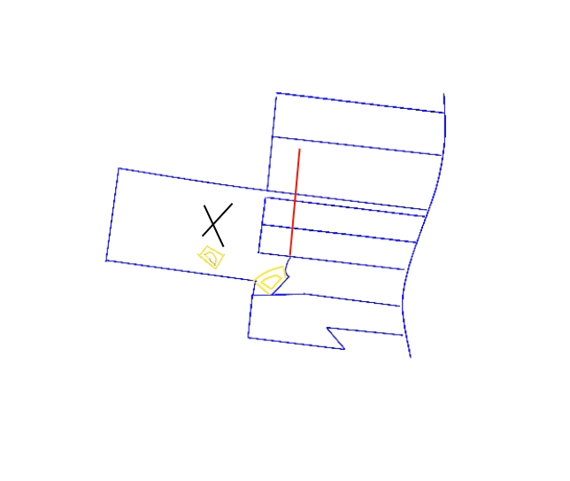

I have attached a rough idea of my plat. The black X is about where the house and garage will go. The red line is roughly how the creek runs.

Well, I found my notes from the electric company. It looks like we would have to dig the trench for the underground line and it is still $15 a foot. I can't hardly swing that. Wish I could, maybe I will fall into some wealth soon.
I have had several people mention using a well. How realistic of an option is this? Any thoughts on the cost versus my 1600' water line?
mn..your elect company is real expensive. were $10/ft if they do everything...its like 5-6 if we provide trench and backfill
