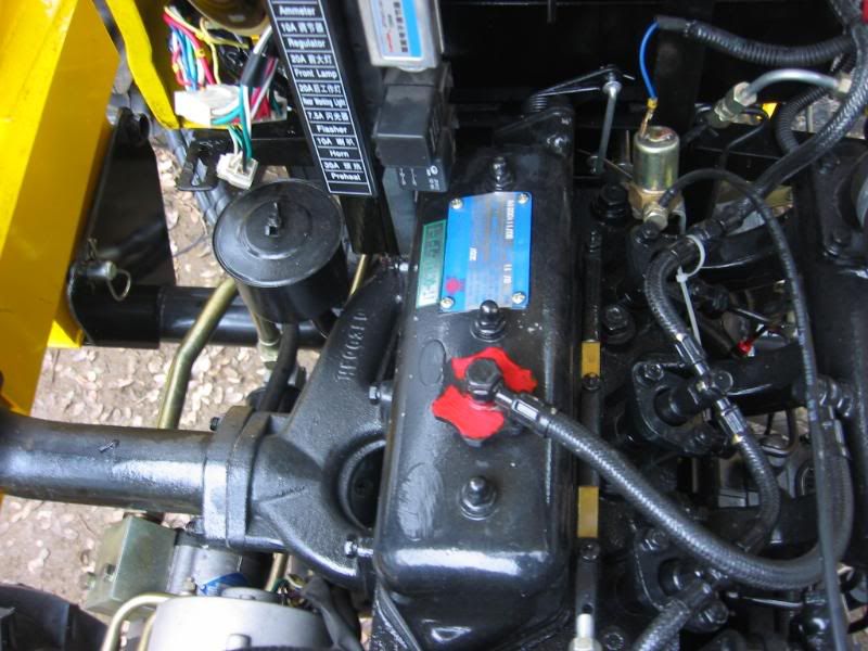

I have another question about this engine.
What is this sensor for and what does it do? Is it the EGR or something?

Hey Rob,
When we were chating the other day ........... I asked about Flame Start.
That is what that is. I like the idea !!
Put a test like on that solenoid and set if it lights up when the key is held in the glow plug position or while cranking. ??
It's not a sensor, it's an intake manifold pre-heater.

The "flame starts" I have seen all had only one wire. apparently the fuel valve is also controlled by the heating element, probably using different metals with different expansion rates.... clever device however it works!
/ My new Jinma #127

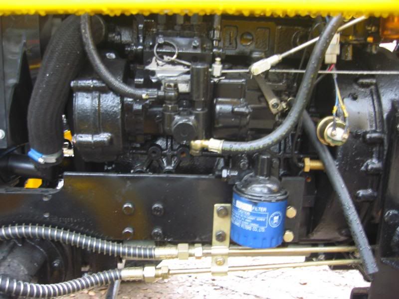

The Thermo-Start system that pre-heated my Yanmar was silent, I wouldn't be terribly concerned if yours turns out to be "poofless". The 1st photo clearly shows a red wire feeding a presumed switchable 12v to the heating element, and a silver-colored fuel supply line feeding the heater. By itself, the photo suggests a one-wire gravity fed system, typically supplied by the fuel return loop.
But that 2nd photo now generates some questions of my own. At first glance, I thought that brass-colored thing was your EGR valve, which - if true - would have no relationship to the manifold heater.
-Does the other end of the silver fuel feed actually connect to that brass colored thing? -
-Where is the other end of the blue wire that is connected to the brass colored thing?-
-Is that black plastic line going into the brass colored thing carrying fuel?-
-If so, from where?-
//greg//

All good questions and I can't answer where those wires or tubes go.
I'll have to take more photos next visit up and really find out where all the connections go. It will be interesting for others who have this engine to know.
On the other hand, I have one of those manifold preheaters on my Kama 554.
However, it does not have glow plugs. so when you you turn the key counter clockwise you activate that manifold preheater. It works and I can definitely hear it. It also shows a draw down on the amp meter in the preheat ignition position.
On the Jinma, it has glow plugs and when you turn the key to the preheat it warms them up.
Now that I think about it, that Jinma came WITHOUT the glow plugs hooked up, you remember? We had to add a wire and fuse for them as shown in a previous post.
I wonder if the preheat on the switch was for that manifold preheater then? I don't think so...
If it was, it didn't work very good at all because I remember there was no draw down on the amp meter in the pre heat position plus the tractor wouldn't start!
It fire right up after we hooked up the glow plugs and preheated that way.

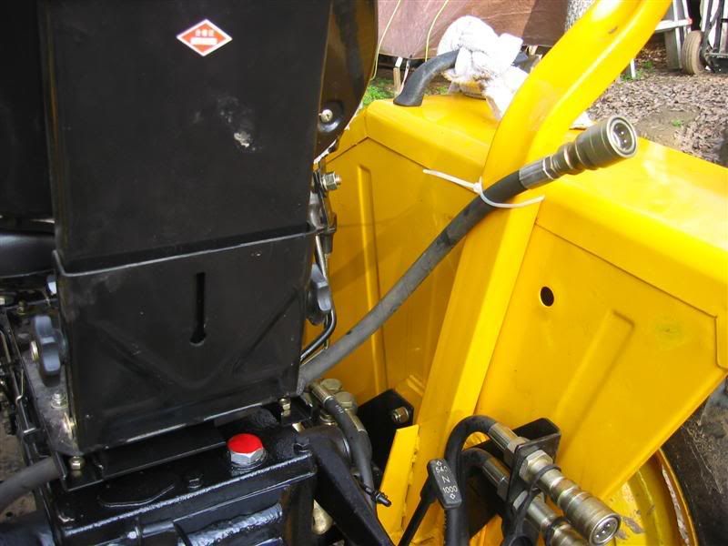

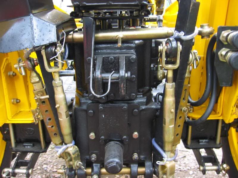

Loretta's 284 is really coming together with all the work she's been doing on it. I thought you might like see some of the new hydraulic valves she's been working on such as what you saw in her grapple thread and the replacement FEL valve thread the new valves she got. Here they are all together. First the new FEL valve with new Scorpion joystick handle and also the electric solenoid grapple valves.
We also added a pressure relief valve right after the pump along with a pressure gauge and return to sump line. Right now with the loader on, the FEL valve is next in line. If the loader is removed, there are QC's to hook up to the remaining valves on the tractor. Notice my favorite "T" shirt?
/ My new Jinma #131
The new FEL valve uses it's power beyond to feed the next valve in line. This one is single acting single spool valve to run her dump trailer. We made all the brackets and did all the mounting at camp.
Here it is all plumbed up with a QC. It also has a separate return to sump line and a power beyond to feed the next valve in line. The high pressure into this valve has a quick connect so when the loader valve goes off with the loader, this valve can be connected to the pump after the pressure relief valve and gauge. Thereby running all the remaining valves on the tractor.
/ My new Jinma #132
The next valve in line is the OLD Jinma AL-20 valve. We used it to operate her upcoming hydraulic side link cylinders (not yet installed). That valve then feeds the electric solenoid valve for the grapples, since it has no power beyond. But it was feeding the 3pt valve before ... so what?
That's it with the bent joystick handle.
You may have noticed that the bracket we made for it also includes the rear remotes bulkhead all in one bracket. Pretty cool huh?
Additionally, Loretta didn't like the fact that the stock 3pt valve handle was so close to the rear remote handle and the other handles all clustered up on the right had side. So we moved the rear remote valve away and up from the 3pt valve handle. Now it sits between the ZL-20 valve and the 3pt handle. The locations were all figured out so when she turned to operate them, she could reach the handles with comfort.
Here is a pretty good shot of the new rear remote valve location up off the floor board and back a ways.
One thing we had to do to avoid chasing down all the metric fittings, is that we kept the relation between the OLD ZL-20 loader valve and the rear remote valve and also the 3pt valve the same. In other words, because of the banjo fittings they used, and they were different sizes for work ports and power in and out, we had to keep the same valves feeding each other as they were. This presented a little problem due to the hose length. We had to make new brackets, but it all worked out pretty good after all.
You also probably saw that we have the ZL-20 valve work ports blocked off for now. We will use the old (but still brand new) hoses and fittings to feed the side link cylinders when we get them. The ends of those hoses used to fit the loader steel lines, but we'll get the ends cut off or an adapter so they will fit the hydraulic cylinders.
So besides the Grapple installation, that's what else we've been working on.

/ My new Jinma #139
In post #132 you saw where I used the stock fel valve for Loretta's future rear remotes or side links.
Well, that valve has been screwing up. During normal use of the tractor, we have to "wiggle" the joystick a little because for some reason, it was restricting flow through the hydraulic system. We could see the pressure spike on the gauge and then reduce after wiggling that joystick. This last weekend after spiking the pressure up, wiggling the joystick would not reduce the pressure at all. In fact, it would not return to center. It was like the spring loaded return to center feature was broken in one direction. Like it was doing nothing to change the position of the spools in the valves.
I had to take that valve OUT of the loop completely, which cured the spike problem. Now the hydraulic system works good again. Also, her original rear remote valve that came with the tractor is working good too. You remember it was not working well, even after adjusting the pressure relief setting on it.
What do you suppose happened to the original fel valve to make it malfunction like that? It was not hooked up to the side links yet, and fluid was only flowing through it until I had time to install the side links.
/ My new Jinma #140
My guess is some debris is stuck in there somewhere which will warrant a tear down to take a look.
