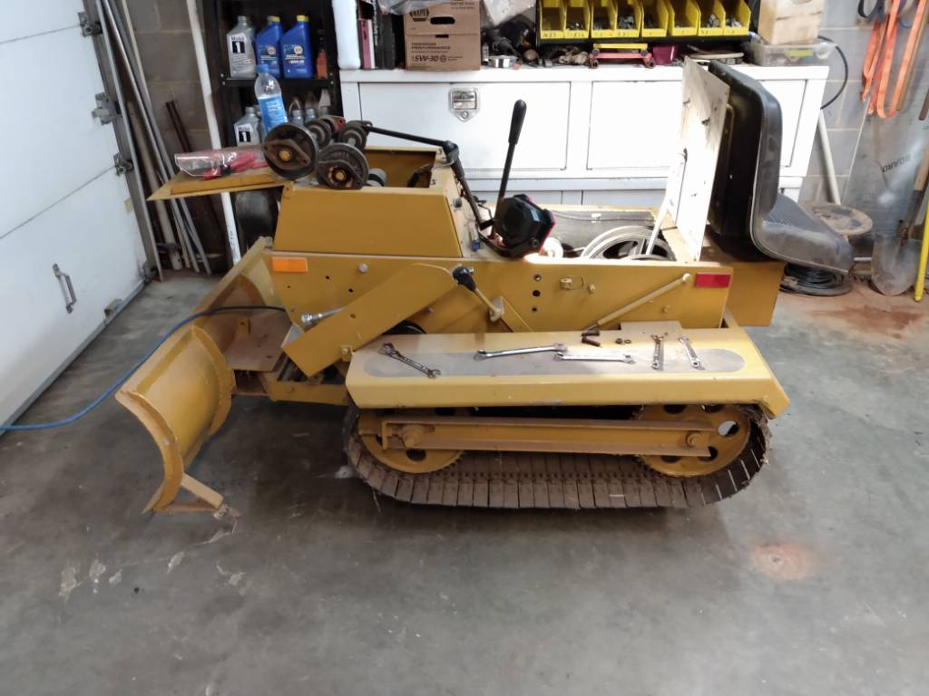

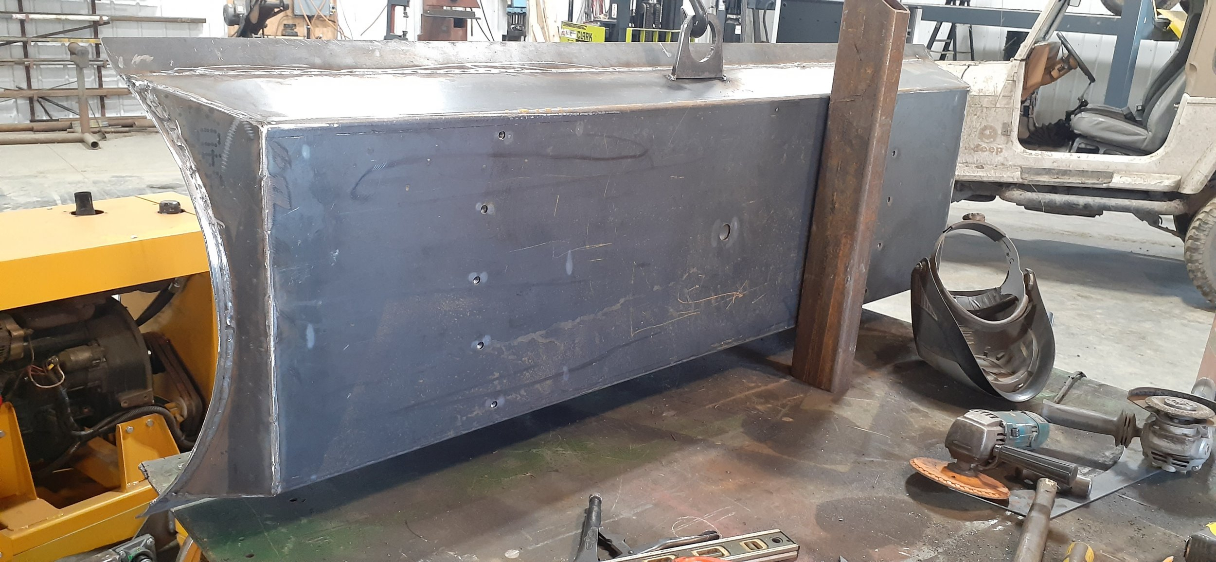

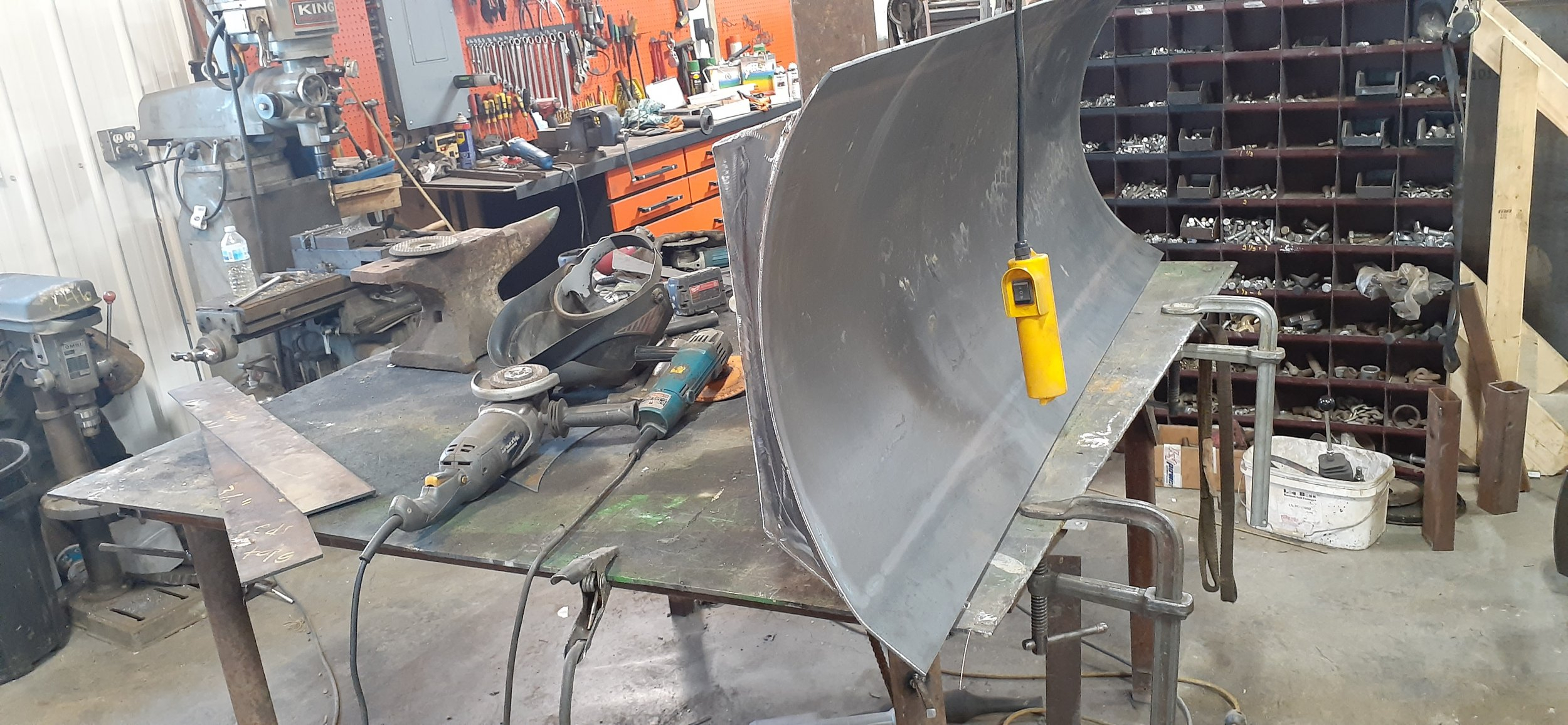

Here is my latest project. Spent most of a year at it. Has been very satisfying. Engine is 3 cyl. Kubota 20 hp. Drive is fully hydrostatic from a wrecked Massey swather I had given to me. Drive motors are 29 cu.in orbit motors from Princess auto. Brand new mini excavator tracks the single largest expense in the project. Didn't keep track of total time or expense but must be 1500 hrs and 5 or 6 thousand dollars by now. Any parts that could possibly be plasma cut I did on my 4x8 ft. Cnc plasma table including front idlers, rear drive sprockets and track rollers. Total weight might be 1200 lbs. Just guessing though. Top speed is close to 5 mph. Planning a 6 way dozer for it yet to. I'm very new at posting this kind of a thing so please bear with me.View attachment 692193View attachment 692194View attachment 692195View attachment 692197
