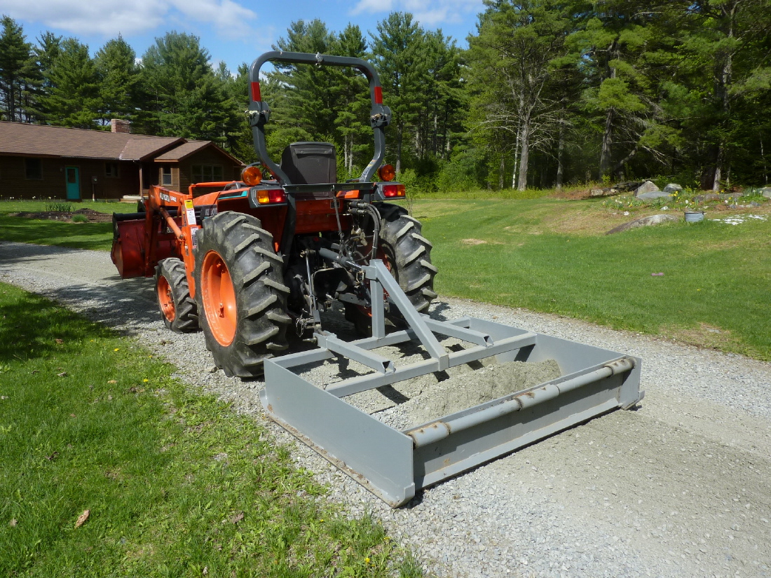

Five years ago I bought a brand new Land Pride, land plane grading scraper( GS2584 ). I have a mile long gravel driveway that turns to concrete in the summer. The LPGS would just bounce down the driveway - doing a whole lot of nothing.
Well - today it was time to grade out a muddy, rutted, gouged 200 foot section of my driveway. It was dry on top but still had moisture in the gravel/dirt below. Previous years I used my heavy Rhino rear blade. One hour and less than satisfactory results. It just pulled dry gravel/dirt on top of rock hard gravel - no bonding what-so-ever.
This year I tried a different approach. LPGS with all seven scarifiers DOWN. Set about 1 1/2" to 2" below the two following blades.
My LORD - what a pleasant difference. It scarified the top 2" and the two following blades smoothed it out. It's now the the smoothest section on my driveway-smooth as a babies butt. Now the top is smooth and bonded with the gravel below.
Tomorrow I'll go down with the Taco Wagon and pack it down.
For those with rock hard driveways and are considering a LPGS. Get the scarifiers also. You too will be pleasantly surprised.
BTW - good that the Kubota weighs 10,100# and is 4WD. The LPGS with scarifiers down is a substantial pull.

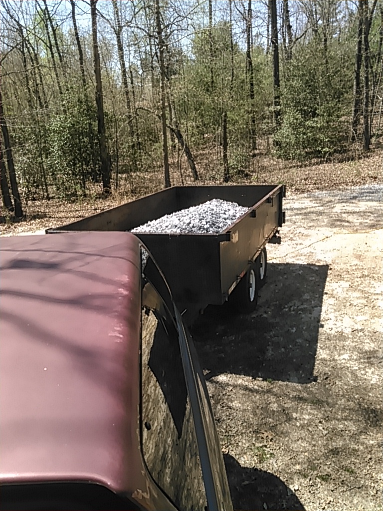

OOSIK, You need some of this. 7000 lbs I picked up last week for part of my drive.

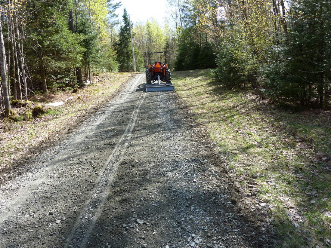

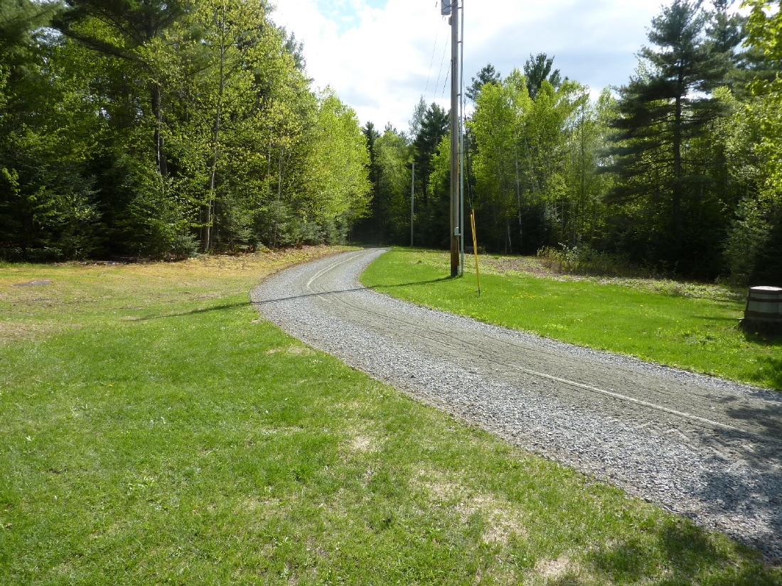

If I understand your question: Can you use a LPGS half the with of a crowned road to maintain the road w/o destroying the crown? The answer is yes - that is what I have done for the past 10 years with my 5' wide LPGS. We have deep frosts in the winter and spring mud seasons here which is hard on roads so I do have to recrown once in a while - every 3 years or so it seems but for routine maintenance the LPGS is all I need. I even run it down the center to remove the middle berm that is left. But when I do I lengthen the top link which raises the the front so the that blades just barely kiss off the berm. My blades a straight rather than angled so that is much easier for me to do.
gg
gg
You understood my question correctly. I built the crown by using my 4ft weighted disc (my scarifiers) and my 5 ft rear blade tipped via tilting the 3pt arms. If and when I buy a land plane, I would seriously look at one half the width of my drive. That would take out the bumps the drive has. Thanks, Jon

I've had zero issues creating a crown on my drive, or creating 'half a crown' around the pole barn for drainage. Granted it could be my land plane weighs around 800# with the scarifiers in it and has 1.5" of tilt adjustment in the LPGS shoes. Add in the 6" or so I can adjust the 3 point tilt on the Kioti.
My box blade does a great job at moving materials from point a to point b. And for back filling trenches (septic finger runs & water/electrical trenches from house to barn.) But the LPGS did a remarkable job at actually leveling everything out with regards to smoothness.
As for your driveway maintenance comment, the LPGS is great at that. Can literally just drop it and drag. Couple passes down each side and all the potholes are gone, low spots are filled in. Does a great job on the gravel road I live on as well. Let's me fix it before the county comes out and turns it into a mudhole.
