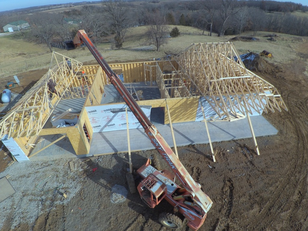

When I built my house I rented a telehandler for the early stage work. The framers and roofers used it and then I used it for installing windows with the work platform it came with. It had selectable 3 steering modes. 1. Basic front wheels steer only 2. All wheel steering where the back wheels turned opposite of the front ones for tighter tuns and the real gem #3. Crab steering. You had to have wheels straight ahead to change modes, but you could get right up next to a wall if you wanted to, pop it into crab steering and both front and rear wheels would turn the same way so you could get away from a wall that was only a few inches next to you. That was a lifesaver in a few situations. Being that it was all hydraulic control/drive/steer, it was fairly easy to implement vs anything mechanical.
Just thought it was interesting...
My Builders have one. They used it to hang my trusses as well as many other jobs. They could move the end of the jib an inch if needed simply by turning the steering wheel sitting still. I was impressed.
